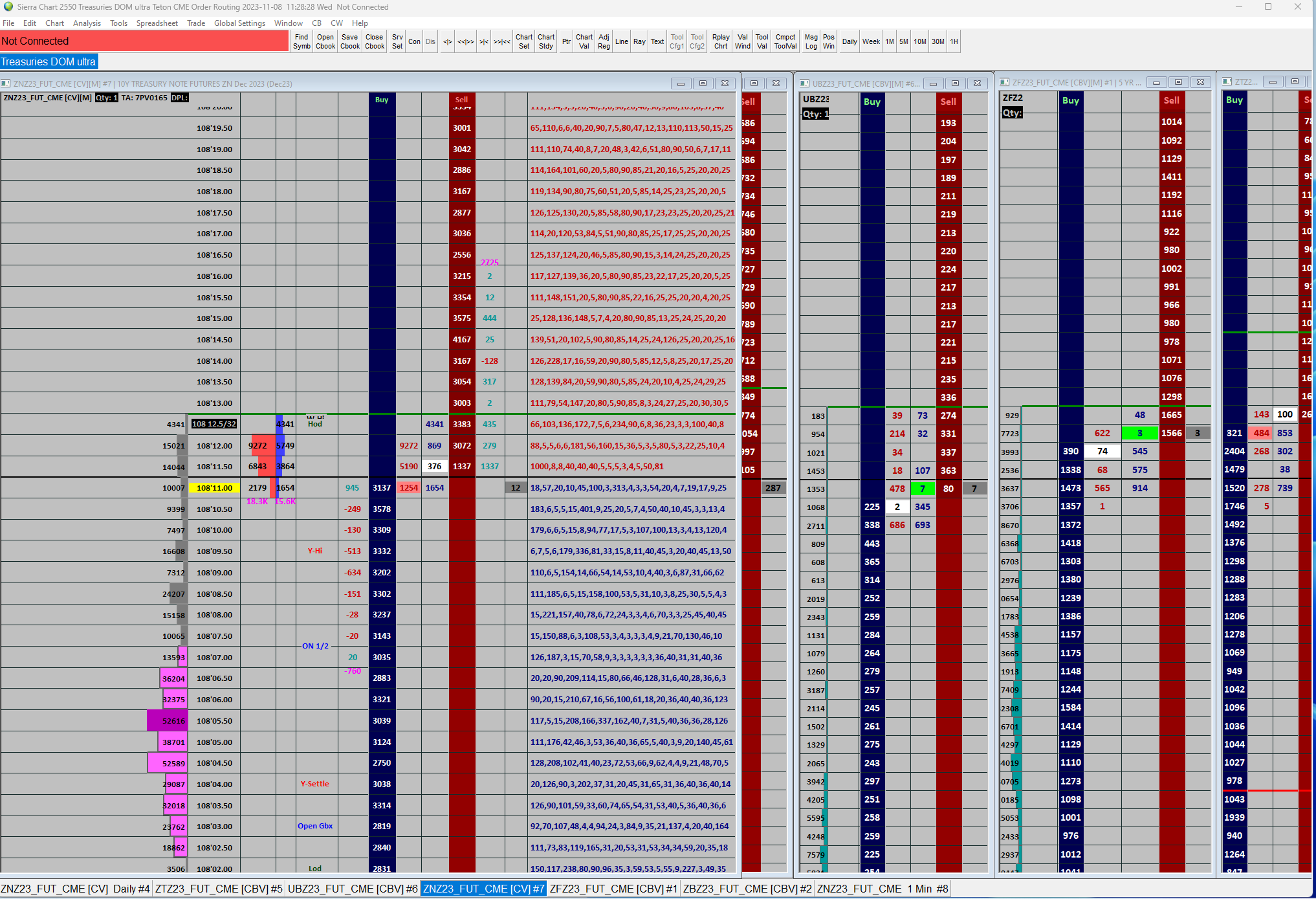

Steve Leon - Posts: 319
1) i am having consistent results in the volume by price study on the computer using multiple instances
2) The intraday storage tick unit is 1 tick on both computers
3) I did notice there was about a 10 second differnce in the clock header between the two computers although i dont believe this accounts for the differences i am seeing (as they occurred at earlier times
I am sending a screenshot of the the chart with ZNZ23 on the new computer and old computer.
Thank you
imageZNZ23 new computer.png / V - Attached On 2023-11-08 16:48:07 UTC - Size: 350.02 KB - 222 views
imageZNZ23 old computer.PNG / V - Attached On 2023-11-08 16:49:34 UTC - Size: 195.64 KB - 220 views
