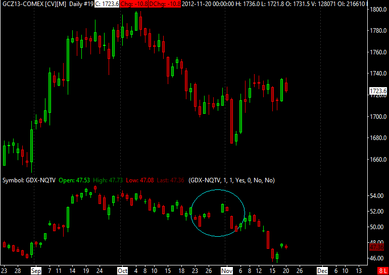

"In the add additional symbol" study, I have the "fill blanks with last value" input set to "Yes". However, I am still getting blank periods on the chart for that study, which are NOT filled with the last value. If I scroll back to make those blank areas the last visible bars on the chart... the "last" value on the price scale for that symbol will disappear. I am using studies that reference both of these charts and this causes those studies to break. I searched past support posts for clues but was unsuccessful. I have an image attached. https://www.sierrachart.com/image.php?Image=1698087316548.png |

That particular Input, "fill blanks with last value", does not affect historical daily charts. We have to add support for that. We will work on this.

Update to the latest release and see if this is resolved for you. Instructions: Software Download: Fast Update Sierra Chart Support - Engineering Level Your definitive source for support. Other responses are from users. Try to keep your questions brief and to the point. Be aware of support policy: https://www.sierrachart.com/index.php?l=PostingInformation.php#GeneralInformation For the most reliable, advanced, and zero cost futures order routing, use the Teton service: Sierra Chart Teton Futures Order Routing |
| [2023-10-25 12:02:23] |
| adam czuk - Posts: 28 |
I did that just now but unfortunately there was no change.
| [2023-10-25 17:23:47] |
| Sierra_Chart Engineering - Posts: 25370 |
We will check on this.
