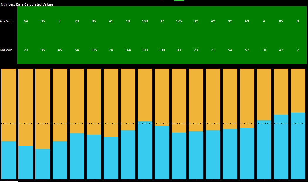

I would like to know if it is possible to have the study cited by integrating a number of given sliding periods.
Let me explain.
Let's say I have a chart in 5 second candles, I would like to have the bid vs ask volume which displays the sum of the bids vs ask volume of 10 candles including the current one (i.e. between 40 and 50 seconds).
Then, when the candle closes and the new candle begins, I want the bid vs ask volume to shift by 1 candle in order to always take into account only 10 candles including the current ones.
Attaches a probably more explicit capture.
Thanks a lot for your help !
imageCapture Study Volume bid vs Volume Ask - Sliding volume.png / V - Attached On 2023-10-08 17:04:03 UTC - Size: 47.27 KB - 508 views

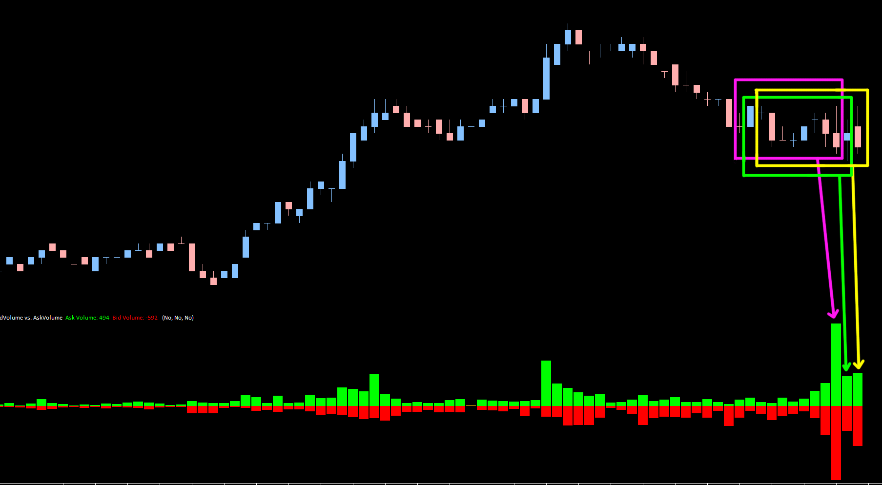

[2023-10-16 21:59:46]
User440951 - Posts: 54
Thank you for this feedback!
It helped me a lot and guided me in addition to some YouTube videos on spreadsheet studies. I was able to achieve my Bid vs Ask volume on 5 sliding bars via a percentage.
Attached the capture.
imageBid vs Ask volume 5 bars.PNG / V - Attached On 2023-10-16 21:59:41 UTC - Size: 37.85 KB - 324 views
