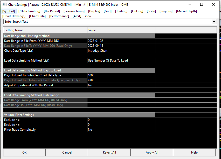

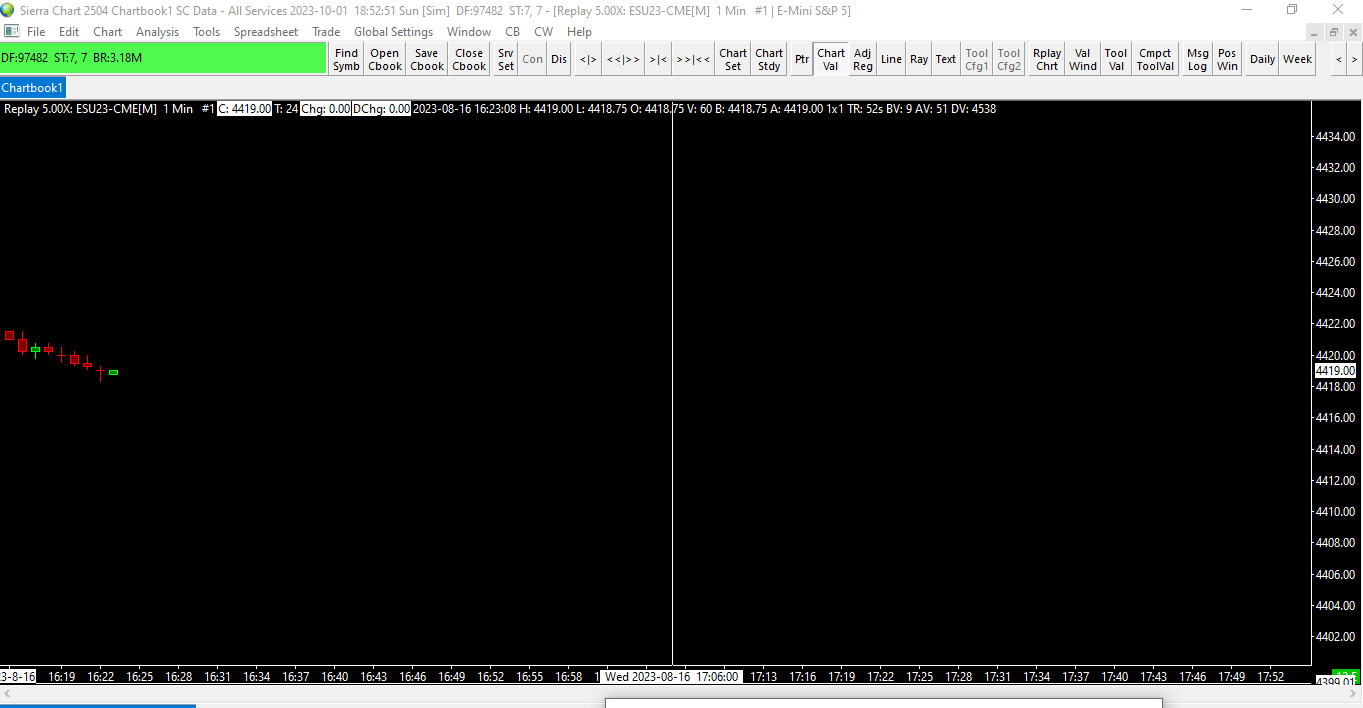

I am having troubles creating a new intraday chart to allow me to replay back dates (eg 25-01-2023) using a 1 min charts.
When I first open it it seems ok when I change it to 1 Min chart as per attached image. Next I go to the replay button back to the 25-01-23 and then I can't see the chart at all from the 25-01-23. It goes to 16-08-23 for some reason (see second image).

John - SC Support - Posts: 48446
You are trying to start a Replay further back than what you have data loaded in the chart. You can only run a replay on the actual data that is in the chart.
Refer to the following to load more data into the chart:
Loading More Or Less Data into an Intraday Chart

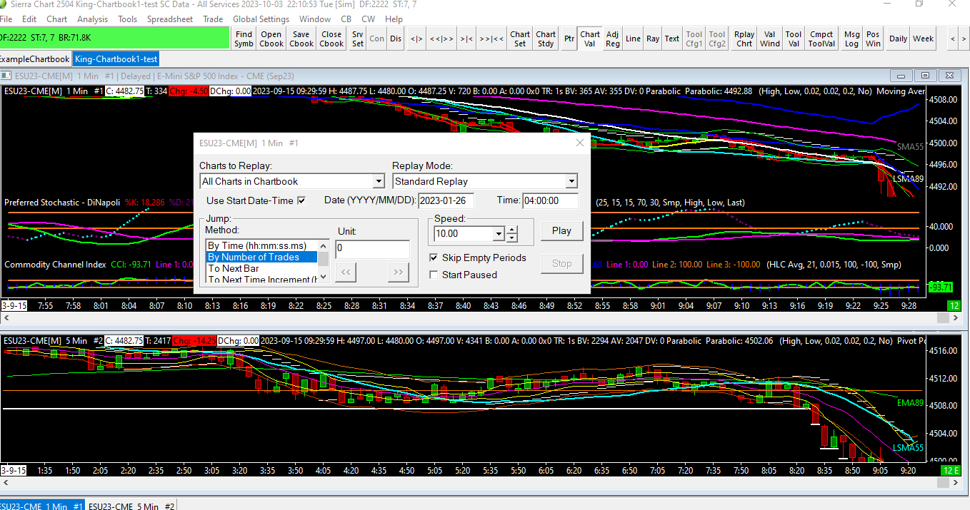

Hi John,
I have done that but new issues arise. It goes back to the date now, but the chart candles disappear. Very strange and unable to replay charts, either on single chart or multiple charts as per Image.
Please see both images.
Not sure what else could be the issue?
Btw on another Chartbook, I can rewind without issues but in this chartbook I can't rewind.
Sergio

Sergio Anacleto - Posts: 9
Hi John,
This is what I have selected in the replay. I have changed different dates and now its working only from 27-06-23, any further back I have the same issues.
I have always the option Skip empty periods selected for single or all charts in chartbooks.
Initially I created the templates under a working chartbook (ie no issues with replay backs), and that works perfectly in either chart time period (1 Min or 5 Min) but because I need both time charts under one screen I created two separate intraday charts anf then created a chartbook.
I attach this new chartbook for your review please to ensure I can replay back to the beginning of 2023.
Cheers

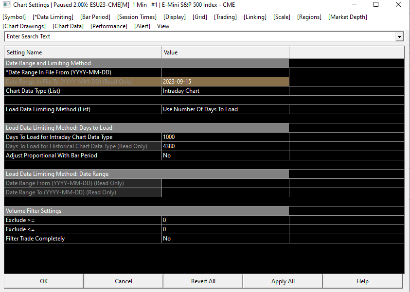

I can only remove the first row of the start date time. It does not allow me to remove the second row (end date). When I press OK and go back into the settings the first date is back there again. This can't be that difficult.
Can you please advise if you can make it work using the chartbook I sent you?
Cheers
Sergio
imageDate range.PNG / V - Attached On 2023-10-09 21:24:46 UTC - Size: 29.77 KB - 242 views
