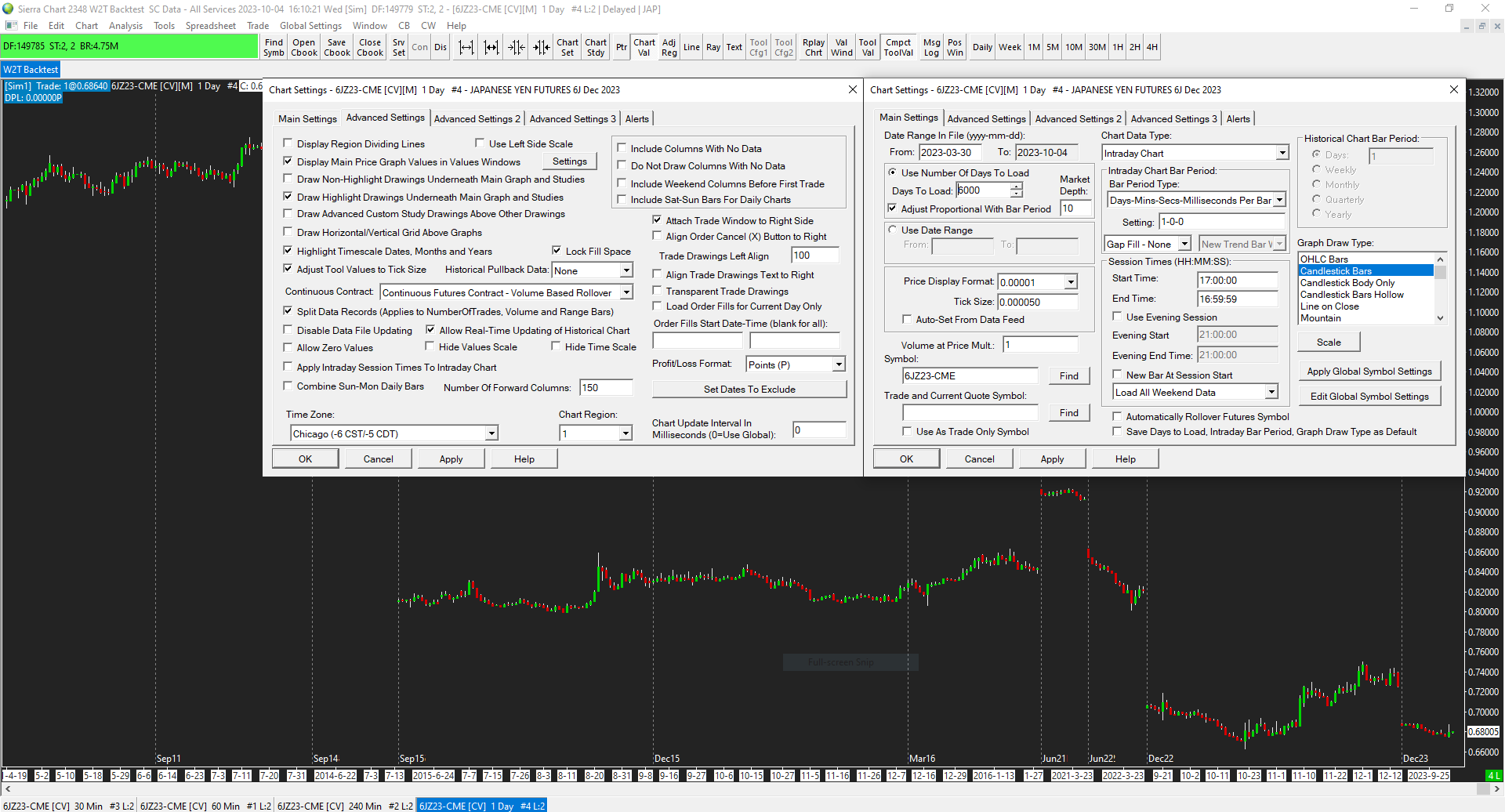

RHudson85 - Posts: 33
Continuous futures contract - Volume based rollover
I have attached a screenshot of things that will hopefully help in being able to assist.
Thank you.
imageCapture.PNG / V - Attached On 2023-10-04 16:17:24 UTC - Size: 179.43 KB - 270 views
[2023-10-04 16:36:17]
First thing to do is to follow the instructions here:
And re-download data for all contract months. All of them.
And you must also update Sierra Chart as explained in the post below.
Date Time Of Last Edit: 2023-10-04 17:03:17
