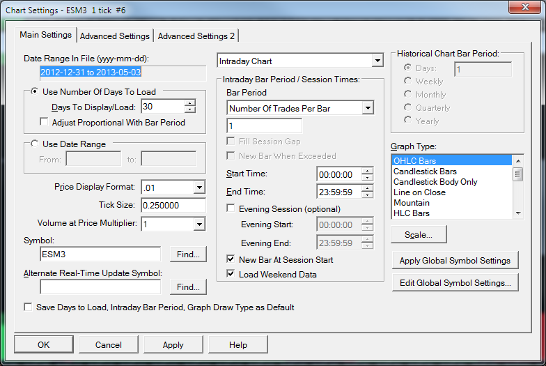

I don't seem to be getting that to work correctly.
I did 1 trade per bar, Volume Filter Exclude <= 99 (so it should show only those that are 100 or more). The result was a bunch of bars with volume 0 and some that have volume from 1-10. I would expect to only see bars of trades with volume >= 100.
I thought maybe the volume filters got reversed so I tried the other one set to >= 99 and I saw a different result that was also the wrong thing. See attachments. The first 2 are the settings and the 3rd is the result (many bars showing less than 10 volume even though the filter is set to exclude <= 99).

[2013-05-04 00:41:10]
The documentation says you must have tick by tick data. Clearly you do not. Please follow the documentation here:
http://www.sierrachart.com/index.php?l=doc/doc_TickbyTickDataConfiguration.php

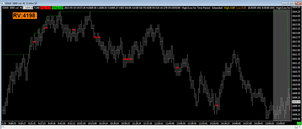

It's now showing a lot of empty bars and some which have the specified volume (see screenshot).
Can this data be imported to another chart? I'd like to have something that looks like the photoshopped image where the red bars represent trades over a certain volume.

[2013-05-04 02:13:58]
To overlay one chart with a different timeframe per bar on to another, use the Study/Price Overlay study:
http://www.sierrachart.com/index.php?l=doc/helpdetails28.html
Not sure though if this is what you are looking for.
There is no problem with using tick by tick data for everything else.
The problem is that the filtering does not actually filter the trades, only the volume numbers themselves.
