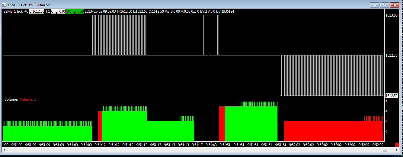

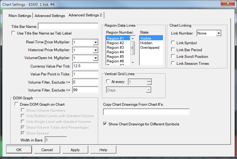

I don't seem to be getting that to work correctly.
I did 1 trade per bar, Volume Filter Exclude <= 99 (so it should show only those that are 100 or more). The result was a bunch of bars with volume 0 and some that have volume from 1-10. I would expect to only see bars of trades with volume >= 100.
I thought maybe the volume filters got reversed so I tried the other one set to >= 99 and I saw a different result that was also the wrong thing. See attachments. The first 2 are the settings and the 3rd is the result (many bars showing less than 10 volume even though the filter is set to exclude <= 99).
Assuming I get this chart to work, is there a way to import this onto another chart, such as a 10,000 volume ES chart, so I can see where on the 10,000 volume candles the big trades are taking place? That's my end goal.
