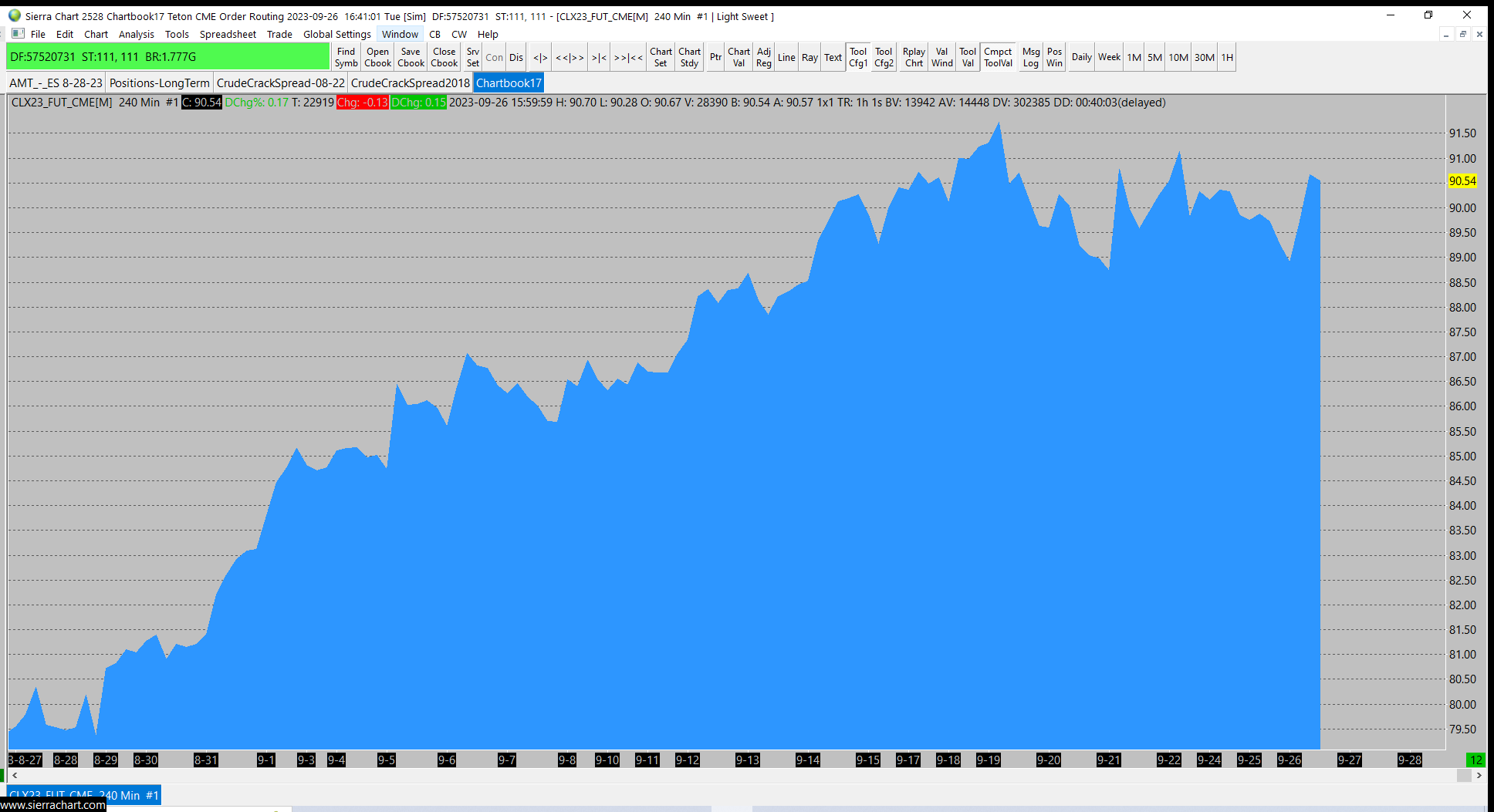

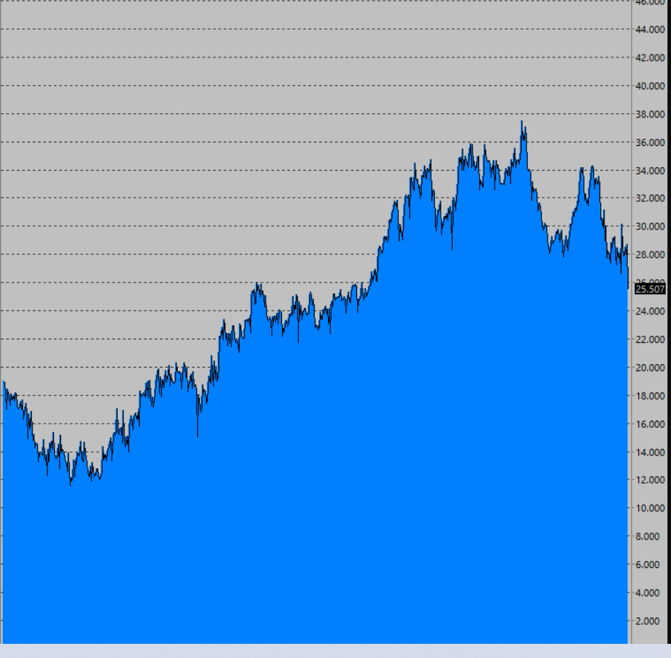

How do you change outline Mountain Chart type to a different color than the fill color.
change this chart image- https://www.sierrachart.com/image.php?Image=1695764462195.png
to attached chart image
imageOutline 9-26-23.PNG / V - Attached On 2023-09-26 21:44:52 UTC - Size: 98.39 KB - 260 views

To start with, the Graphics Setting to change the color of the Mountain draw style is "Line on Close / Line on Open / Mountain". Refer to the following:
Graphics Settings: Line On Close / Line On Open / Mountain
In order to get a line across the top in a darker color, you would need to add a study that draws a line on the Close and set the color of that line to be slightly darker than than Mountain. The easiest way to do this is to use the "Study Subgraph Reference" study and set the Input for "Study Subgraph to Reference" to the "Last" (by default the study is set to be Based On the Main Price Graph, so you do not need to change that). Refer to the following:
Then change the Color and Width/Size of the subgraph to be what you want. Refer to the following:
Chart Studies: Subgraphs Tab >> Color
Chart Studies: Subgraphs Tab >> Line Width
