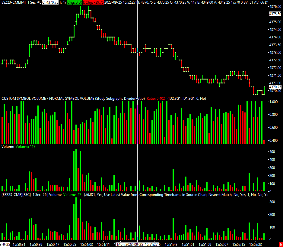

I'm working to have a chart with 1 second data via Custom Calculated Symbols. I have various symbols all aimed at having a chart of the ES: .5*{ESZ23-CME} +.5*{ESZ23-CME}, {ESZ23-CME}/2+{ESZ23-CME}/2, 1*{ESZ23-CME}, {ESZ23-CME}, 6*{ESZ23-CME}-5*{ESZ23-CME}, all of which chart Region 1 fine with 30 second bars. The problem is that all of them show different values for the Volume study and none match the volume of a normal chart of the ES. That makes use of any volume based bars or studies moot. If any symbol was to be correct I would expect that it would be {ESZ23-CME} but volume is way different than the usual ES chart with exact same settings. If I pull up a new chart with one of the custom symbols it does not initially display [FSE] but when I add the volume study [FSE] displays and after removing the volume study the chart still displays [FSE]. The docs seem to indicate that custom symbol volume should be useful but I can't see how at this point. |

| maxpi - Posts: 194 |
Realtime volumes of {ESZ23-CME} look much less synthetic than the historical volumes I got over the weekend but they do not match the volumes of ESZ23-CME. The volumes of ESZ23-CME seem to be consistently larger than the volumes of the custom symbol but the scaling is not consistent

| [2023-09-25 20:53:01] |
compare volumes of 1 second charts, one ESZ23-CME and one {ESZ23-CME} you will see that the custom chart volume is always <= to the standard chart volume, never exceeds it. https://www.sierrachart.com/image.php?Image=1695735229916.png Date Time Of Last Edit: 2023-09-26 13:42:23

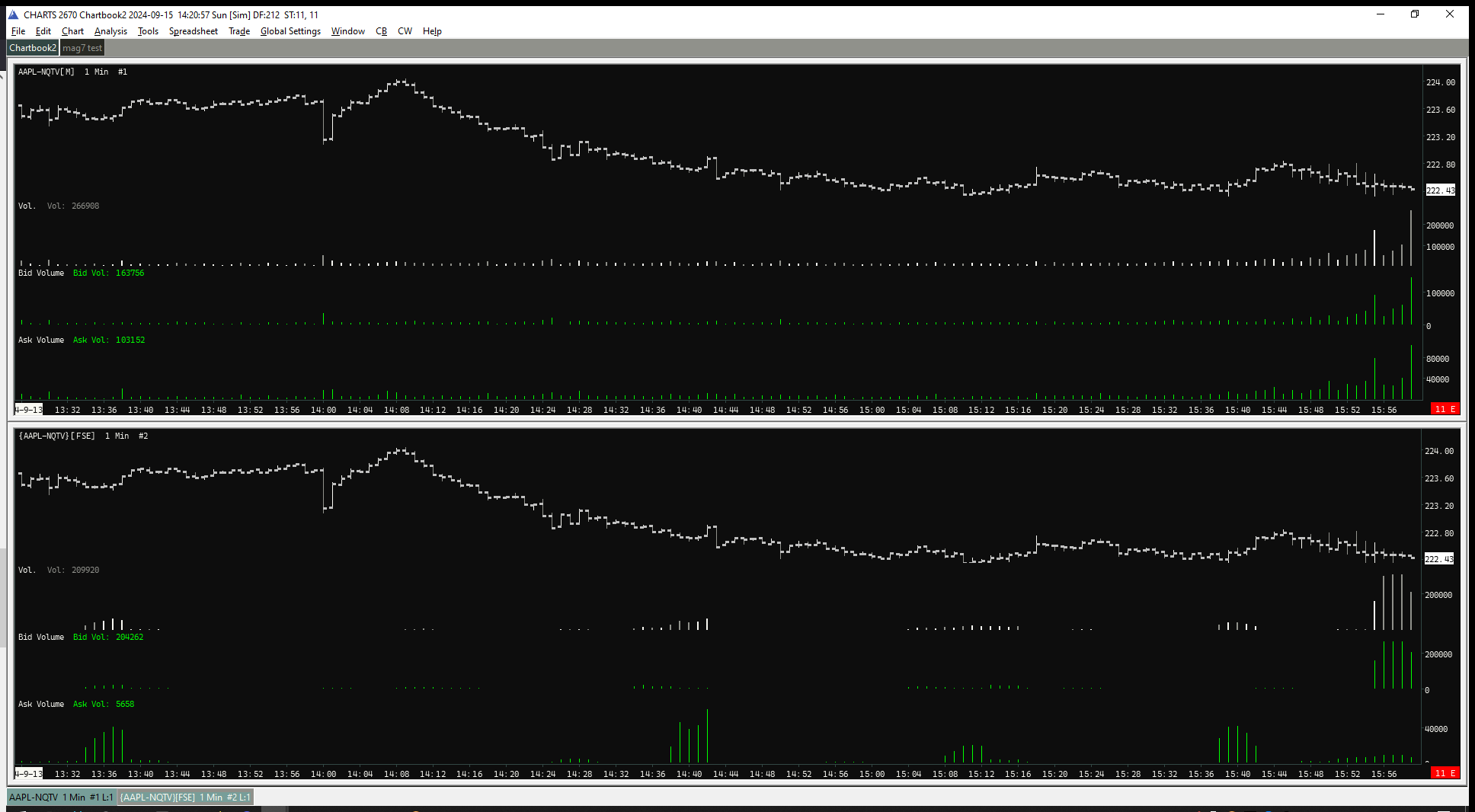

| User150671 - Posts: 80 |
Bumping this as I am having the same issue. Created a custom symbol of (AAPL-NQTV} going of the documentation here: Custom Calculated Symbols Results in very different volume and bid/ask volume fields see below: https://www.sierrachart.com/image.php?Image=1726424458973.png Am I doing something wrong here? |
Testing this with a live chart on multiple symbols against a 'Sum Charts from List' study using the same assets, price is fine but the volume is way off. The Formula chart has FSC at the end, so in theory should be calculating correctly. |
