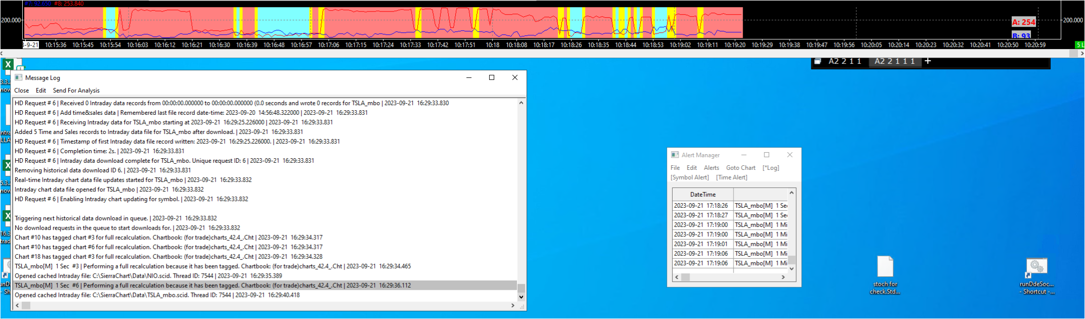

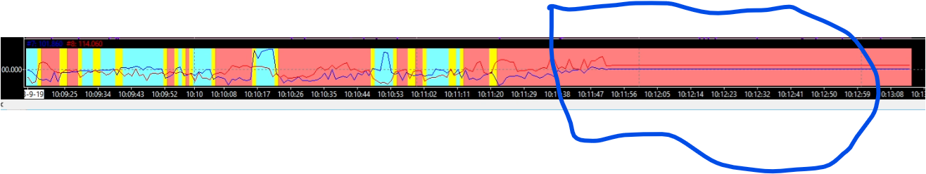

hello,
i'm using level2 (with the new charts _MBO)
every day in live trade, after approximately 40 min (10:10 am N.Y,usa)
the spreadsheet study which connect to level2 "disconnect" and reconnected after few seconds (even after a 1 min)...
how can i fix it ?
(i have lots of studies which work in the same chart,in 1 sec chart and i have a theory
that the data which records after 40 min is high and because of it, the level2 starting to reconnect and disconnected,
other theory is there is "problem" with the new charts _MBO)
any way, i hope you have solution for me,
regards.
Date Time Of Last Edit: 2023-09-20 07:59:25
image1.png / V - Attached On 2023-09-20 07:46:15 UTC - Size: 126.13 KB - 308 views
image2.png / V - Attached On 2023-09-20 07:46:24 UTC - Size: 159.85 KB - 267 views

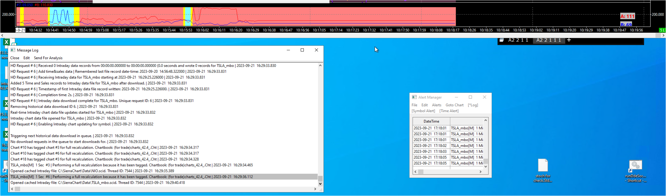

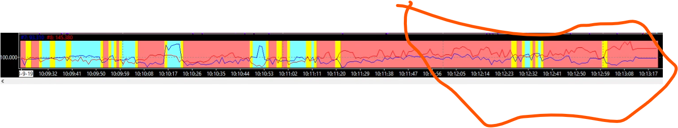

When you make reference to disconnect and reconnect, are you referring to actual data feed disconnects and reconnects that you are observing in the Window >>Message Log?
i'm not observe anything (pic r added,"11" is before,"22" is after)
and again it start(connect/disconnect) at 10:05(ny,usa) (About after 40 min in trade)
Date Time Of Last Edit: 2023-09-21 14:26:42
image11.png / V - Attached On 2023-09-21 14:21:36 UTC - Size: 548 KB - 253 views
image22.png / V - Attached On 2023-09-21 14:21:51 UTC - Size: 565.05 KB - 254 views

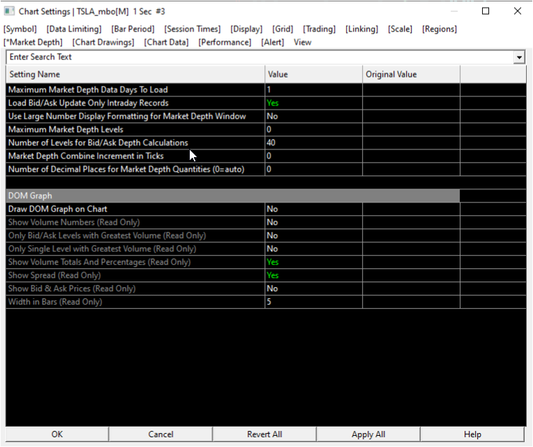

do you have the Market Depth data limited in the number of levels that are displayed or used for calculations? If so, what is it set to?
number of levels for bid/ask depth calculation: 40
