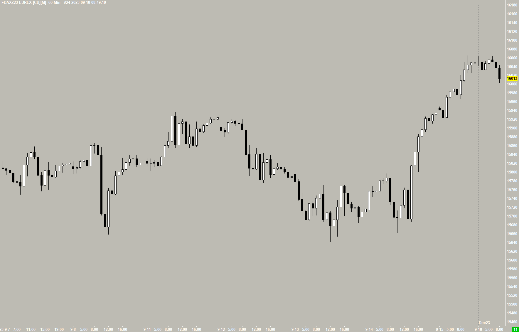

Data is missing since Friday 13:00h to 22:00h.
In FDAX and FESX
I ask for examination.
https://www.sierrachart.com/image.php?Image=1695019767392.png
[2023-09-18 10:56:08]
We are checking on this.
[2023-09-18 11:22:35]
We have thoroughly looked into this. We do not see any issue on the server.
We want you to follow the instructions here to download the missing data:
Date Time Of Last Edit: 2023-09-18 11:22:48

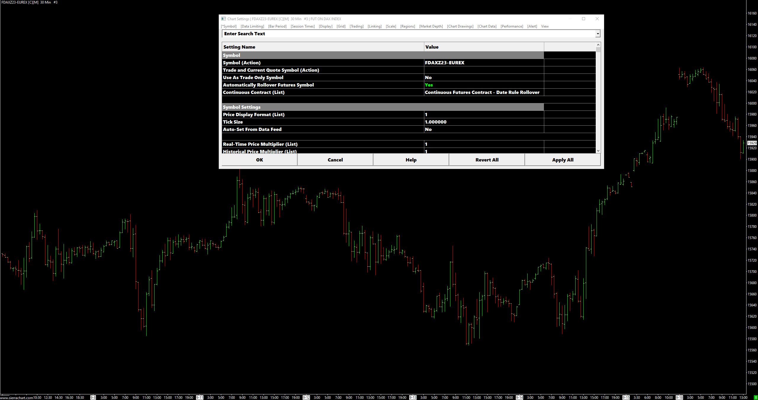

[2023-09-18 12:02:19]
User120666 - Posts: 54
This info does not resolve the issue.
1) Please open a chart with symbol FDAXZ23-EUREX
2) Set the Continuous Contract to: Continuous Futures Contract - Date Rule Rollover
You will see that there is no data from 12pm until the 9pm close on Friday. If instead you do have data between 12pm and 9pm on Friday, with the above settings, please send a screenshot showing otherwise...
Here is a screenshot showing the above settings: https://www.sierrachart.com/image.php?Image=1695038716539.png
- all days showing full data (bottom time scale), except Friday which finishes at 12pm.
Date Time Of Last Edit: 2023-09-18 12:06:38

[2023-09-18 12:48:52]
But what is the long-term solution? Why has this happened this time rolling from September to December, when every other prior rollover has rolled fine on the usual (and correct) Date Rule Rollover settings? No changes have been made since we rolled from June to September (always set to Date Rule Rollover), so what's changed your end this time around?
A stock index future like FDAX should not have to be set to a Volume Based Rollover, so what is going to be done to get the data filled in properly on the normal Date Rule Rollover settings?
You say the chart looks fine for you, but the screenshot you sent is not a chart set to Date Rule Rollover. If you change it to Date Rule Rollover you will see data that finishes at 12pm on Friday: https://www.sierrachart.com/image.php?Image=1695038716539.png
Are you saying that even when you change it to Date Rule Rollover you have complete data showing for Friday?
[2023-09-18 17:19:29]
The reason why you are "missing" data when you have a Date Rule Rollover is that there simply is no data after that time for the U contract on September 15, 2023. And the data then picks up again at the evening start for the following trading day for the Z contract.
[2023-09-18 17:28:26]
But why has this never happened for any other rollover? I've been through several expiries/rollovers now using your Denali feed and every time using the Date Rule Rollover there is complete data for the expiry Friday.
You can check that yourself by looking back at every other expiry Friday (3rd Friday of March, June, September and December), and you'll see complete data for the FULL session, using the exact same 'Date Rule Rollover' settings from my earlier screenshot. Here is an example from the 16th June, which was the latest expiry/rollover before the one last week: https://www.sierrachart.com/image.php?Image=1695058306110.png - As you can see, using the same 'Date Rule Rollover' settings there is FULL data shown for that Friday, NOT a session that finishes at 12pm.
But here's the screenshot from earlier showing last week's expiry, which shows the exact same settings, yet no data after 12pm: https://www.sierrachart.com/image.php?Image=1695038716539.png
Again, a stock index future like FDAX should not have to be set to a Volume Based Rollover, so what is going to be done to get the data filled in properly on the normal Date Rule Rollover settings?
Date Time Of Last Edit: 2023-09-18 17:34:59
[2023-09-18 18:12:59]
There is no missing data. There is nothing to fill in. There simply is no trading that occurred after that time for the U contract.
[2023-09-18 18:24:28]
I'm not sure you're understanding what I'm saying? Did you actually read the prior message?
ALL settings are the same, but NO OTHER expiry has ever seen this issue with half a day's data on expiry Friday. I understand that the September contract expires at midday (ALL expiries occur at midday), but that's why I just sent you the screenshot showing how on that 3rd Friday in June, that contract ALSO expired at midday on that Friday, BUT ALL THE DATA FOR THE WHOLE SESSION IS STILL VISIBLE.
That is just one example - you can choose ANY expiry going back in history - but the point remains the same, which is that with the continuous contract displayed, ALL data will be visible... NEVER will there be half a day visible on a Friday (check for yourself on ANY OTHER expiry date), so why is there now only half a day visible last week on the expiry?
Again, as the screenshots show, this is the DECEMBER contract displayed (NOT September), on a continuous basis going backward.
So again, for the 3rd time of asking: A stock index future like FDAX should not have to be set to a Volume Based Rollover, so what is going to be done to get the data filled in properly on the normal Date Rule Rollover settings?
Date Time Of Last Edit: 2023-09-18 18:27:50
