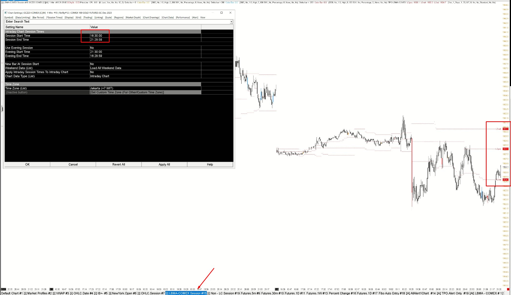

1. I create 1 Chart with Open - Close time: 16:30:00 - 21:29:59
2. I create a TPO Line and have the value LCvah | LCpoc | LCval as shown in figure 1.
3. I use Studies / Price Overlay to take the TPO value just created in 2 to chart 2 with Open - Close: 05:00:00 - 04:59:59

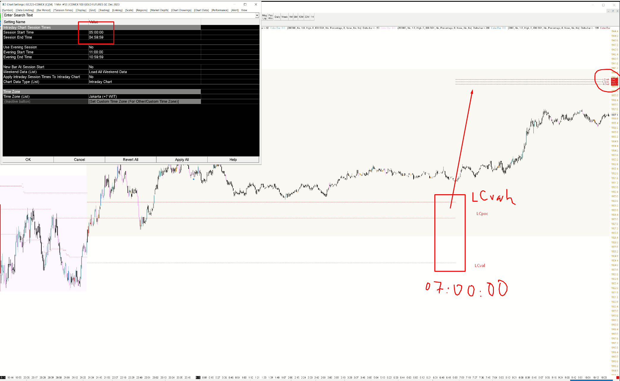

The problem I'm having is that the value of TPO Lines resets automatically at 7:00:00 (in chart number 2).
I want the LCvah, LCval, LCpoc values ​​to be pulled until the door opens, which is 16:30:00, what should I do? Am I configuring something wrong?
imageScreenshot_21.png / V - Attached On 2023-09-17 18:42:03 UTC - Size: 179.32 KB - 249 views
imageScreenshot_22.png / V - Attached On 2023-09-17 18:42:10 UTC - Size: 193.37 KB - 257 views
[2023-09-18 16:03:06]
You need to adjust your "Data Copy Mode" and /or "Bar Time Matching Method" in the Study/Price Overlay. Refer to the information starting here:
Study/Price Overlay Study: Data Copy Mode
