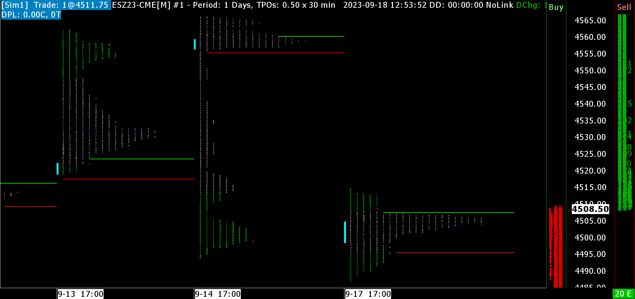

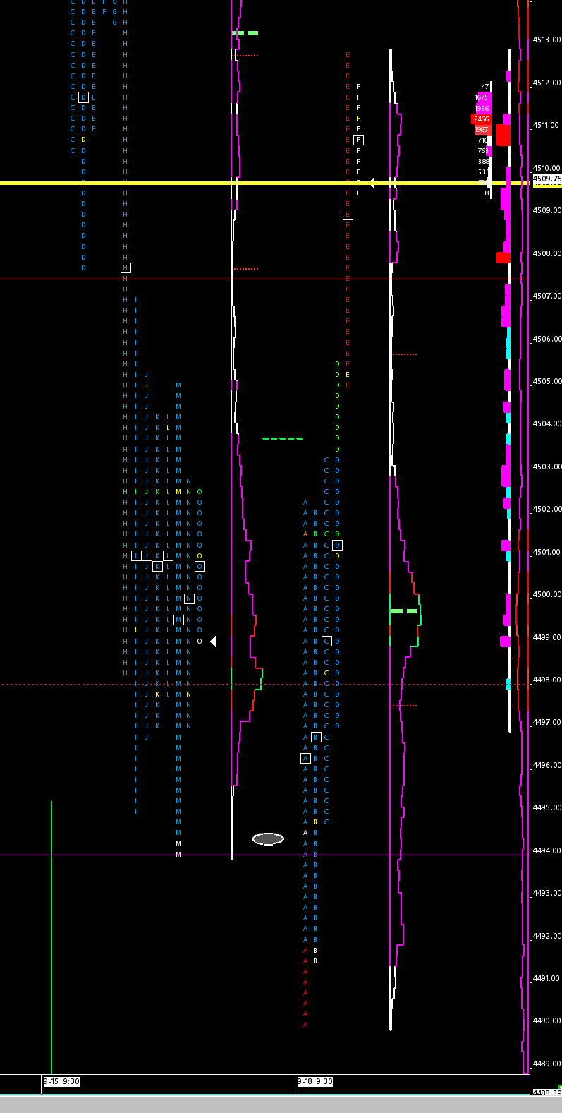

I thought I sent this so if repeat apologize in advance. Yes the size of the letters do not scale larger along with the number scale on the right side, with the open gl on. The spacing increased just not the letters and or the numbers (price).
imageNO open GL 2547.png / V - Attached On 2023-09-18 16:44:42 UTC - Size: 131.37 KB - 243 views
imageopen gl 2547.png / V - Attached On 2023-09-18 16:44:54 UTC - Size: 75.19 KB - 235 views

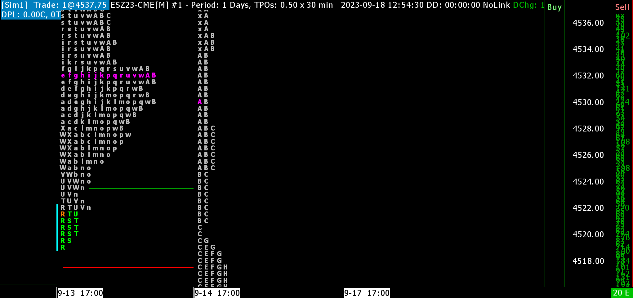

[2023-09-18 17:56:03]
To begin with, there is an issue with the Fonts and OpenGL that we are looking into.
But, we are not understanding the images you provided as it relates to the TPO setting for "Letter/Font Size" set to '0'. Attached are two images with different scale ranges. This is what is supposed to occur when that is set to 0, as you increase the Scale Range, the font size of the letters gets bigger.

THANOS929 - Posts: 23
No the auto scaling works properly when open gl is off, and not when it is on. This is the first time I have seen a problem with the open gl, I have been using it for a long time.
When auto scale and open gl on, the letters change size barely , and the price stays in smaller font, along with the volume in the vbp study, smaller font. Then make the swtich to open gl off, and the autoscaling works perfectly, enlarging everything from letters to volume to scale (price).
