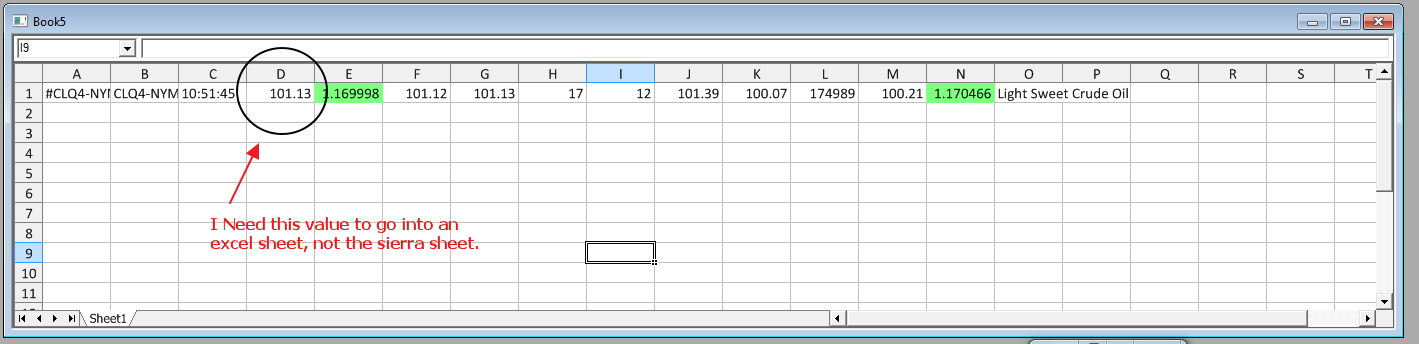

[2014-07-15 17:10:58]
User62351 - Posts: 3
I need to have live data for a symbol go into an excel sheet. I need this in an external excel sheet using EXCEL not the built in sheets in Sierra. How do I do this? Usually in other programs there is a DDE link.
Thanks.

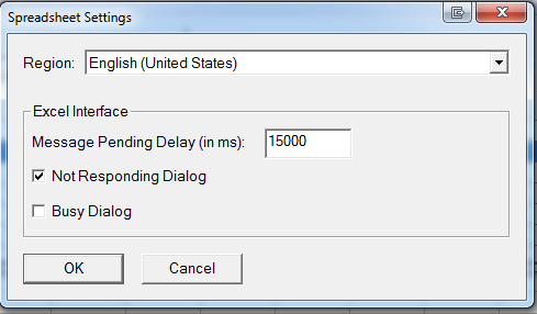

[2014-07-16 17:43:52]
There is no option on the Global settings>Spreadsheet settings to use excel.
as this link describes.
imageexcel sierra.png / V - Attached On 2014-07-16 17:43:17 UTC - Size: 21.02 KB - 614 views
[2014-07-16 17:46:41]
Use Excel is a study input. For instructions to access study inputs, refer to:
Chart Studies: Adding/Modifying Chart Studies

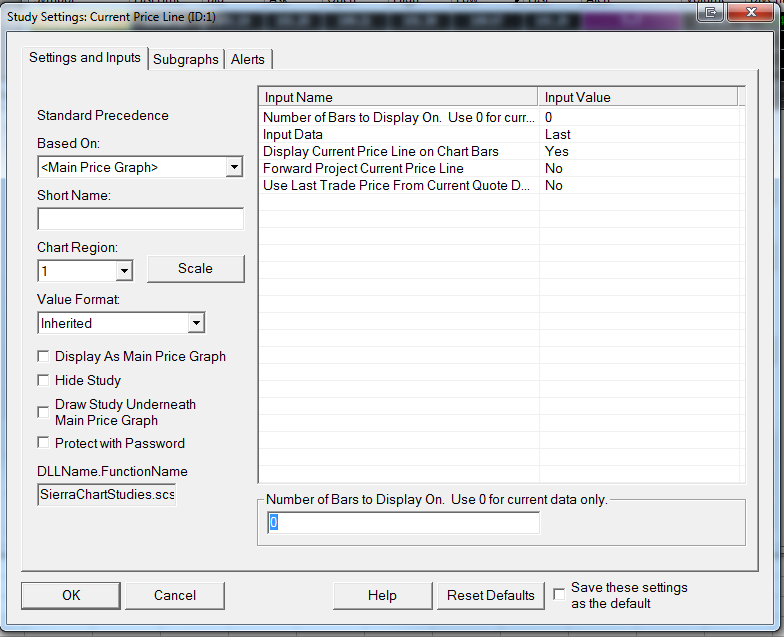

[2014-07-16 18:15:40]
I added the current price line study to a chart and I don't see the "Use Excel" study input. Its not there.
Can you please explain how to get the current price for an instrument to go into Excel. This should be a simple thing and not some complicated process. I cant use the built in excel sheet in sierra because I need this data for a large custom excel sheet I have built. All I need is to get current close data to go into excel. simple.
imageexcel sierra1.png / V - Attached On 2014-07-16 18:15:17 UTC - Size: 33.46 KB - 616 views
imageexcel sierra2.png / V - Attached On 2014-07-16 18:15:26 UTC - Size: 59.12 KB - 530 views
[2014-07-16 19:23:42]
The way in which this works is through the Spreadsheet study. Here is the documentation for the Spreadsheet study:
https://www.sierrachart.com/index.php?page=doc/doc_SpreadsheetStudy.html
It is the Spreadsheet Study that has the Use Excel input.
