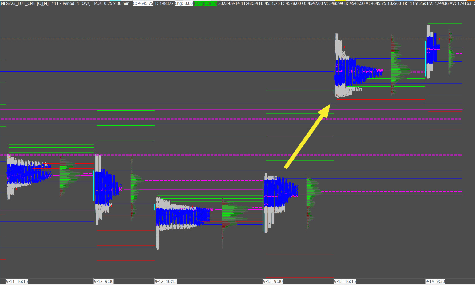

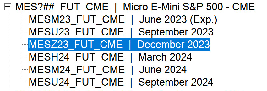

I have a problem, every time I switch to a new contract, the graph seems to jump up, even though I updated a contract, now I'm on MESZ23

You are using a Continuous Futures Contract chart, therefore what you are seeing is the difference in the price for the previous contract and the current contract. This is normal.
If you want to adjust the previous contracts to match up to the current contract, then you need to use a "Back Adjusted" continuous futures contract option. Refer to the information here:
Continuous Futures Contract Charts: Understanding Back Adjusted Price Data and Comparisons

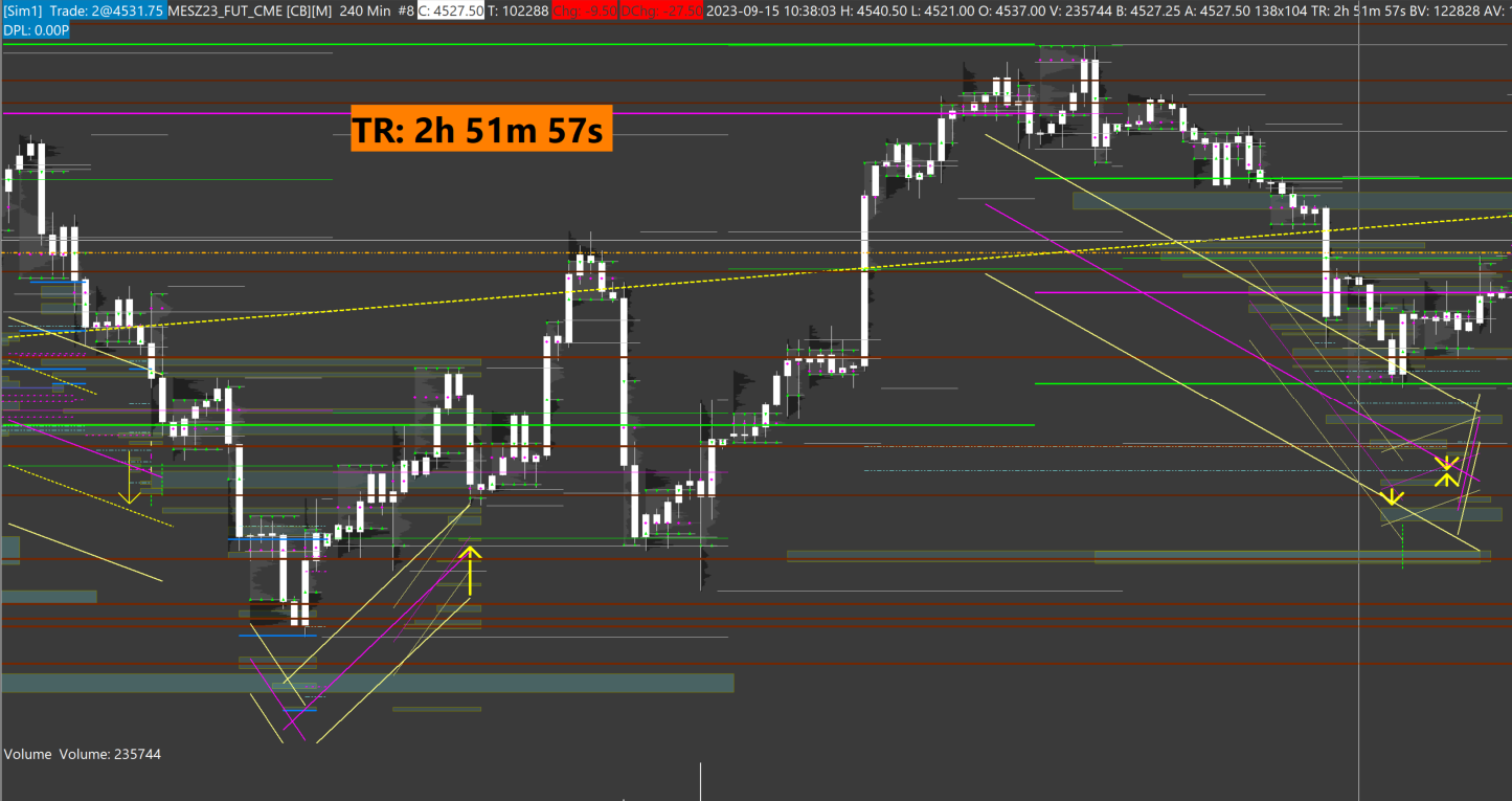

But in another chart, all the drawings seem to have gone down...see Attached photo
How to fix it?

Refer to the following:
Changing to a New Futures Contract Month: Adjusting Chart Drawings to Match Futures Contract Rollover Difference
