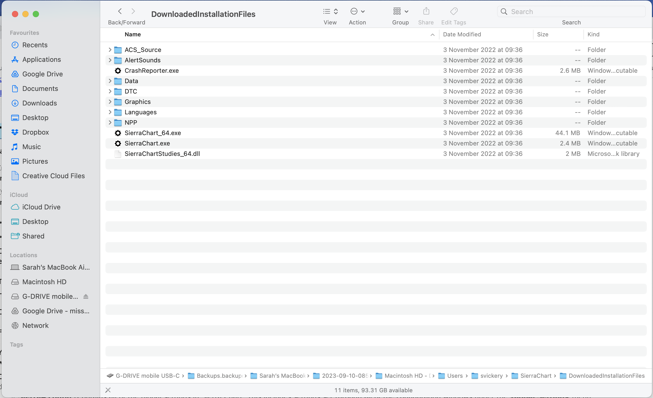

I can locate this on my external backup drive. Should I copy the files in the folder called "Data" from the external drive to and overwrite those in the new installation's "Data" folder? see attached screenshot. thanks

[2023-09-12 16:32:47]
If you have the files you need in that backup, then follow the instructions at the following link to copy the specific files listed to your Sierra Chart installation:
Transferring Sierra Chart Settings and Data From Existing Installation to New Installation: Transferring Sierra Chart Settings and Data From Existing Installation to New Installation
[2023-09-12 21:10:32]
It looks like the files in that particular Data folder are the default installation files and they do not have your own Chartbooks.
Do you see your own Chartbooks in that Data folder?
[2023-09-13 10:31:44]
Judge Kilday - Posts: 32
I have found my own Chartbooks and installed them on a second instance of SC which seems to be running fine now. I will use the original instance of SC for my personal account and the second instance for my Apex account,
