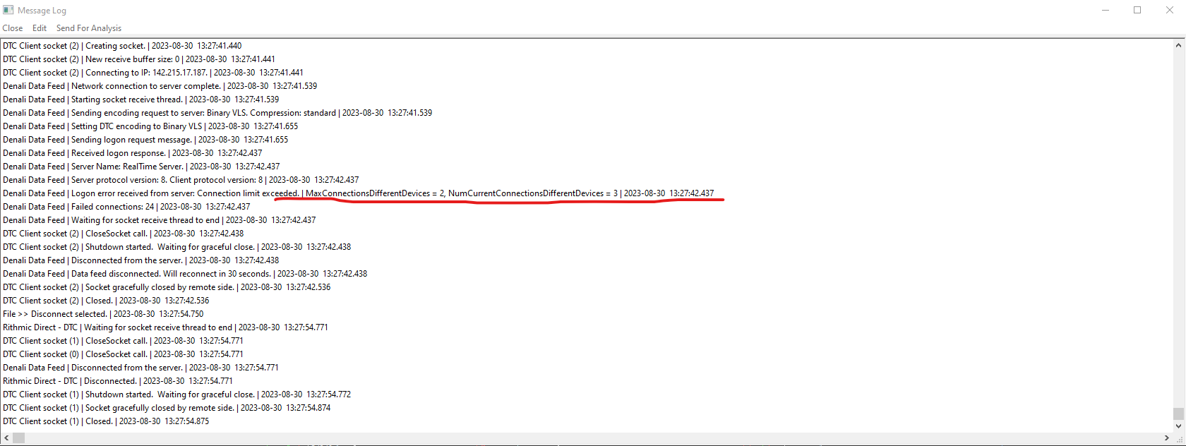

I cant connect to the denali feed with the error message stating that the MaxConnectionsDifferentDevices = 2, NumCurrentConnectionsDifferentDevices = 3
On my account control panel it states that i have 3 devices set up.
I have connected to my live broker account through CQG
I do not understand what is going on here
Any help appreciated.

[2023-08-30 15:42:03]
John - SC Support - Posts: 47955
You are allowed to have 3 different computers running Sierra Chart simultaneously.
But the exchanges work differently. They only allow for two computers to be connected simultaneously and you have to pay an extra exchange fee for this. You are already setup for this which is why you are allowed 2 connections. But refer to the following for more information on this:

[2023-08-30 16:10:42]
User352843 - Posts: 7
Hi
I understand. Thanks for the prompt reply.
Is there any way to make it so there can be 3 separate computers using the denali exchange?
[2023-08-30 17:50:29]
We do not have a way to do this.
