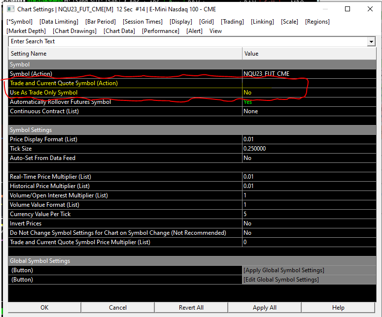

Gustavo - Posts: 81
Hi John, I can confirm that my "Trade and Current Quote symbol" value is empty; and therefore, the "Use As Trade Only Symbol" value is set to "No."
As mentioned on my original message, I have set the Symbol to filter the MBO data so not to see everything, but only MBOs of a certain size and up.
I'm attaching a couple of screenshots with my settings (to be honest, not sure the system is really attaching them). Let me know if you see anything wrong. Thanks!

[2023-08-30 15:54:21]
The attachments are there, so we can see them.
Like we said, the most likely reason is the "Trade and Current Quote Symbol", but that does not apply here, so we have to find the "not so likely" reason.

[2023-08-30 17:45:48]
In your Symbol Settings, you do not have the item at the top left for "Use Custom Symbol Settings Values" enabled. This has to be enabled for the change you made to take affect.
[2023-08-30 18:40:40]
Gustavo - Posts: 81
John, thanks so much. That solved the problem. The strange thing is it was working fine before, so I do not know how that got unchecked. Anyhow, again, thanks!!!
