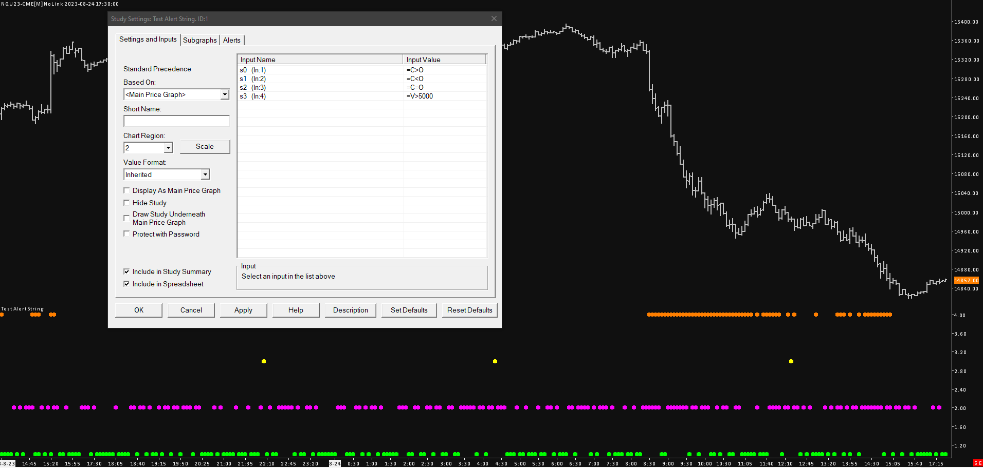

The attached code works as expected (sligtly modified from what you posted), see also screenshot.
imagealert formula string.png / V - Attached On 2023-08-27 20:54:29 UTC - Size: 74.25 KB - 395 views

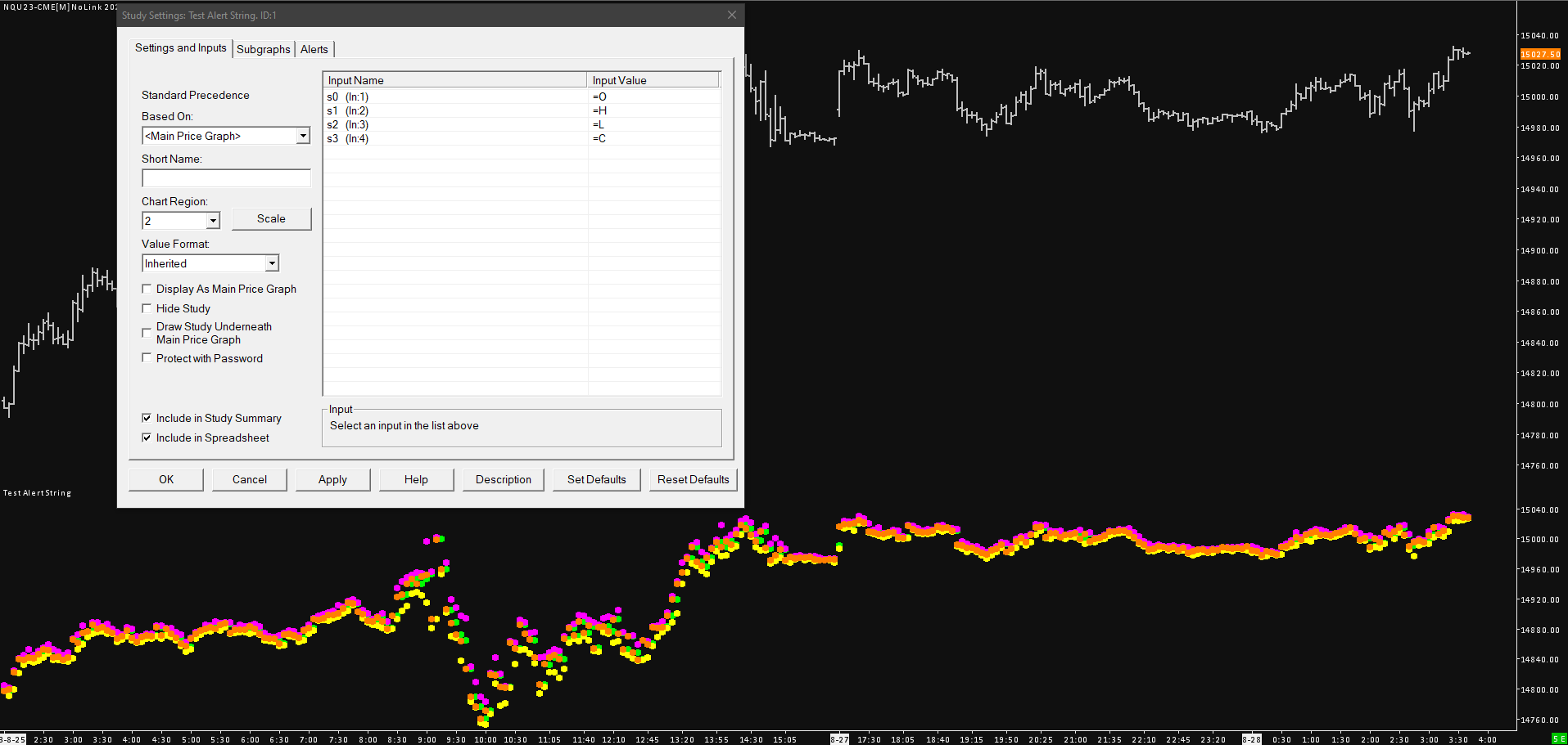

See attached image with offending code removed.
imageformula string ohlc.png / V - Attached On 2023-08-28 08:46:57 UTC - Size: 86.23 KB - 322 views
