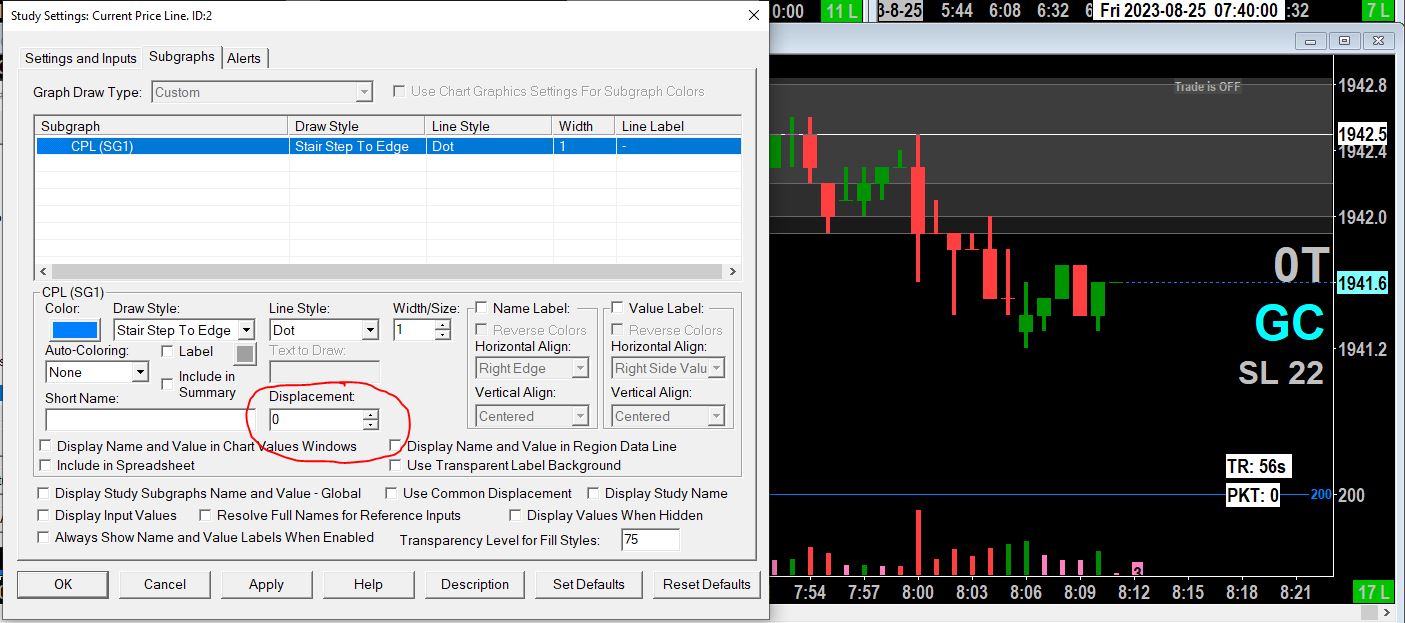

In the Current Price Study there is a "Displacement" possible but only to the right.
When Im trading I only open a position if the Candle Formation is not bigger than a surrten amount of tics.
I would like to offset one Study up and another down to see the maximal Stop Loss that I use.
Could you please add this function to this study?
imageCurrent Price Study 1.JPG / V - Attached On 2023-08-25 06:13:04 UTC - Size: 159.57 KB - 265 views
[2023-08-25 14:57:18]
John - SC Support - Posts: 48369
The Current Price Line has an Input called "Number of Bars Back to Reference". This will let you get a line for the Input Data for a previous bar. Refer to the following:
Current Price Line

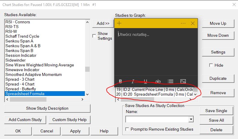

I added studies:
- Current Price Line
- Spreadsheet Formula
picture 1

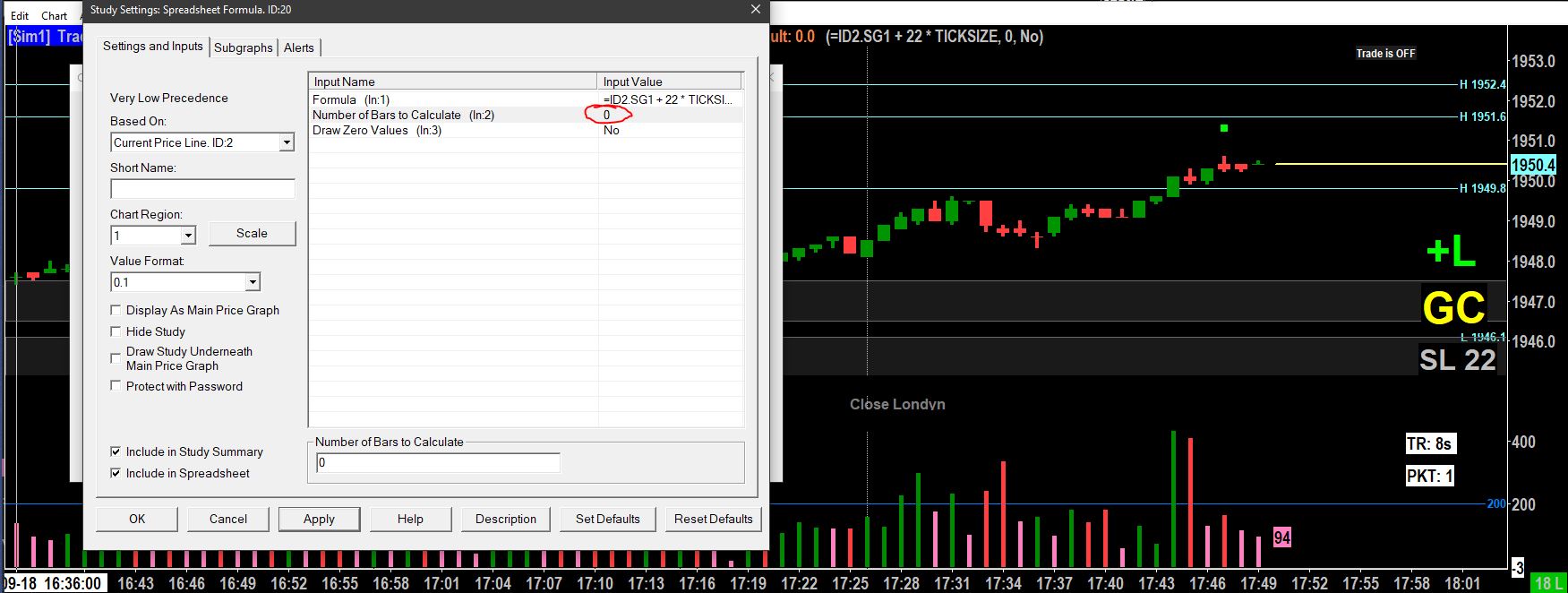

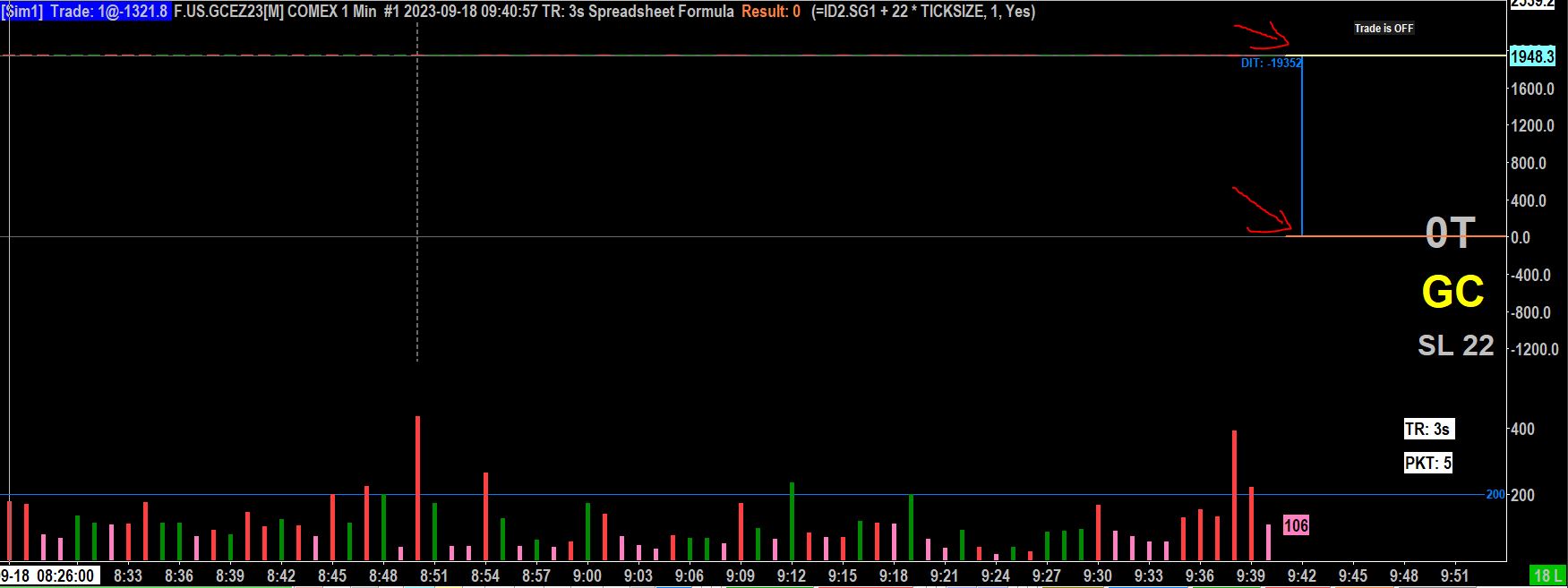

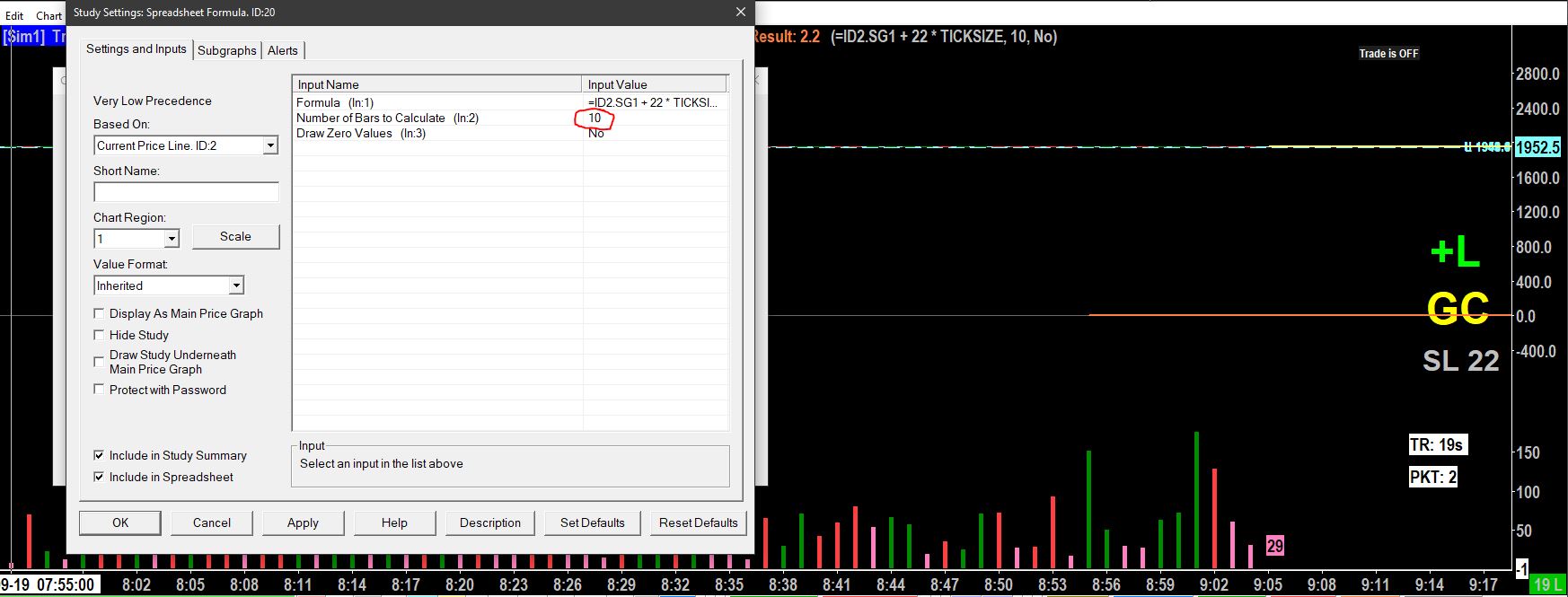

The Spreadsheet Formula is set to =ID2.SG1 + 22 * TICKSIZE (picture 2)
But the line is at 0.
Changing the 22 to a different number doesn't change anything (see picture 3).

[2023-09-18 14:44:03]
Sawtooth - Posts: 4359
In the Spreadsheet Formula study:
- Set Draw Zeros to No.
- Set 'Number of Bars To Calculate' to <= the 'Number of Bars to Display' in the Current Price Line study.

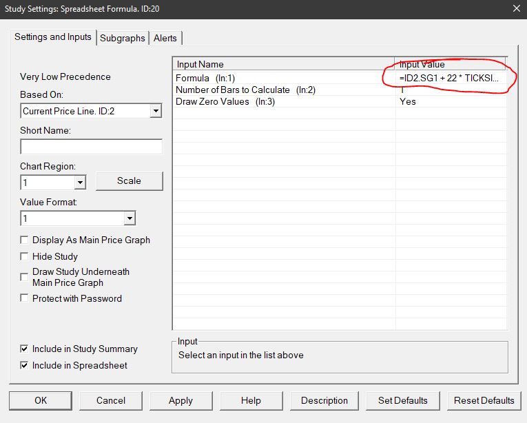

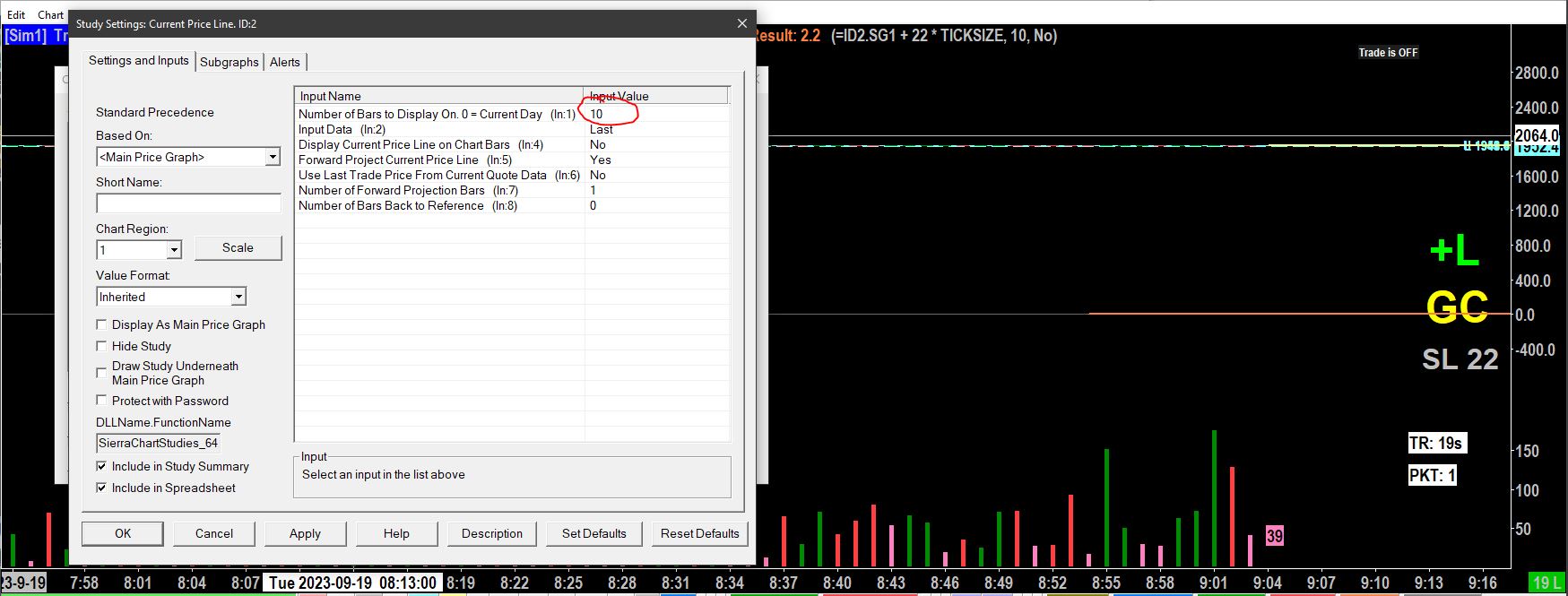

When
"Number of Bars to Calculate" set to 1 see picture 4
"Number of Bars to Calculate" set to 0 see picture 5
still its not working.
image4.JPG / V - Attached On 2023-09-18 15:50:44 UTC - Size: 176.55 KB - 255 views
image5.JPG / V - Attached On 2023-09-18 15:50:53 UTC - Size: 170.17 KB - 294 views
[2023-09-18 16:17:51]
In the Spreadsheet Formula study, set the Number of Bars to Calculate to 10
In the Current Price Line study, set the Number of Bars to Display to 10

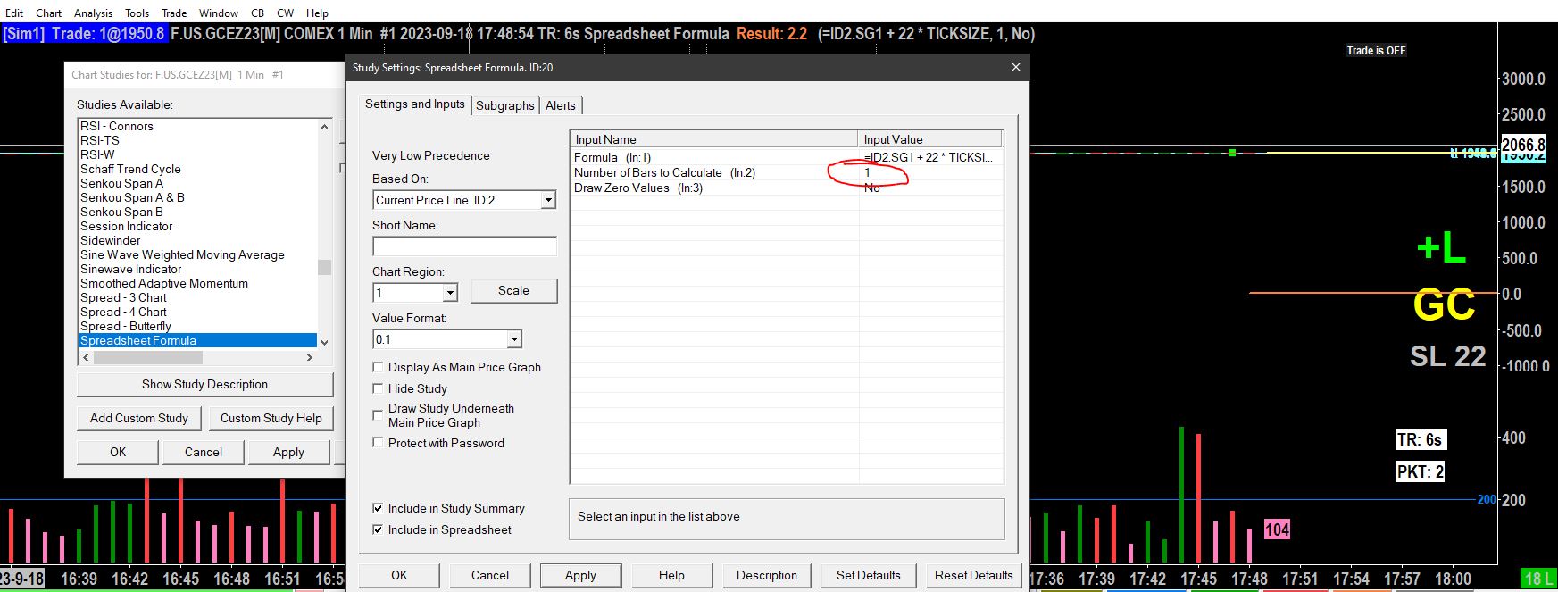

[2023-09-19 07:08:25]
Piotr Grzegorzek - Posts: 35
I did the change in setting (see picture 6 and 7) but it's not working properly.
Also now the lines cover the candles but they should be shown only after the last candle.
image6.JPG / V - Attached On 2023-09-19 07:08:02 UTC - Size: 165.51 KB - 208 views
image7.JPG / V - Attached On 2023-09-19 07:08:13 UTC - Size: 146.79 KB - 227 views
[2023-09-19 14:44:14]
See attached chartbook for an example of how to do this.
attachmentCPL envelope.Cht - Attached On 2023-09-19 14:44:04 UTC - Size: 4.38 KB - 474 views
[2023-09-22 12:36:46]
Thanks, it works now.
