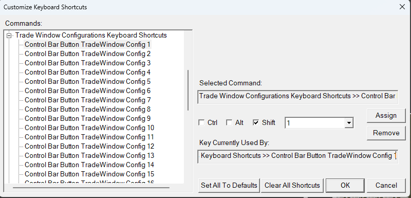

User132992 - Posts: 34
Hi John,
I've assigned this as directed, but nothing happens when I press 'shift +1'. I'm expecting this to trigger the first saved order configuration in my trade window drop down menu - is this correct?
Have I missed a step?

[2023-08-23 15:07:15]
You first need to configure the Control Bar buttons for the configurations you want to use:
Global Settings Menu: Trade Window Configurations Keyboard Shortcuts

[2023-08-23 19:15:46]
Just to make sure, when you were setting up the Control Bar button for the Trade Configuration - did you select the "Customize" button and assign the specific Trade Configuration to the Control Bar button?
If so, then as long as that control bar button is still added to a control bar (even one that is not displayed) then a keyboard shortcut for the same number should work.

[2023-09-05 12:13:18]
Hi John,
Sincere apologies - I've just figured out how this works - there is a separate command for placing the order and a separate command for selecting the trade configuration - apologies, I thought that the keyboard commend for selecting the trade configuration also placed the trade - my mistake and I'm sorry for the confusion. All good now.
