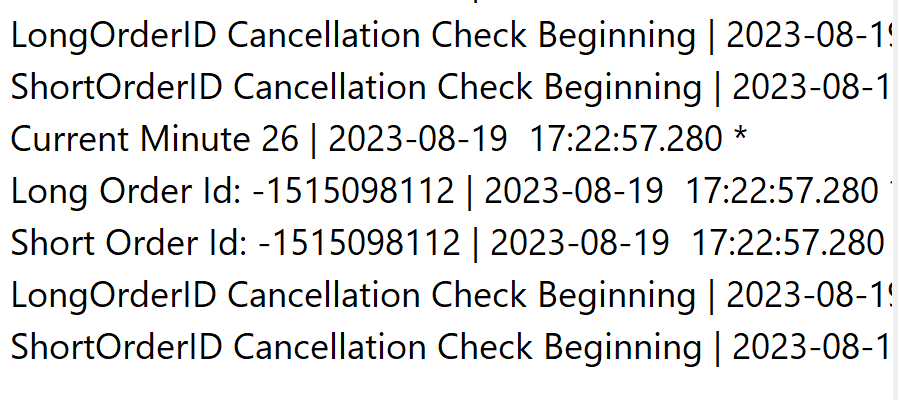

I've noticed that, for example, the ShortOrderId is changing to a random number even though no new orders have been sent. In this case, the ShortOrderId is only set when a new sell order is created.
See Attached
From the Price Chart image, you can see that a buy order was stopped out. Thus there should be a LongOrderId which there is.
A sell order was then sent after being stopped out of the long but wasn't filled.
Looking at the Changing Error image, you can see that I'm logging the LongOrderId and ShortId, as well as the Bar Time and Execution Time when an order is submitted.
You can also see that even though there are no new orders submitted (see Price Chart image) both the LongOrderId and the ShortOrderId both change.
Referring back to the cancel order logic above, I log when checking if the OrderId matches the InternalOrderId of the retrieved order.
This log is displayed correctly for a couple iterations but then stops because the ShortOrderId changes even though no new order has been sent, thus preventing the stale order from being canceled.

After further analysis, Long and Short Order IDs are being set to the same value which programmatically isn't possible because these values are initialized once buy or sell signals are created. IDs shouldn't be the same and shouldn't be negative values. See Attached (Long and Short IDs Identical Error)
imageLong Short IDs Identical Error.png / V - Attached On 2023-08-19 21:28:20 UTC - Size: 40.91 KB - 283 views

Thanks.
[2023-08-21 13:33:39]
ondafringe - Posts: 343
Misread your code, so deleted my earlier comments.
Use the VS debugger to step through your code. Makes it much easier to track down problems.
[2023-08-21 13:34:13]
User431178 - Posts: 910
If the logic is correct and the setting of the ShortOrderId can only happen when a new sell order has been sent, how can the ShortOrderId change in the same bar of the original sell order.
It's not changing, on the next call into the study function you are reading the value of an uninitialized variable.
This is undefined behavior and the value could essentially be anything.
If you want the values to be available between function calls, then you need to use persistent variables.
ACSIL Interface Members - Functions: Persistent Variable Functions
Ultimately, the intent of capturing the LongOrderId and ShortOrderId is to track the elapsed time of the order and if at some threshold and not filled to cancel.
See link above.
For further information about the scope / lifetime of variables, please see - https://en.cppreference.com/w/cpp/language/scope
Date Time Of Last Edit: 2023-08-21 13:37:37
[2023-08-21 13:38:14]
Gradient - Posts: 219
Thanks.
Will take a look now.
[2023-08-28 21:07:40]
ForgivingComputers.com - Posts: 1253
You want your study to remember the OrderIDs from previous passes through the study function. OrderIDs should not be declared as int, but as Persistent Variables.
int& LongOrderID = sc.GetPersistentInt(0);
int& ShortOrderID = sc.GetPersistentInt(1);
