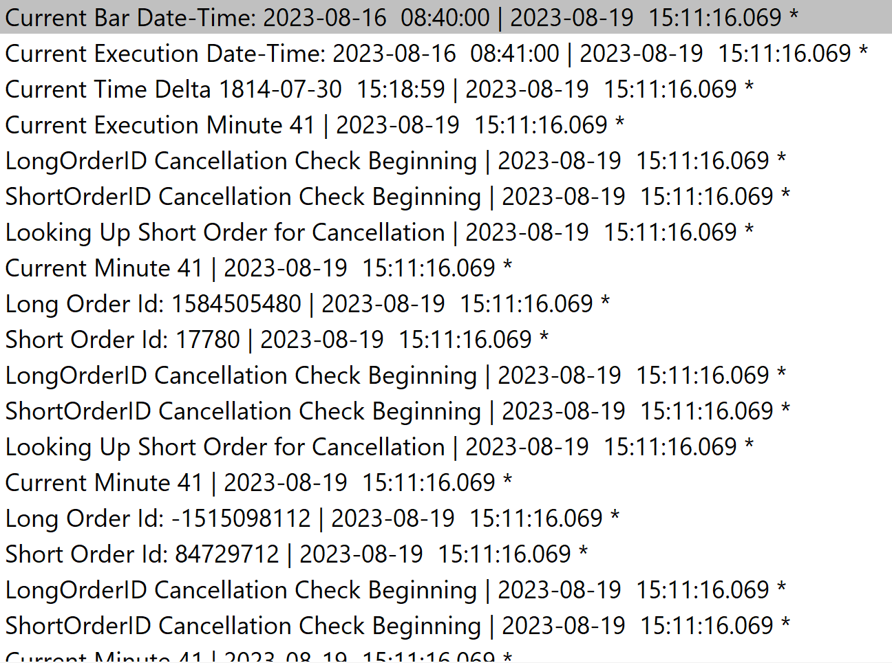

I've noticed that, for example, the ShortOrderId is changing to a random number even though no new orders have been sent. In this case, the ShortOrderId is only set when a new sell order is created.

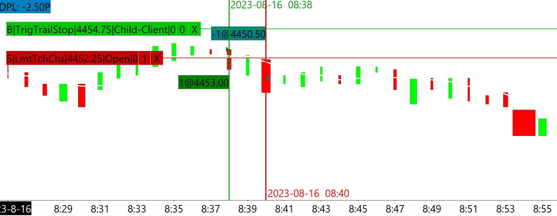

See Attached
From the Price Chart image, you can see that a buy order was stopped out. Thus there should be a LongOrderId which there is.
A sell order was then sent after being stopped out of the long but wasn't filled.
Looking at the Changing Error image, you can see that I'm logging the LongOrderId and ShortId, as well as the Bar Time and Execution Time when an order is submitted.
You can also see that even though there are no new orders submitted (see Price Chart image) both the LongOrderId and the ShortOrderId both change.
Referring back to the cancel order logic above, I log when checking if the OrderId matches the InternalOrderId of the retrieved order.
This log is displayed correctly for a couple iterations but then stops because the ShortOrderId changes even though no new order has been sent, thus preventing the stale order from being canceled.
