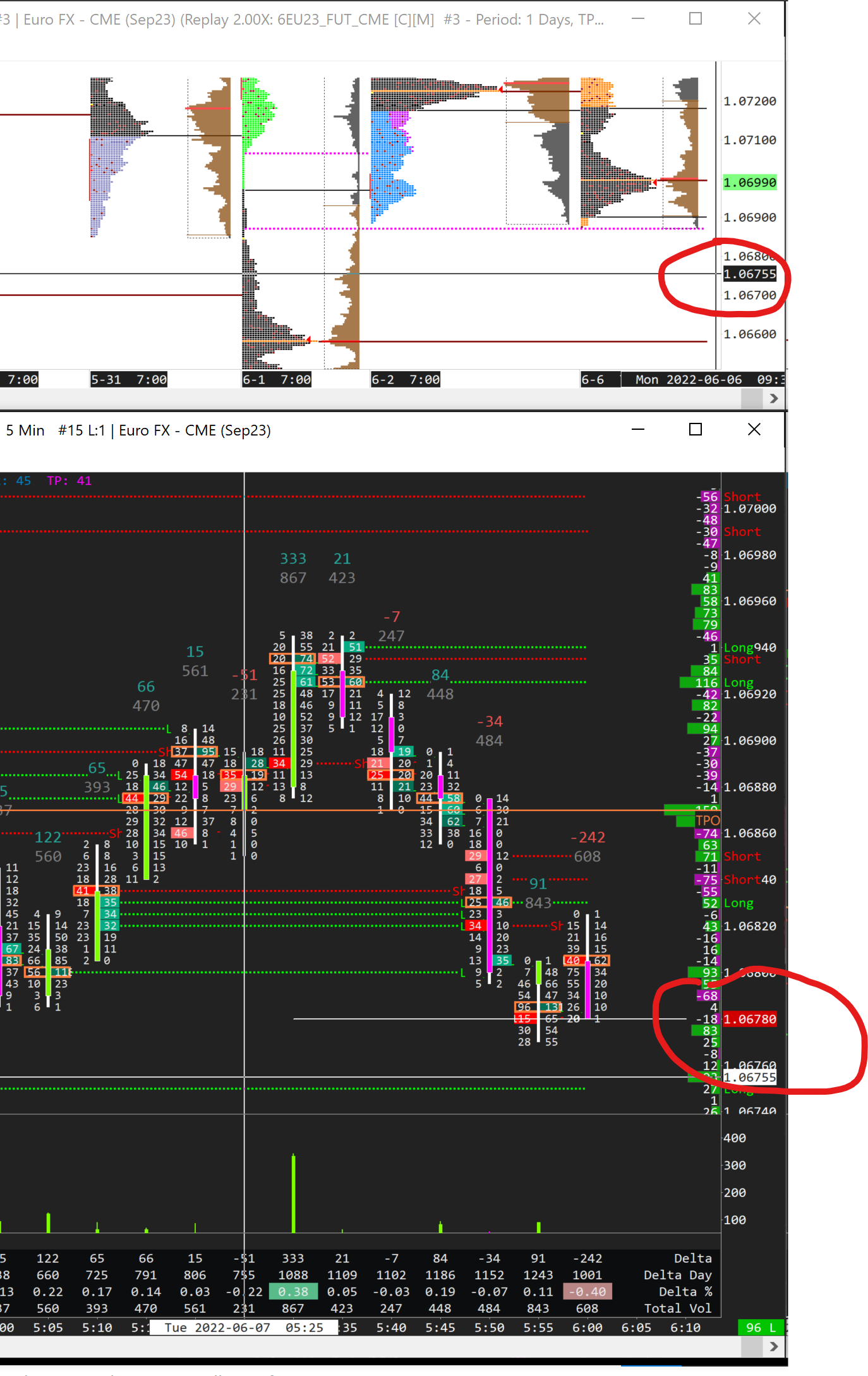

See that the tpo doesn't show change the price it always tay on the same place vs the chart below that always is changing because of the replay.

[2023-08-09 19:57:15]
What you are seeing is indicating that the charts are out of sync. Refer to the following:
Replaying Charts: Preventing Loss of Synchronization Between Different Charts During Replay

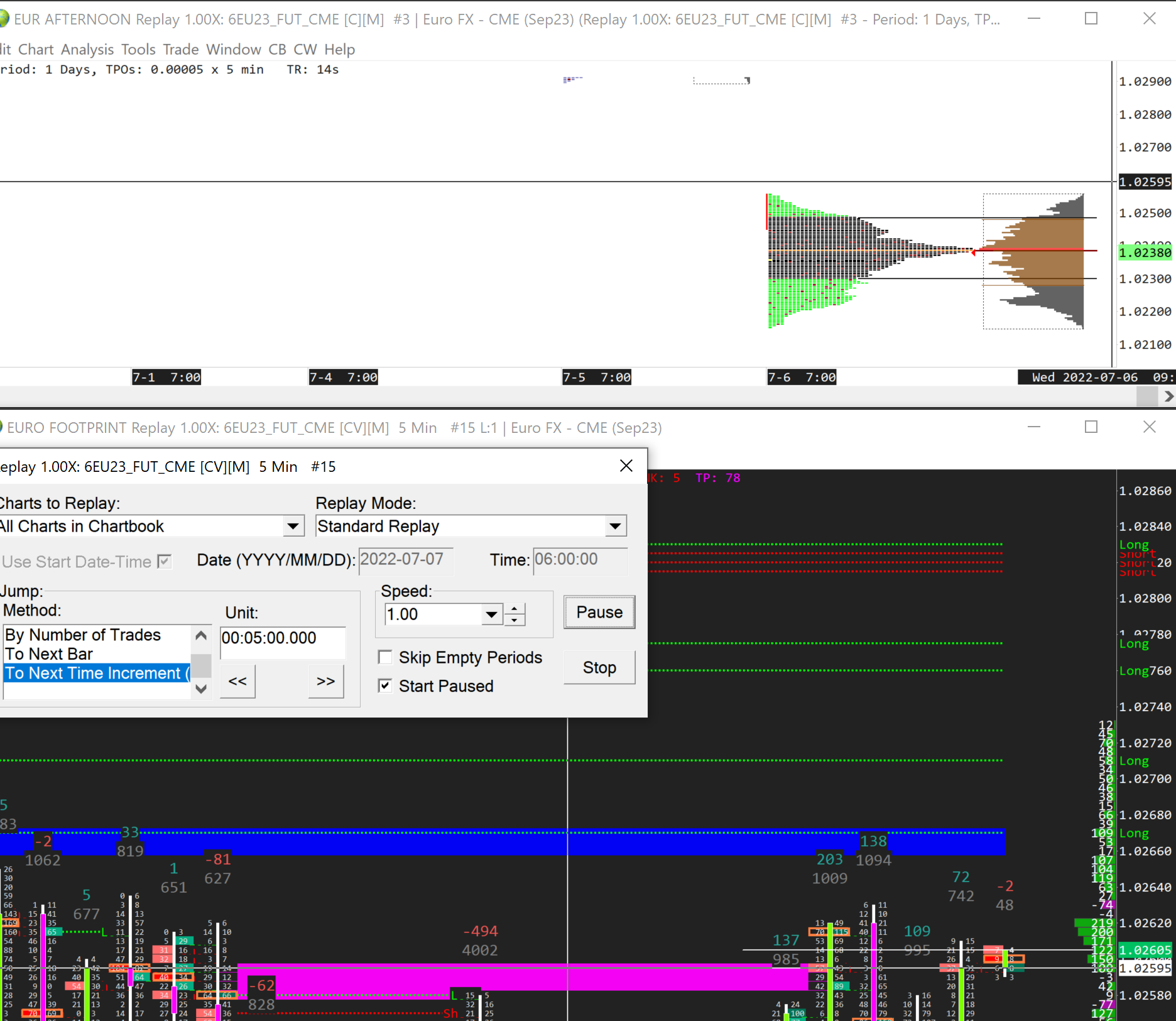

I have skip empty periods on check, as you can see on the picture it doesn't show the same price.

[2023-08-17 12:52:39]
What is the chart time when you took that image? Is it part of the Evening session? Do your Session Times cover the same times in both charts?
Also, for the TPO chart, are any of the Inputs set to not show the Evening Session?

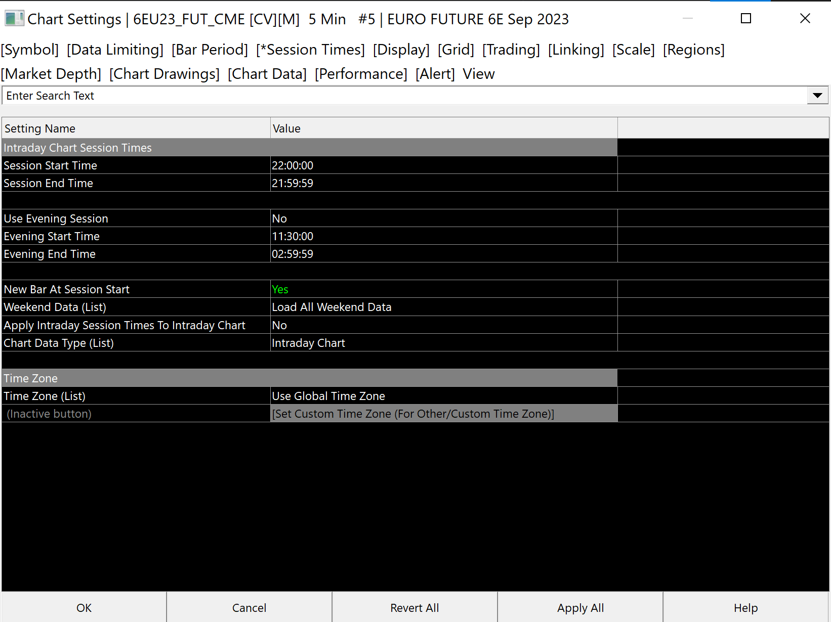

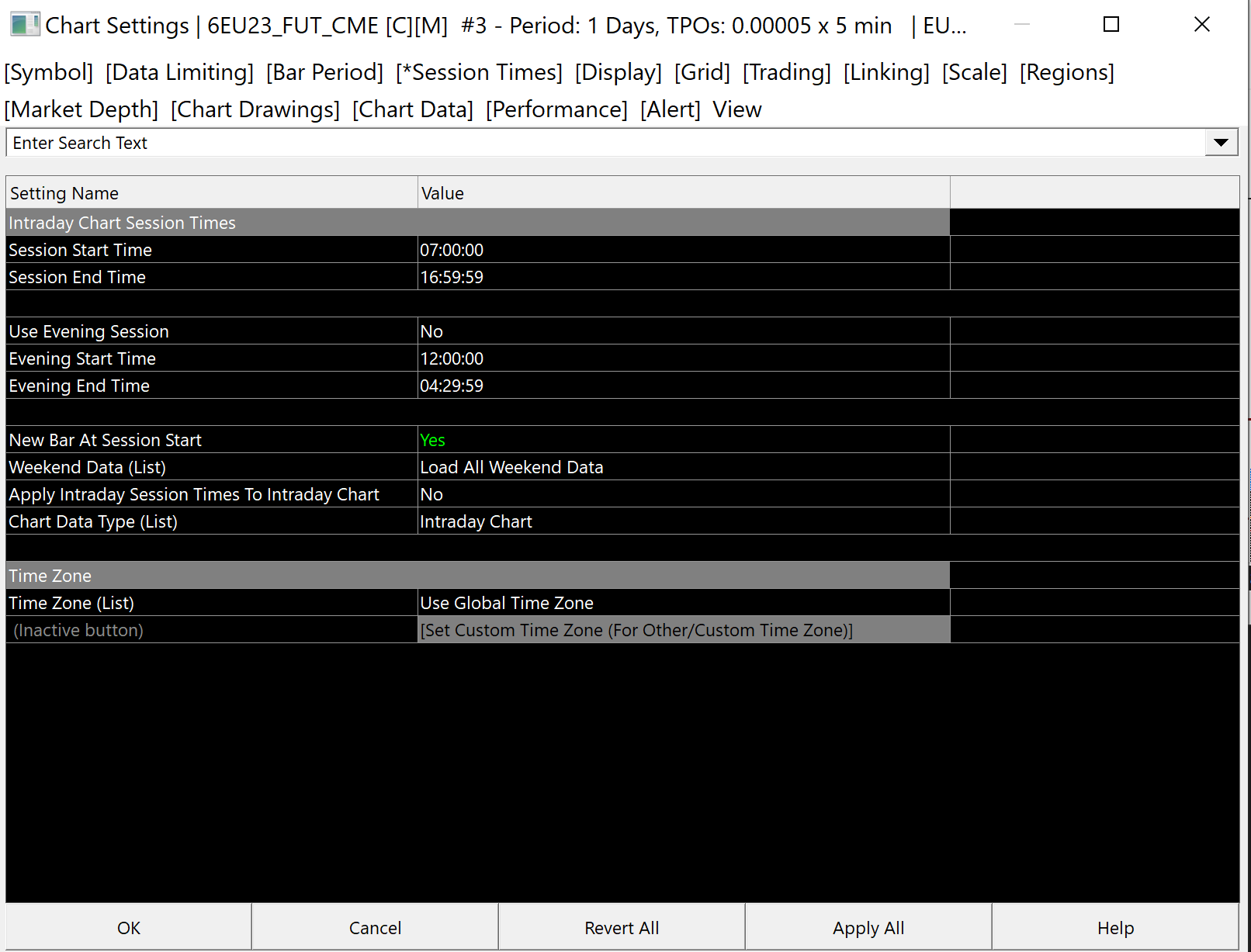

I start my replay at 4:00 hours. I attach the settings for the top chart no displaying correct values and the below chart that display everything correctly.

Your Session Times are different. In particular, the 04:00 start time you have is outside of the session times for the TPO chart. You would need to adjust the Session Times to be what you need them to be. Refer to the information here:
Chart Session Times
