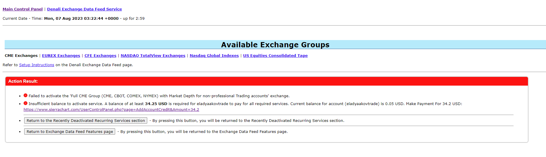

I got a delay with the graphs (ES NQ YM RTY)
The sierra thinks I havent enough margins (I charged 2500$ 2 days ago)
-I tried to update new version (according to the new post from 01/08/2023)
attached photo below.

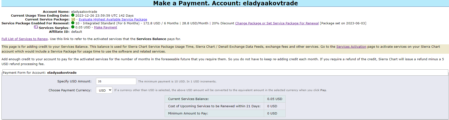

The first photo (M1) is the message what I got.
The last photo (M5) is me asking if I'm on the correct payment page.
Will be glad for help. Warm regards.
imageM1.png / V - Attached On 2023-08-07 03:49:41 UTC - Size: 44.69 KB - 176 views
imageM5.png / V - Attached On 2023-08-07 03:51:30 UTC - Size: 61.53 KB - 216 views
[2023-08-07 14:28:36]
The CME Group exchange you had active (Full CME Group with Market Depth) did not renew on August 1, 2023 due to insufficient funds in your account.
The exchanges renew on a calendar month basis. This is separate from, and different from, your Sierra Chart Usage Time renewals.
You need to have $34.25 in your Services Surplus in order to re-activate the exchange. You add funds to your account at the following link:
https://www.sierrachart.com/UserControlPanel.php?page=AddAccountCredit
You can then re-activate the exchange by going to the "Recurring Services" page, scrolling to the bottom and selecting the button for "Reactivate Exchange". You can access the "Recurring Services" page from the following link:
https://www.sierrachart.com/UserControlPanel.php?page=RecurringServices#RecentlyDeactivatedRecurringServices
