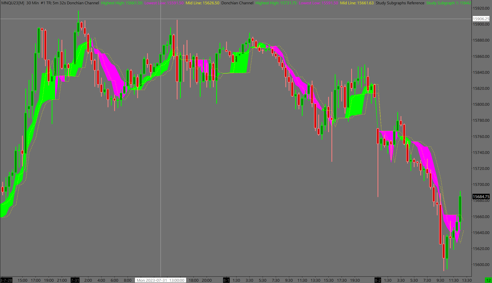

Hi
i was trying the Study Subgraphs Reference with two Donchain midlines to create the couloured space inbetween, but unfortunately the study doesnt look correct.
not sure why, i have tried different options in the scale menu, but none of them was correct.
if i try the Study Subgraphs Reference with two moving averages then it works fine, but not with the donchian midline.
can you tell me please what is wrong and how to fix it?
thx

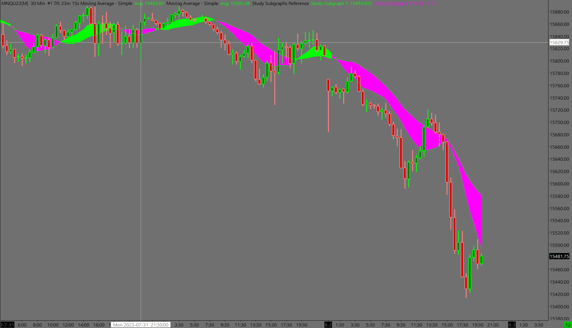

[2023-08-02 18:19:44]
artmaan - Posts: 27
i do have it on "same as region" , but it still doesnt look correct.
it doesnt work only with donchian mid line.
on this attached screenshot i have the "Study Subgraphs Reference" with two simple moving averages and it looks correct.
is there something i need to change in the donchian settings?
ty
https://www.sierrachart.com/image.php?Image=1691000216700.png
[2023-08-02 18:29:07]
We realize you stated in the title that the Donchian Channel is offset by 1 bar.
You would need to replicate this with the Study Subgraphs Reference subgraphs to make sure they line up properly.

[2023-08-03 19:55:15]
You do have your Donchian Channel offset. For both the Donchian Channel studies you have the Donchian Midline subgraph set to have a Displacement of "1".
If you then set the Displacement for both the subgraphs in the "Study Subgraphs Reference" to have a displacement of 1, then everything will line up.
Refer to the following regarding the Displacement option:
Chart Studies: Subgraphs Tab >> Displacement
