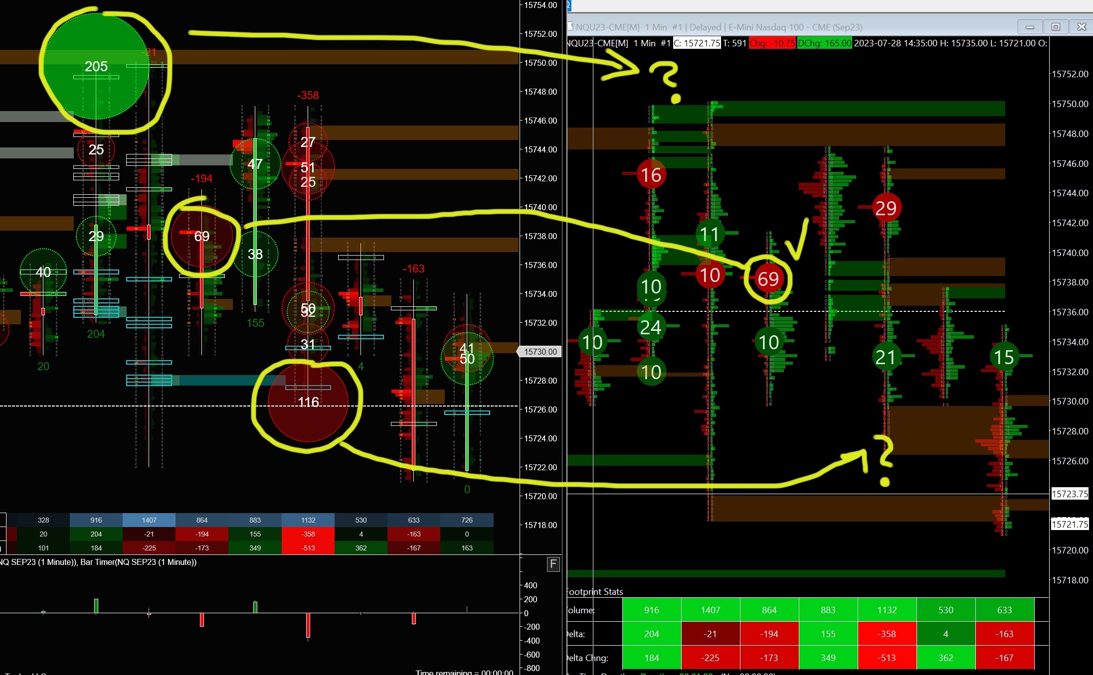

I use the study form post number 42. this study is running on an NQ chart, but the trades are executed on MNQ. And unfortunately, this study is also using the data from MNQ. So, I'm seeing the large trades from MNQ displayed on the NQ chart. Do you guys know what the solution might be? Thanks
[2026-05-12 16:41:27]
User751630 - Posts: 28
Yes me too ive got this problem(chart NQ and trading MNQ)
Because with a footprint chart the big trades doesn’t correspond with the orders in the footprint.
[2026-05-12 17:11:40]
User260640 - Posts: 21
I would double check this problem with T&S window (Menu: Chart>>Open Time and Sales Window) and change the settings by turning on combine records and setting the filter to be the same as the study you are using.
[2026-05-12 17:33:41]
Sierra_Chart Engineering - Posts: 25412
Regarding post #54 and #55, the solution would be to set this to Yes:
Chart Settings: Use as Trade Only Symbol (Chart >> Chart Settings >> Symbol >> Symbol menu)
But really we recommend updating to the latest prerelease and using this new setting:
Chart Settings: Trades Combining Method (Chart >> Chart Settings >> Chart Data >> Chart Data menu)
And the Large Volume Trade Indicator study:
[2026-05-12 17:38:58]
Make sure the combination settings match your study. If the combine records settings is set to "Time & Type", as my study is now, the volume matches my study marker volume.
