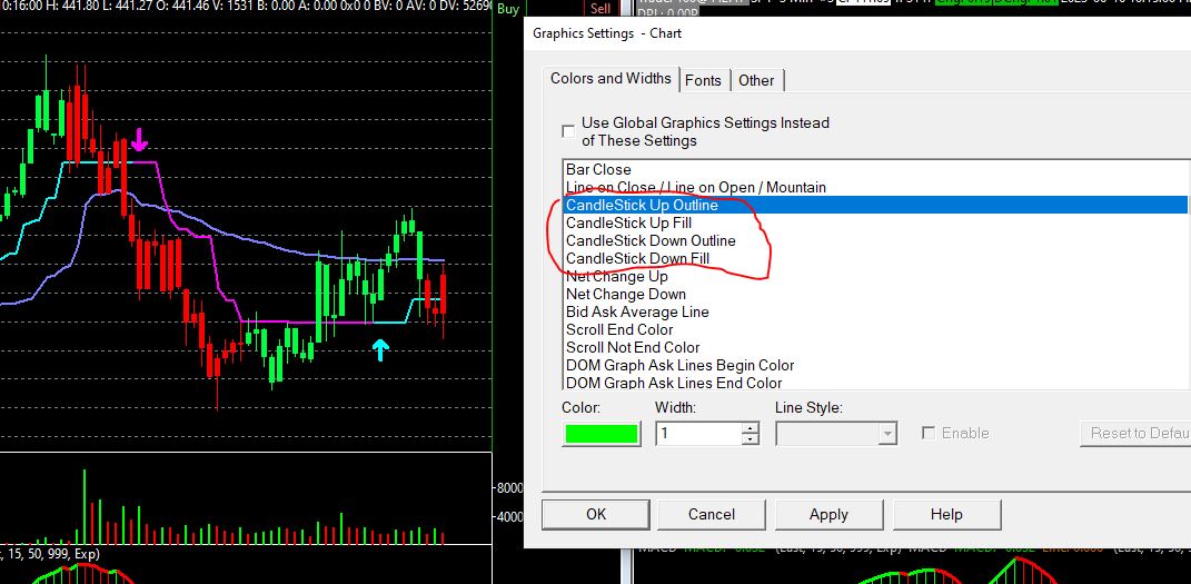

(1) I mean how to make the price bar move one by one (I failed to do so by press the scroll arrow)
(2) Please refer to the attachment, I cannot get the hollow candlestick by following the instructions on the link you sent to me, it looks like the contents in the link is vey obselet.
https://www.sierrachart.com/image.php?Image=1689647280234.png
Please advise
Charlie

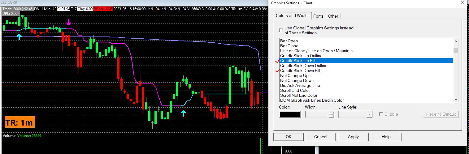

Hi:
1. If you use the right and left arrows on your keyboard this should move you one bar at a time.
----I tried, but it move many bars at a time, please try one your side first and then let me know the solution.
2. Select from the menu at the top of the main Sierra Chart window - "Chart >> Graph Draw Types >> Candlestick Bars Hollow".
----I follow your instruction, but cannot get hollow bar shown in the attachment, please try on your side first and let me know the solution.
https://www.sierrachart.com/image.php?Image=1689730425333.png
Charlie
imageSR2.JPG / V - Attached On 2023-07-19 01:36:30 UTC - Size: 136.87 KB - 254 views

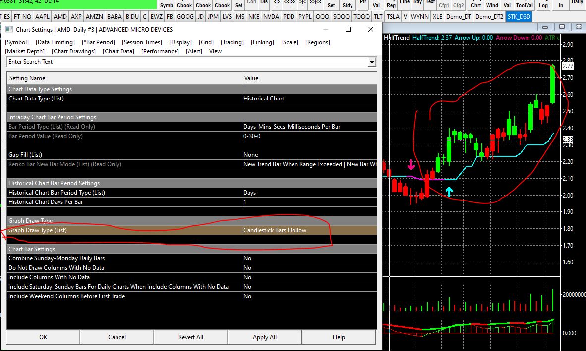

With regards to the Candlestick Hollow, try selecting the option from within "Chart >> Chart Settings >> Bar Period >> Graph Draw Type".
-----It does not work (pls refer to the attachment), please send me a video that works on your side.
https://www.sierrachart.com/image.php?Image=1689846540653.png
Please look into my two problems carefully and assist me to solve them, thanks!!!
-----It does not work (pls refer to the attachment).
Your bars are being colored by one of your studies (which is overriding the graph draw type), you can see that as there are bars that are clearly colored opposite to their direction.
Check all you studies and set drawstyles accordingly.
