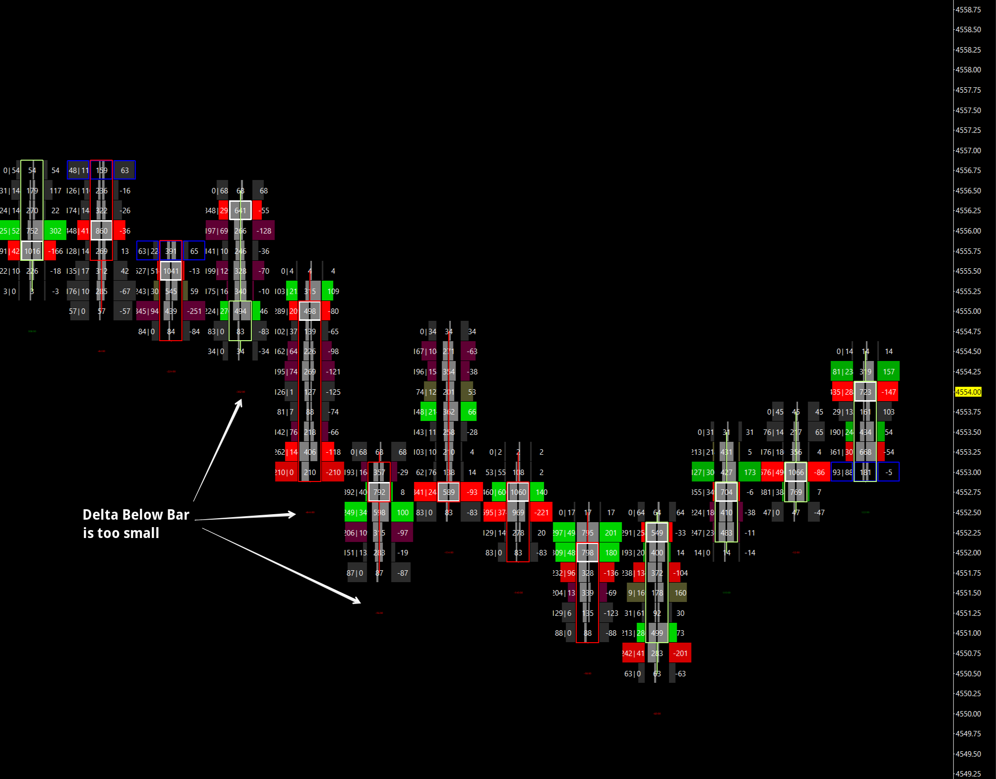

I've added a custom spreadsheet study to my chart = Bar Delta Below Bar.
As I'm using the number bar study on this chart the Bar Delta Below Bar font on the chart is very small.
please see pic.
How do I increase the font without affecting other chart items.
I presume it's via the chart >> graphics settings, however I've tried a few items and it's not making any difference.
Many thanks
imageSierra Chart Bar Delta Below Bar.png / V - Attached On 2023-07-16 02:01:50 UTC - Size: 183.92 KB - 247 views
[2023-07-17 17:56:41]
You need to adjust the Width/Size for the subgraph that contains that data. Refer to the following:
Chart Studies: Subgraphs Tab >> Line Width
