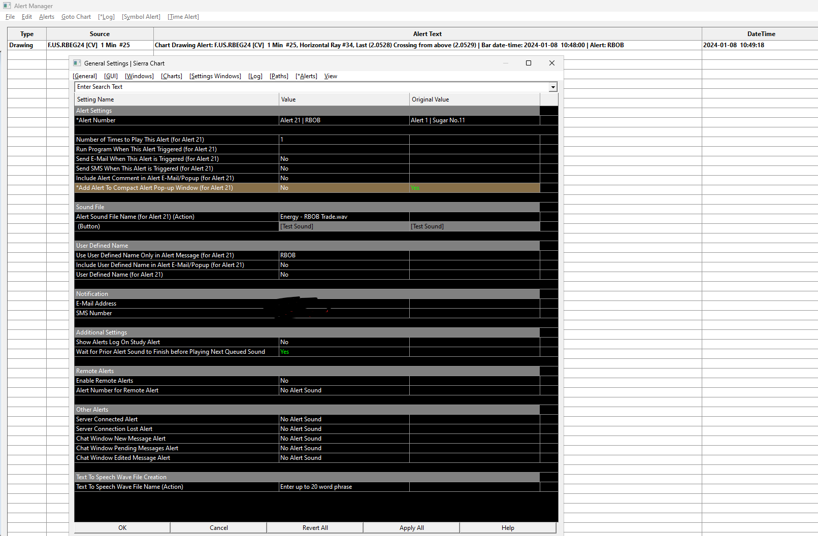

| [2024-01-08 10:52:49] |
| StephenL - Posts: 122 |
I'm having the same issue but I can't figure out what I have selected that causes it to keep popping up. Is there any other setting it could be coming from? I added a screenshot of my settings. Thanks Date Time Of Last Edit: 2024-01-08 10:54:09
| [2024-01-08 17:40:08] |
| John - SC Support - Posts: 48447 |
You have an alert on a drawing setup on chart #25 for a Horizontal Ray that has an ID of 34. Are you having the Alert Manager opening when the alert is true? For the most reliable, advanced, and zero cost futures order routing, use the Teton service: Sierra Chart Teton Futures Order Routing |
| [2024-01-08 21:25:51] |
Yea the alert that I have attached to that line is the Alert 21 RBOB shown below. And the Alert Manager will open when that is true.

| [2024-01-10 10:42:44] |
Uploaded.

| [2024-01-10 16:42:33] |
When we use your chart and get the alert for that drawing per your setup, we do not get the Alert Manager coming up. If you try it with this chartbook that you created, do you still get the Alert Manager coming up? For the most reliable, advanced, and zero cost futures order routing, use the Teton service: Sierra Chart Teton Futures Order Routing |
| [2024-01-11 10:19:21] |
Yea youre right and I think I realised the issue. I had insufficient funds in the account to send a text on the alert trigger and this seems to be what was causing the Alert Manager to pop up, would that be the cause? I unchecked it when I sent it to you thinking it was unrelated.
| [2024-01-11 16:37:12] |
We would expect the Message Log to come up if you did not have the funds to send the SMS, but this is possibly the reason for the Alert Manager. Were you able to verify it on your end?
| [2024-01-16 13:00:14] |
Yea, I can verify it was the lack of funds in the Send Text selection that caused it. Thanks for helping out
