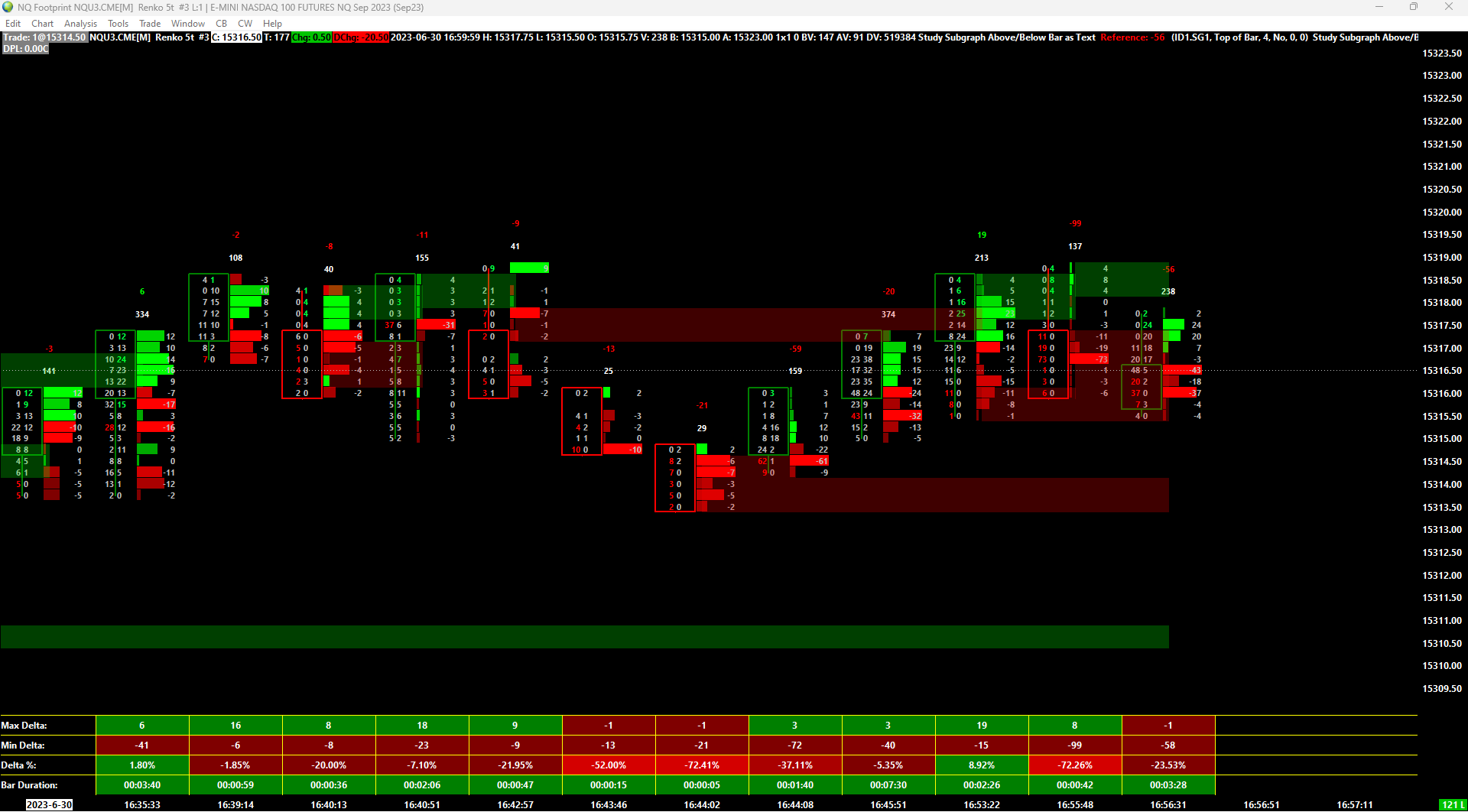

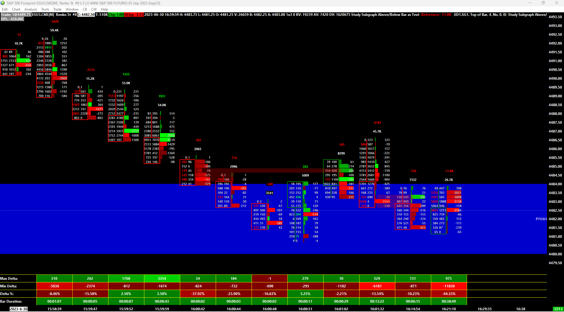

Hi i have a set footprint on E-MINI SP with renko 5t and i don't have problem, but if copy the same chart on NQ the renko it looks like this, without contracts, see photos.
What is the problem on NQ chart?
Thanks for help

That may not be wrong what you see. However, just make sure there is no filtering set:
Chart Settings: Volume Filter (Chart >> Chart Settings >> Data Limiting >> Volume Filter Settings menu)
For example, this is what we see for a portion of that day, in US Eastern Time:
https://www.sierrachart.com/image.php?Image=1688216162215.png

This has nothing to do with the Numbers Bars study itself. It is the fact that you are using a 4 Tick Renko and that is causing the bars to have very little data for each one. You would want to increase the size of the renko bars in order to get them to "look" similar to what you see for the ES.

This is definitely related to the Bar Period you are using and not the Numbers Bars study itself. The Numbers Bars study looks fine the way you have it setup. But there simply is not at much trading occurring to cause the NQ to generate a new bar, so the same settings do not work between ES and NQ. It may look fine as a bar, but when you are looking at the underlying data, it is not as filled out.
