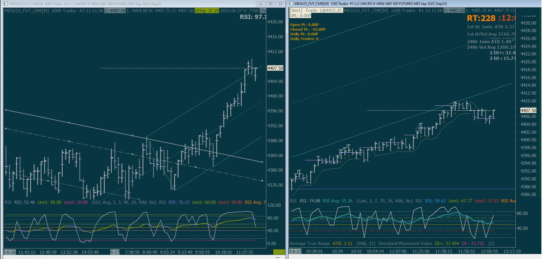

I am using multiple frames to trade and I have noticed a huge offset between the original chart where I drew the drawing (pitchfork) and the second chart where the drawing is copied to.
charts are using tick charts.
The original chart is 5 times bigger than the secondary chart.
In the attached picture you will see how price is within the pitchfork and the last 3 bars closed above the upper Medium line parallel of the pitchfork.
On the smaller chart, you will see how price is completely outside of the pitchfork, and below the the lower medium line of the pitchfork, so there is an offset of the whole width of the pitchfork drawn on the original chart.

imageoffseet between higher frame and lower frame.jpg / V - Attached On 2023-06-27 17:25:46 UTC - Size: 416.18 KB - 207 views

These are different timeframe charts, so you can not make this comparison. Refer to the following (and the section below it):
Lines/Rays or Other Chart Drawings Move After Drawing Them: How Chart Drawings Are Mapped Between Bars with Different Starting Date-Times
