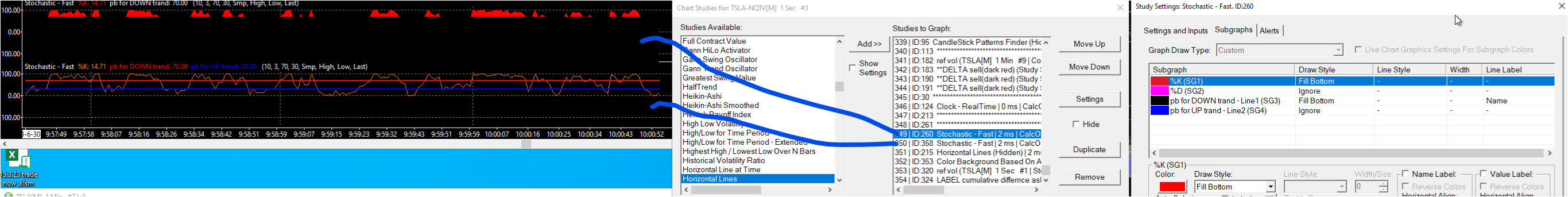

hi,
i mange to get the upper color that i need(red color in pic).
but i didnt mange to get the blue background (betwwn sg1 to sg4)...
what i need to check in the draw style for sg1 sg3 sg4 to get what i need ?
regards.

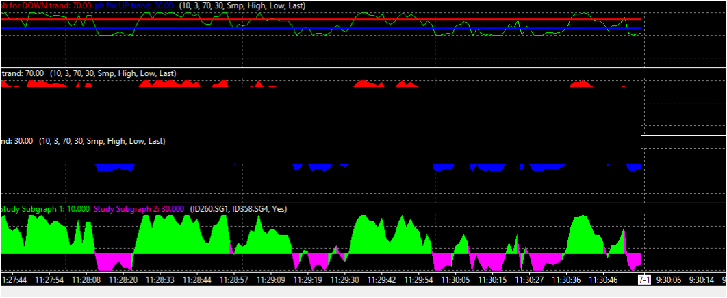

User278398 - Posts: 296
region 1: stoch fast
region2: only the upper fill area (in red)
region3: only the bottom fill area (in blue)
region4: study subgraph reference study
i didnt sucses to get what i need with "study subgraphs reference".
can u send me a study collection which "study subgraphs reference" can combine between region 2 and 3
(i want to display in one region the red area and the blue area) ?
regards.
image1.png / V - Attached On 2023-07-03 08:19:19 UTC - Size: 90.03 KB - 204 views
[2023-07-03 13:44:26]
Sawtooth - Posts: 4361
Change the 'Red' study to Region4
Change the 'Blue' study to Region4
Move both 'Red' and 'Blue' studies below the Region4 study, in the Studies to Graph list.
Move Region1 study below the Region4 study, in the Studies to Graph list.
Note: The position of studies in the Studies to Graph list determines which studies over-print the ones above.

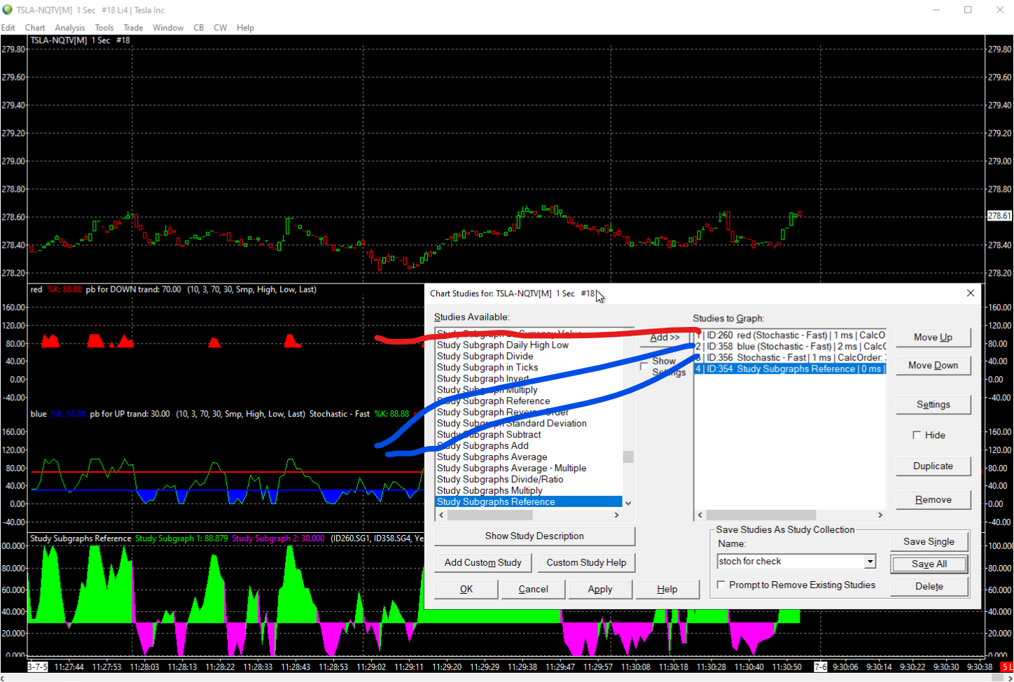

[2023-07-06 10:10:47]
i didnt mange get in one region what u explain to me.
i upload a study collection for your checking.
can u check and fix it that in one region i can see "red and "blue" ?
regards.
attachmentstoch for check.StdyCollct - Attached On 2023-07-06 10:05:17 UTC - Size: 65.3 KB - 249 views
image12345.png / V - Attached On 2023-07-06 10:09:43 UTC - Size: 371.44 KB - 249 views

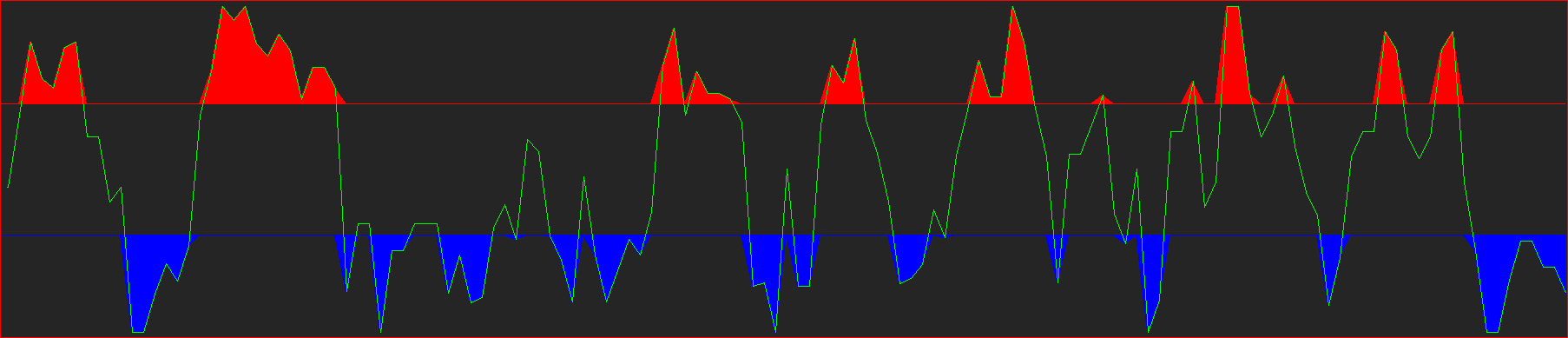

[2023-07-06 16:06:36]
See attached pic.
Is this what you want?
imageStoch fills.PNG / V - Attached On 2023-07-06 16:06:33 UTC - Size: 32.99 KB - 237 views
[2023-07-09 08:09:21]
amazing.
yes
[2023-07-09 14:10:29]
It was more difficult than I thought.
You'll need to add two instances of the Spreadsheet Formula study:
- One to create a %K overbought only line.
- One to create a %K oversold only line.
- Set the Chart Region to same as the Stochastic - Fast study, and Hide these studies.
You'll need to add two instances of the Study Subgraphs Reference study:
- One to fill from the overbought only line to the 70 line.
- One to fill from the oversold only line to the 30 line.
- Set the Chart Region to same as the Stochastic - Fast study.
For an example of the formulas and references, open a blank chart and apply the attached Study Collection.
attachmentStoch fills+.StdyCollct - Attached On 2023-07-09 14:10:19 UTC - Size: 80.53 KB - 366 views
