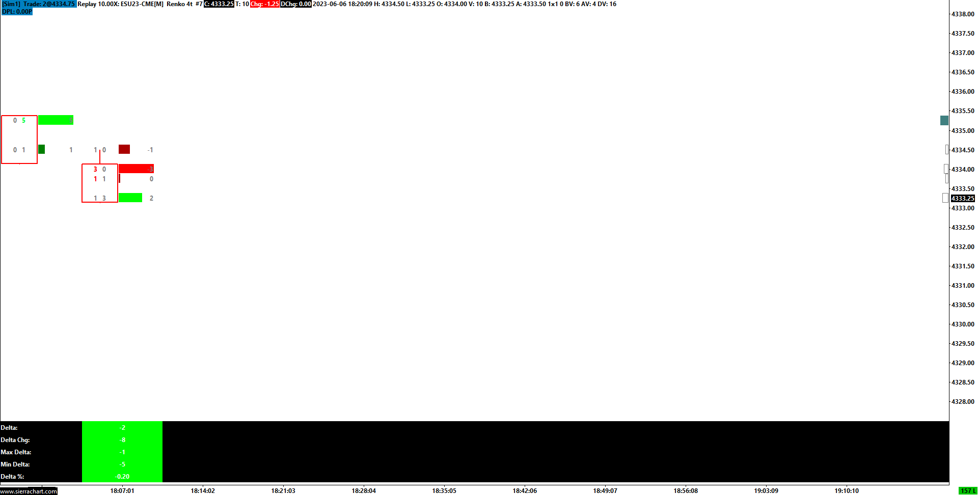

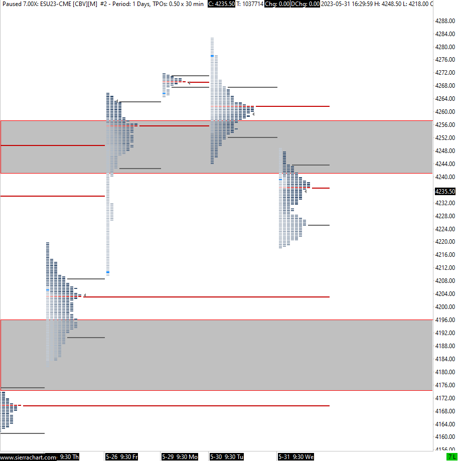

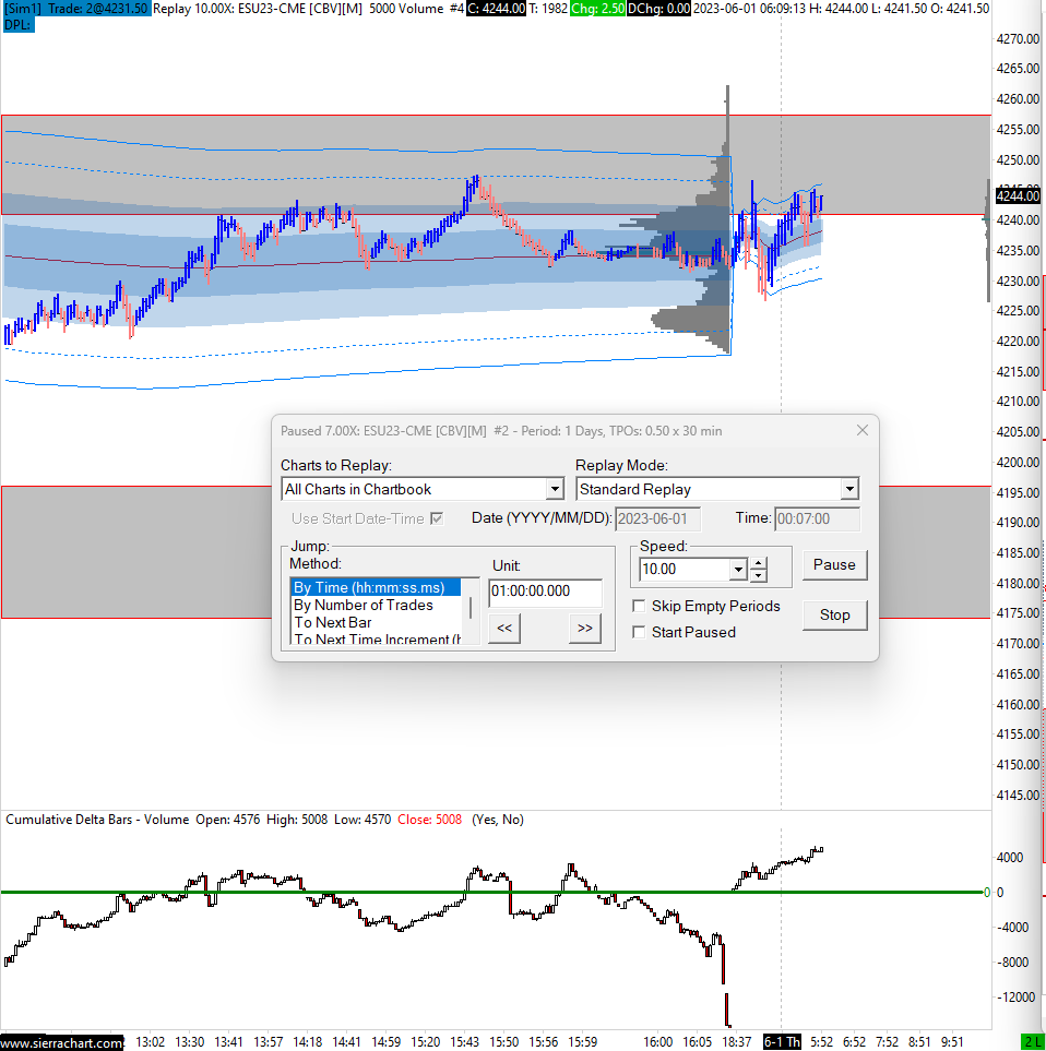

I tried clicking the 'start paused' as requested below however it did not work. Now there is another chart not replaying. It seems to be on paused even though the others are all replaying. Image attached.

1. One of the problems is you are replaying the September contract at a time when it was inactive and instead the June contract is active. To solve this use a Continuous Futures Contract chart:
Continuous Futures Contract Charts
2. The other thing is disable Use Start Date-Time on the replay window and instead follow the instructions here:
Replaying Charts: Basic Chart Replay Instructions
