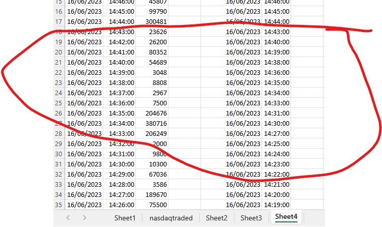

Hope all good there with you. I am picking up some quirks in the nasdaq data. I took a random symbol on a list.
ABEV ( and ABEV-NQTV ), the first three columns on the left are ABEV ( Consolidated Tape Data ), the Next 2 columns are from ABEV-NQTV
What I am picking up is that the Nasdaq symbol is missing bars . These are the same 1 min bar interval settings. and as you are able to see, the Nasdaq symbol starts to skip some minutes. Is this expected behaviour ?

Yes this is expected and for the solution, refer to:
Denali Exchange Data Feed: Nasdaq TotalView Data Feed Notes
There is no difference between the real-time, delayed or historical data. It is all the same other than the delay relative to the current time.
Your questions regarding order routing have no relevancy at all to the data feed. You need to contact your broker.
For the full trading volume, you need to use the US Equities Consolidated Tape exchange.

Why are the minute bars missing ? Is there a setting on my side that I should enable to see minute bars even if zero stock is traded. If you look at the picture. The Nasdaq feed on quite a few stocks which I checked does skip a few minutes in between, and shows up as missing bars for that particular minute.
How does this work ?
[2023-06-20 13:50:48]
Sierra_Chart Engineering - Posts: 25005
The bars are missing simply because there was no trading on that particular exchange. Have a look at this setting:
Chart Settings: Include Columns With No Data (Chart >> Chart Settings >> Bar Period >> Chart Bar Settings menu)

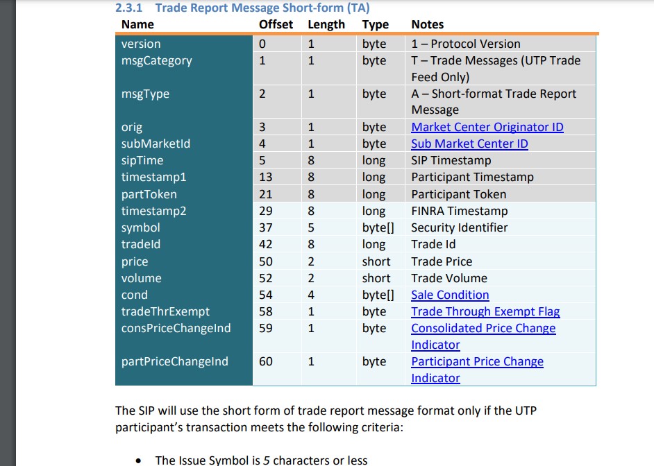

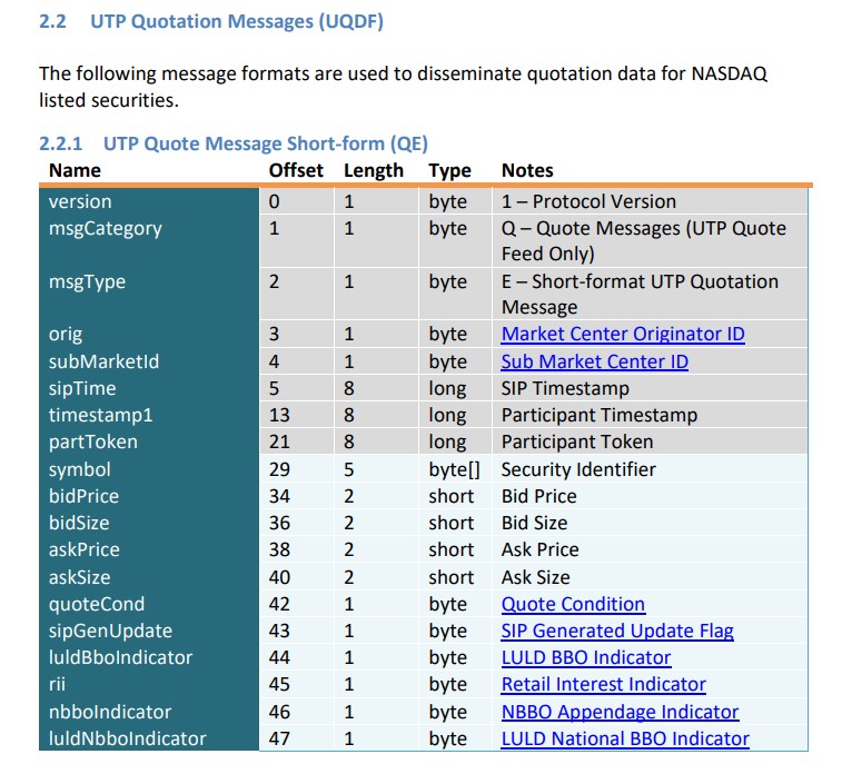

With regards to the Nasdaq feed. My research indicates that you are using this feed specification
https://www.utpplan.com/DOC/UtpBinaryOutputSpec.pdf#page=43
they have the following fields called participant token and retail interest indicator and then related fields such as participant update values If you review the sections.
My understanding is that these ids reflect the marketmaker or dealer principles. and Retail interest is if the retail accounts are trading .
Have you had the opportunity to evaluate this data and is any of this available in sierracharts as a field .
For the NASDAQ TotalView data feed, that is completely different than UTP.
We do have the UTP data feed as well, but we would have to look at those fields later on. Not now.
