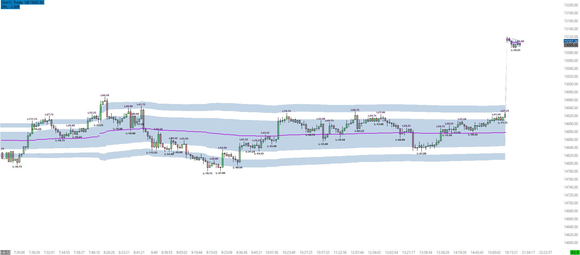

I tried to duplicate a chart to another chartbook and when I did so, the data in both charts was distorted, shifting roughly 163 points downward. This is on the NQU3. It seems that the start of the evening session is at the correct price on the chart, according to the quote board for the symbol.
I'm not sure what would have changed with my duplicating the chart to another chartbook, but I want to make sure that there is not an error in a data file that is causing an issue and could possibly continue moving forward.

It looks like your contract rolled over and that you have a Continuous Futures Contract without Back-Adjustment. So the latest contract is the higher price and the previous contract is the lower prices. Refer to the following:
Continuous Futures Contract Charts
