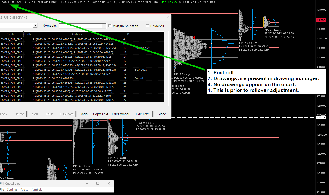

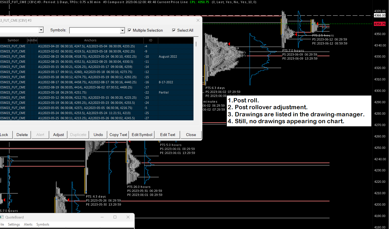

When rolling futures contracts the chart appears to lose the drawings. This is not a case of the drawings being in the wrong place but completely missing. The chart has no drawings after the roll.
The drawings are still present in the "chart drawing manager", however they do not appear on the chart after the roll, before or after the "rollover adjustment" is made.
I can roll back and the drawings reappear.
Please let me know what is needed to correct this issue.
imagebefore roll.png / V - Attached On 2023-06-12 16:17:25 UTC - Size: 110.26 KB - 239 views
imageAfter the roll.png / V - Attached On 2023-06-12 16:17:33 UTC - Size: 132.39 KB - 162 views
imageAfter adjustment.png / V - Attached On 2023-06-12 16:17:43 UTC - Size: 129.51 KB - 225 views

Refer to the following:
Chart Menu: Update Chart Drawings to Current Symbol (Chart menu)
Note that another option is to display the drawings for different symbols for the chart. Refer to the following:
Chart Settings: Show Chart Drawings For Different Symbols (Chart >> Chart Settings >> Chart Drawings menu)

When you roll over a chart, you should get a window that lets you select the new contract. On that window is an option for "Also Rollover Chart Drawing Symbols". If this is enabled, then the drawings will get updated with the new symbol. It's most likely that this is enabled for some of your charts, but not others.
It's either that, or the option for "Show Chart Drawings for Other Symbols" is set to "Yes".
