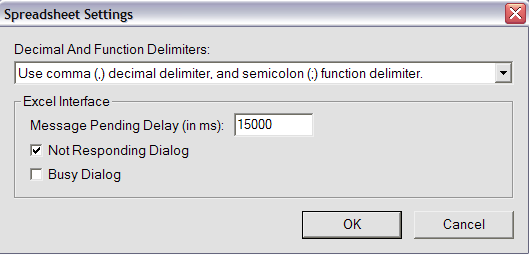

I've discovered a little issue. Please see the attached chartbook and spreadsheet.
Sometimes, in the Sheets 2, 5, 8 and/or 11, I get a #VALUE! message in cells K3, K4 and/or L3, L4 (and corresponding in cells M till Q).
This seems to have to do with the cells W3, W4 and/or X3, X4. Hope you can figure out what is causing this!?
As additional information, please see the attached screenshot for my Spreadsheet Settings.
Please let me know here about further steps. Thank you!
Date Time Of Last Edit: 2014-07-03 10:14:15
Private File
Private File
imagespreadsheet settings.png / V - Attached On 2014-07-03 10:11:50 UTC - Size: 12.38 KB - 558 views
[2014-07-04 03:36:01]
We will look into this.
