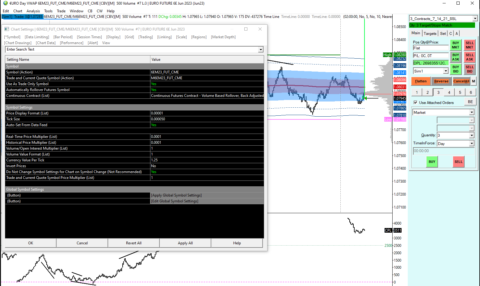

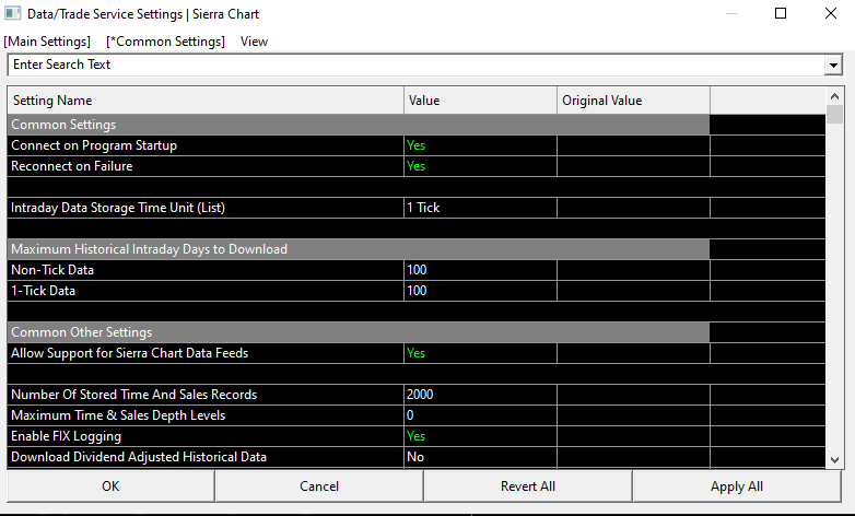

Hi !
I am charting 6E but executing on M6E.
Please see attached settings and error log rejecting my orders.
Thanks in advance
image6E_settings.PNG / V - Attached On 2023-05-31 09:36:28 UTC - Size: 111.38 KB - 237 views
imageFIXLogging_YES.PNG / V - Attached On 2023-05-31 09:36:33 UTC - Size: 21.05 KB - 230 views
imageM6E_order rejected.PNG / V - Attached On 2023-05-31 09:36:48 UTC - Size: 20.49 KB - 240 views

Refer to the section here regarding this:
Chart Settings: Trade and Current Quote Symbol (text box) (Chart >> Chart Settings >> Symbol >> Symbol menu)

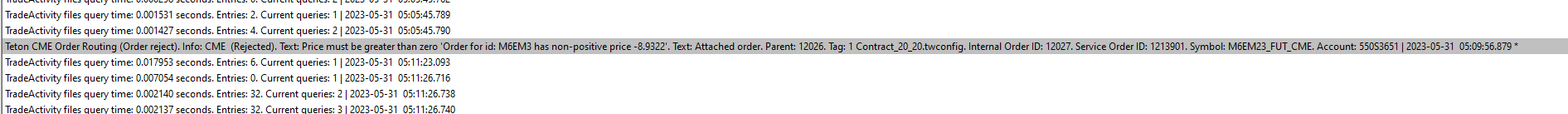

David Abrahams - Posts: 18
I have checked setting as suggested - note I have no problem charting ESM23_FUT_CME but executing on MES23_FUT_CME.
See attached error log and below text
eton CME Order Routing (Order reject). Info: CME (Rejected). Text: Price must be greater than zero 'Order for id: M6EM3 has non-positive price -18.9323'. Text: Attached order. Parent: 12037. Tag: 1 Contract_20_20.twconfig. Internal Order ID: 12039. Service Order ID: 1215026. Symbol: M6EM23_FUT_CME. Account: 550S3651 | 2023-05-31 10:30:12.791 *
Notice: Stop Attached Order was rejected and is being resent as a Market order. | Symbol: M6EM23_FUT_CME | TradeAccount: 550S3651 | InternalOrderID: 12039 | ServiceOrderID: 1215026 | Current Status: Error | 2023-05-31 10:30:12.791 *
Order cancellation failed | Teton CME Order Routing (Order cancel reject). Info: Order cancellation failed | Order Cancel Reject. Text: This order is not in the book 'Order: 8815816516582 SenderCompID: J4S2XH'. Text: Attached order. Parent: 12037. Tag: 1 Contract_20_20.twconfig. Internal Order ID: 12039. Service Order ID: 1215026. Symbol: M6EM23_FUT_CME. Account: 550S3651 | 2023-05-31 10:30:12.928 *

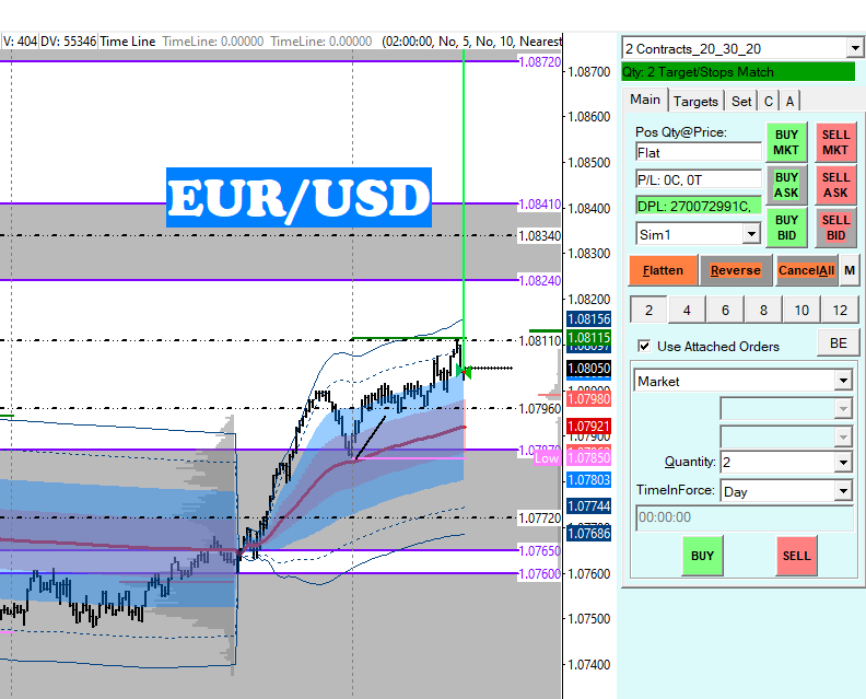

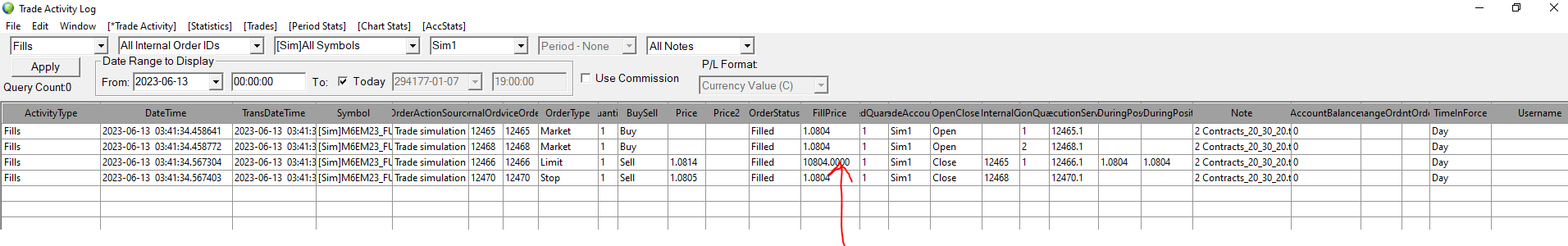

Hello again..
I have followed the instructions as above.. however in SIM I still get all these wierd situations when using "attached orders"or if trying to add a stop or limit order to an existing market order - it will accept a single market order with no attacvhed stop/limit order.
My attached orders work fine in SIM and live on other symbols.
Note the error in the price of the limit order in the attached screenshot
Thanks in advance

[2023-06-13 15:36:26]
Sierra_Chart Engineering - Posts: 25005
Did you use the recommended settings as explained here:
Sierra Chart Teton Futures Order Routing: Using Trade Symbol
What is the Trade Symbol Price Multiplier set to?

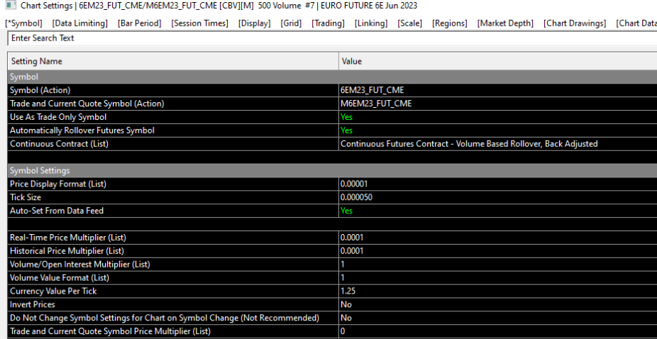

[2023-06-13 16:05:17]
Yes, correct. see attached screenshot.
Trade and Current Quote Symbol Price Multiplier (List) is: 1
It seems to only be an error while using the Trade as Current Quote Symbol View Mini Chart, execute on Micro contract.
Is there a fix for this please ?
imagecht_settings.PNG / V - Attached On 2023-06-13 16:03:36 UTC - Size: 92.97 KB - 231 views
