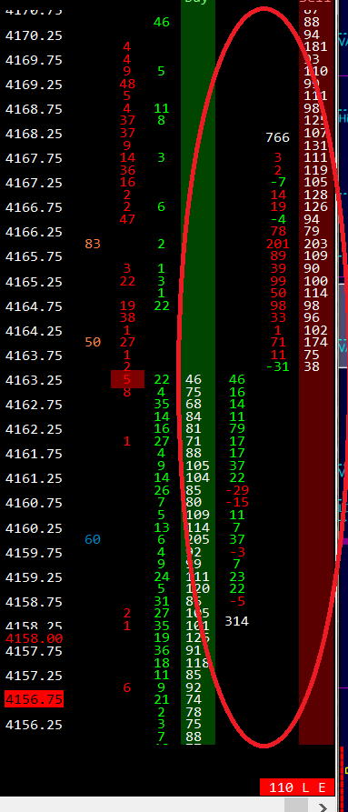

I have a problem with my DOM when it comes to replay.
My only way to have access to the resting and pulling/stacking of bid/ask is to let my computer run constantly to have the data to be replayed. If my computer was not live the day I want to replay I will only have the market orders in the DOM.
Could someone help me ?
I already activated "support downloading historical depth data" in general settings.
I circled in red the data I need to have on replays (I do have them when it is live).
Thanks a lot

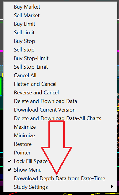

Go through the instructions for getting the Historical Market Depth Data at the following link:
Market Depth Historical Graph: Downloading Of Historical Market Depth Data
If you do not automatically get the data you need, then follow the instructions in that section for right-clicking and selecting "Download Depth Data From Date-Time".

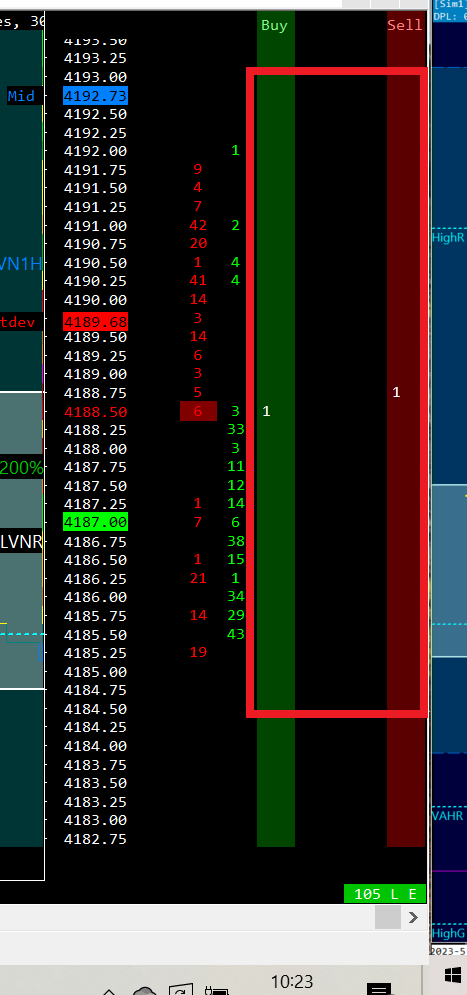

Thanks for your message. I re-went through all the process you mentionned and everything is activated properly.
Let me insist on the fact that I have everything I need when I am live (pulling, stacking and resting orders).
The only problem is when I want to replay a session I did not record by being live.
Example : I was live on the 25th of may, if I replay it I will have all the data I need.
I was NOT live on the 24th of may, if I replay it I will NOT have all the data I need.
See here : https://www.sierrachart.com/image.php?Image=1685090472789.png
Also, I tried to manually load the market depth data from the date I want to be replayed but nothing changes.
Hope you'll find a solution :)
Thanks a lot.

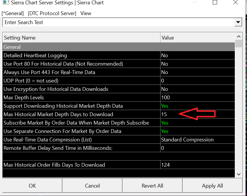

Check the following setting and make sure it is large enough to cover the time period for which you are wanting to download the Market Depth data:
Sierra Chart Server Settings: Maximum Historical Market Depth Days to Download (Global Settings >> Sierra Chart Server Settings >> General >> General)
Also, if you are using a Continuous Futures Contract, then you will not get any data for prior contracts. You would have to open a specific prior contract and then download any missing Market Depth data for that particular contract, then you will be able to view it in the Continuous contract.
[2023-05-26 17:33:03]
User810899 - Posts: 10
Unfortunately did the change and still not working. Entered 15 historical days to load for market depth. I took the 23rd of may to test and does not work so contract rollover does not seem concerned either.

This last image has us a bit confused. If the replay is running when you took this image, then we are not seeing the Market Depth data in the DOM. But you state that you do see the "resting liquidity above and below my price".
[2023-05-26 22:16:33]
When I talk about market depth, it is the study on my footprint ("Market depth historical graph"). Nothing on the DOM.

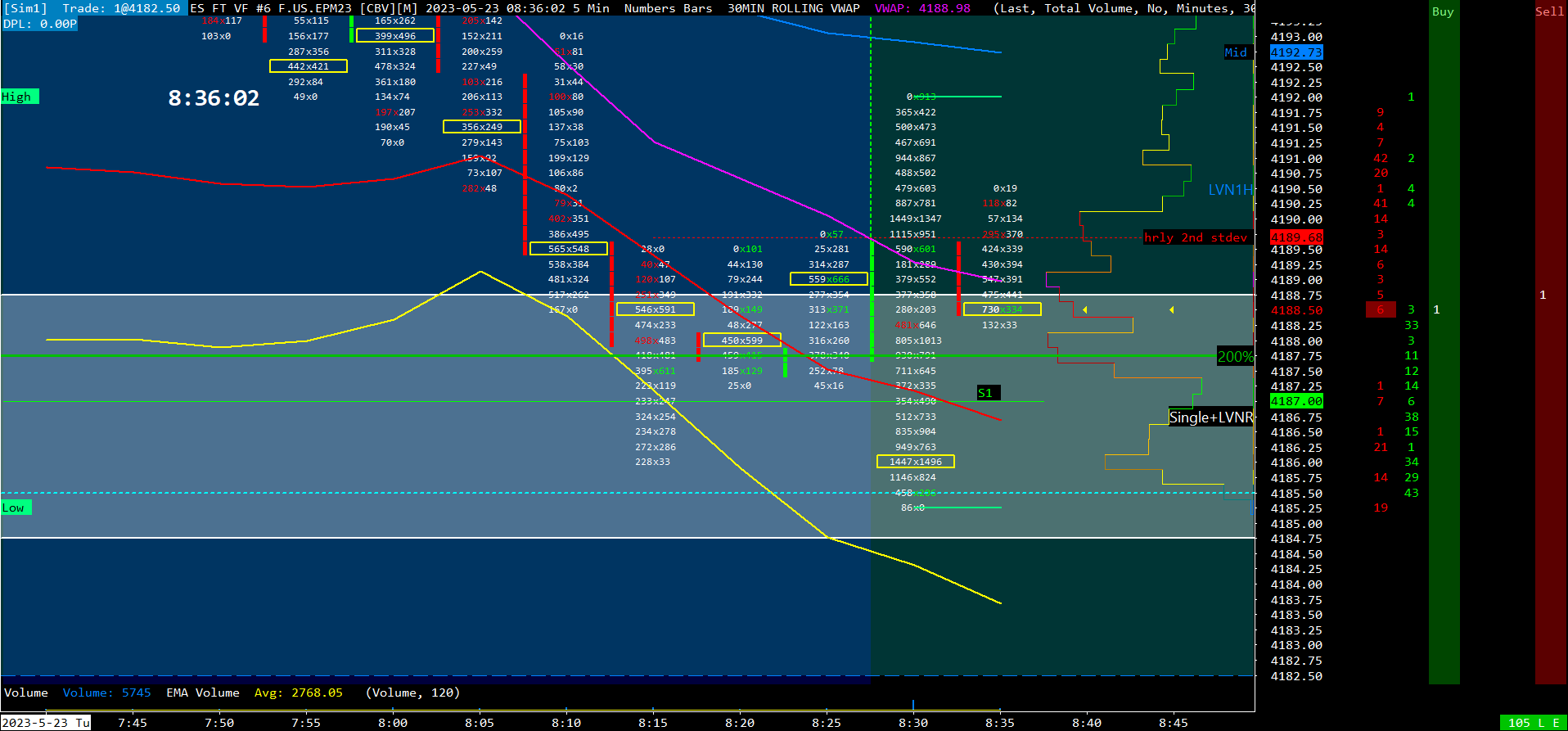

I just add one last screenshot though to prove that I did what you suggested and market historical depth is indeed loading when I open Sierra Chart.
One distrubing thing though, when I open the market depth data file (in local disk C), the files that are complete because I was in front of my computer are MUCH bigger than the size of the files that auto download and I haven't recorded by being live.
imageSierra5.png / V - Attached On 2023-05-26 22:14:15 UTC - Size: 14.39 KB - 378 views
[2023-05-26 22:20:07]
A little more evidence of what I did attached ;)
imageSierra4.png / V - Attached On 2023-05-26 22:19:04 UTC - Size: 20.85 KB - 417 views
imageSierra3.png / V - Attached On 2023-05-26 22:19:31 UTC - Size: 36.52 KB - 362 views
[2023-05-27 13:23:21]
Found a solution !
Went to my file C:\SierraChart\Data\MarketDepthData
Deleted all the files.
Launched sierra.
Nothing appeared yet.
Clicked on "download depth date from date/time"
Bingo
