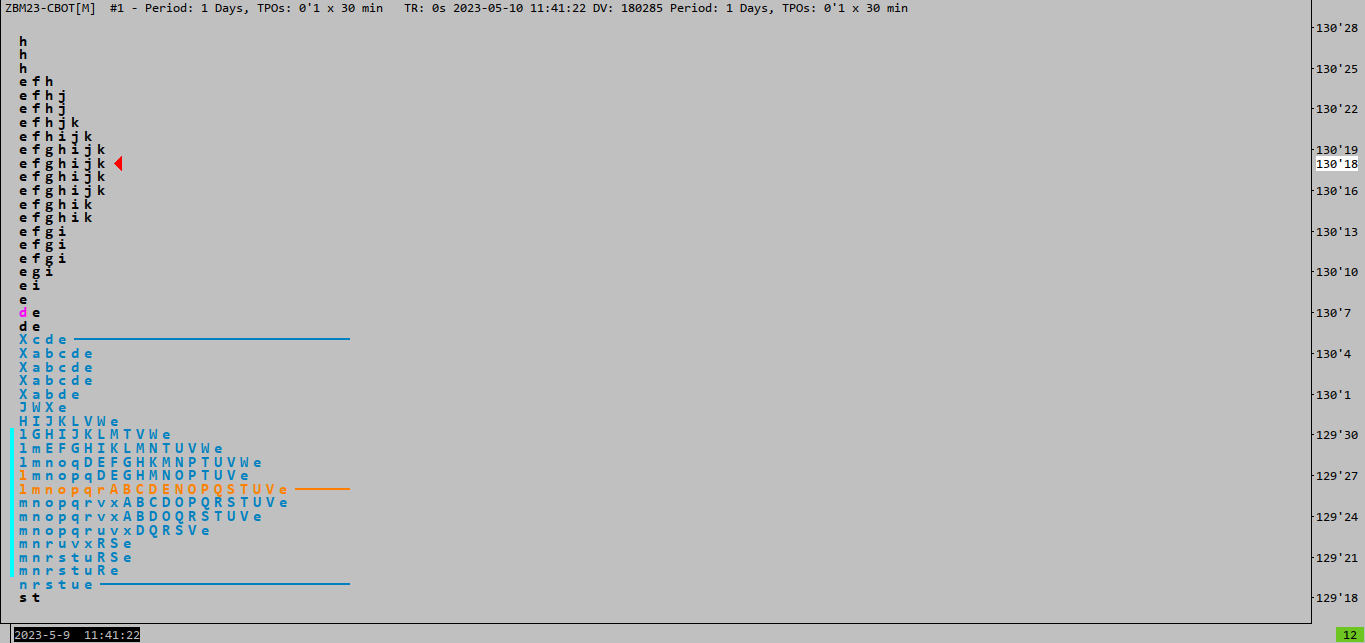

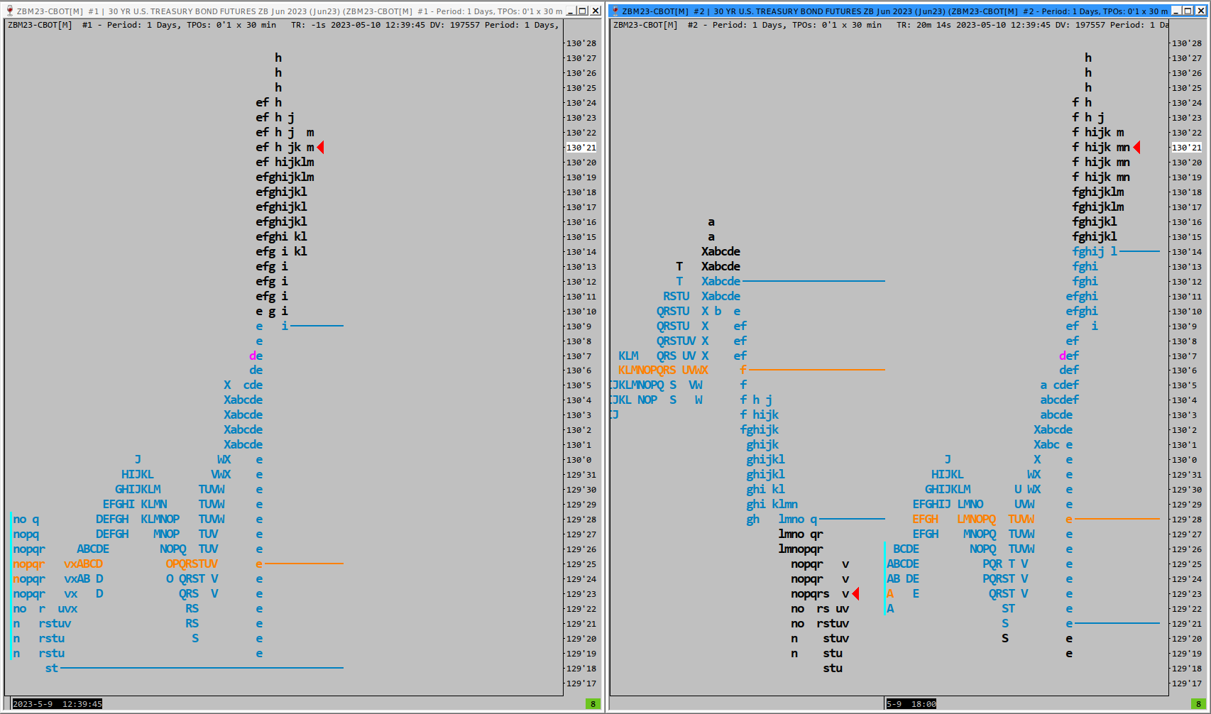

I am having a problem with the TPO profile study, when I set the profile to display data using the 'One Period of Fixed Time Length at End' option (ln:4):
When displaying a chart with this option, then right-click on the chart and select the 'Letters/Blocks in Own Column' or 'Letters/Blocks in Own Column And Standard Profile', the chart temporarily shows the separate columns, but automatically resets back to normal profile mode (no own columns) every time, when the chart updates (new tick).
I tried with Daily, Weekly, etc options and happens with all of them.
Also when selecting this option (One Period at End), the time scale of the chart displays very strange date/time stamps that do not correspond to the subperiods used on the TPO chart and constantly changes (increases) for the same day (when using 30min subperiods, the time scale shows a timestamp that does not follow the 30min increment - like '2023-5-9 10:34:24' etc.)
Can you please take a look at this and let me know how can I fix this?
Thanks in advance.

Please get us a chartbook that shows the issue and hopefully we will be able to reproduce it. Follow these instructions to get us the chart:
[2023-05-10 15:42:58]
ticinotrader - Posts: 431
Hi John,
Please see the example chartbook attached.
Also here is a link with an example screenshot:
https://www.sierrachart.com/image.php?Image=1683733282430.png
Thank you.
attachmentTPO-own-profile-error_v2497.Cht - Attached On 2023-05-10 15:42:51 UTC - Size: 4.01 KB - 471 views
[2023-05-10 15:54:55]
The issue is that with this particular profile type, it is constantly redrawing it. Therefore, when your Input for "Default Column Display Style" is set to "Standard Profile", it keeps defaulting back to that setup since that is what is set. The way around this is to change that Input to one of the other options to display either the Single Column data or both.
As to the time stamp, it is updating to the current time when it is redrawing the chart. Again, this is just a "side effect" of using this particular Profile Period.

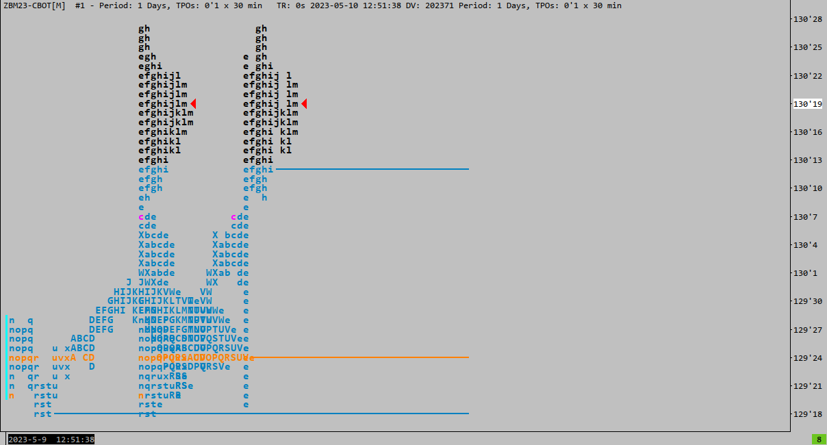

But I am not sure about the timestamp issue:
I now understand that it always displays the last trade's timestamp when the letters are displayed in own column in a single profile view, but there is an inconsistency between how this is handled when there is only one profile displayed (the example chartbook I attached) vs when a 'normal' (multiple days are displayed) TPO chart's profile is set to display letters in own column.
Please refer to the attached screenshot for comparison.
On the left, the TPO study is set to display one period, while the profile on the right is showing multiple profiles.
In my opinion, displaying the start time of the profile (as displayed on the right chart) is more useful, because it allows to see the session start time, the profile is based on (is it full session or day session based).
Can this be set to always display the session start time, the profile is based on? Similar to how traditional profiles in SC work?
I've also run into another issue when displaying a single profile:
When Default Column Display Type (ln:127) is set to 'Letters/Blocks in Own Column And Standard Profile' AND the next option (ln:124) 'Standard Profile on Left' is set to Yes, the two profiles will overlap each other, as you can see on the example below:
https://www.sierrachart.com/image.php?Image=1683737500525.png
Thank you for your advice in advance.

[2023-05-11 05:01:38]
We will look these over, but some features of TPO profiles are not going to be supported with this particular period type. Allow many weeks. We have a very heavy workload.
Date Time Of Last Edit: 2023-05-11 05:02:13

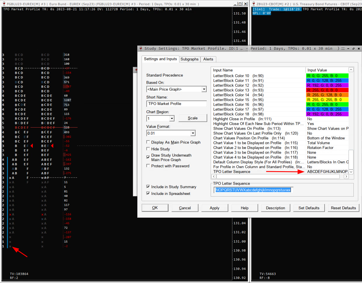

Dear Support,

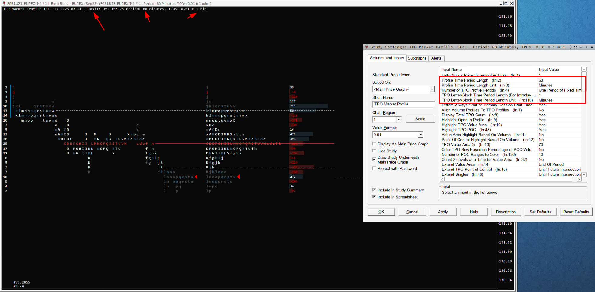

I am writing to report two extra issues just FYI - related to the 'One Period of Fixed Time Length at End' option of TPO profiles:
Issue #1: profile does not reset at the end of the current period:
When the One Period of Fixed Time option is enabled and a non-standard time period/subperiod is used for the profile, the profile does not reset at the end of the previous period, but keeps adding new TPOs to the profile - creating a 'rolling' profile that always displays a certain number of TPOs.
Attached is a screenshot of a TPO profile where:
- 'One Period of Fixed Time Length at End' option is used
- Profile time period length is set to 60 minutes
- Letter/block time period length is set to 1 minute
You can see this based on the chart header information: 11:00 is already passed but the profile is still developing.
There are always 60x1 minute periods displayed and the profile has a 'rolling' behavior - displaying the past 60 minutes price action counted back from the current minute.
Issue #2: Daily profiles always start with 'x' instead of 'A':
The second chart screenshot shows a TPO profile with the One Period of Fixed Time option enabled. It is a profile starting from 8am CET/Brussels. Although the study is set to use the default sequence of letters (ABCD, etc), the profile starts with a small 'x' instead of the 'A'.
Can you please consider addressing these issues when working on the previously mentioned topics?
Thanks in advance.
image20230821_111014.png / V - Attached On 2023-08-21 09:20:44 UTC - Size: 682.4 KB - 303 views
image20230821_111751.png / V - Attached On 2023-08-21 09:20:52 UTC - Size: 590.17 KB - 343 views
[2023-08-24 12:55:51]
Yes.
Provide us the particular chart for this:
And make sure to set the time zone in the Chart Settings itself.
Instructions to attach:
Date Time Of Last Edit: 2023-08-24 12:55:59

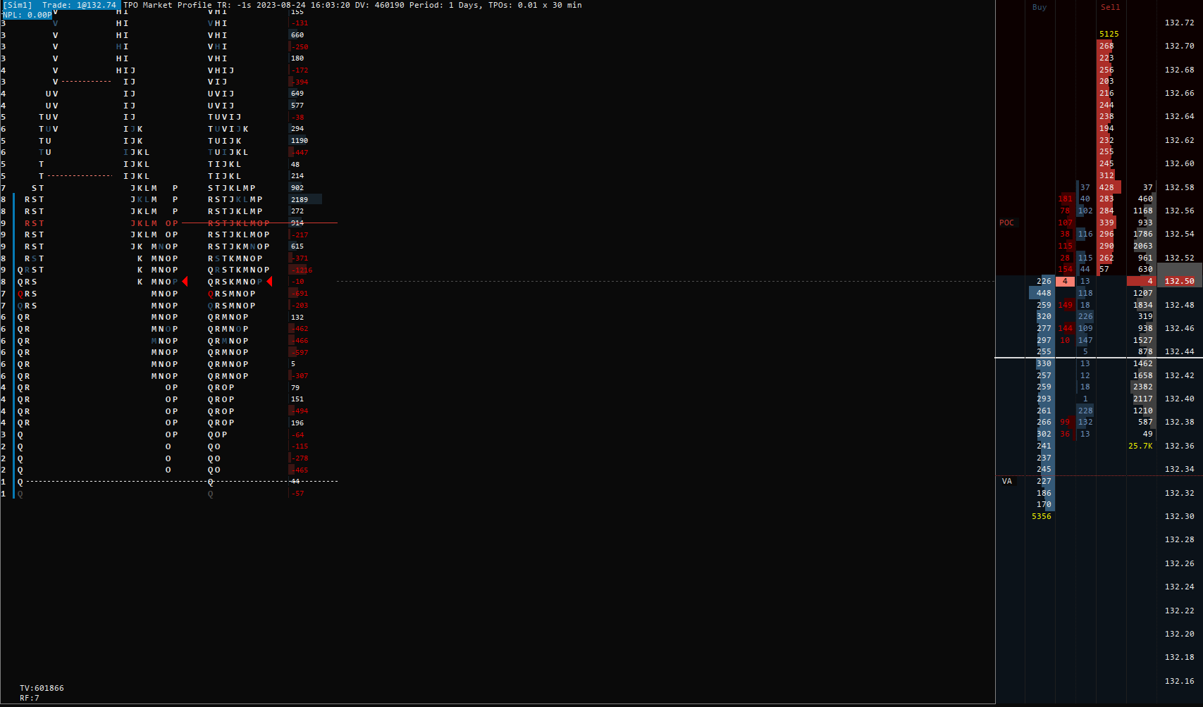

[2023-08-24 14:05:38]
Update:
As I have the chartbook running, the starting letter of the TPO profile changed from 'P' to 'Q'. So the letter are seemingly dynamically changing.
https://www.sierrachart.com/image.php?Image=1692885802400.png

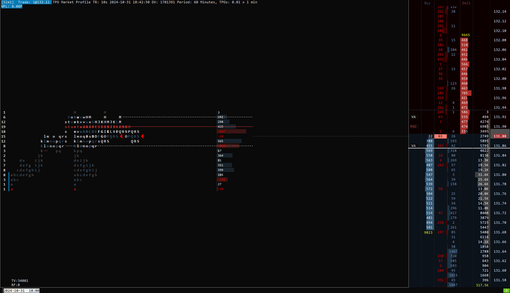

[2024-10-31 17:44:06]
Dear Support,
I was able to fix all issues listed in the previous posts by switching to the One Period From Most Recent Period Start to End profile period.
Issue in post #13 is fixed as well by using the same profile period type in the VbP settings.
The only pending issue that has not changed is (Post #5):
https://www.sierrachart.com/image.php?Image=173039658369.png
