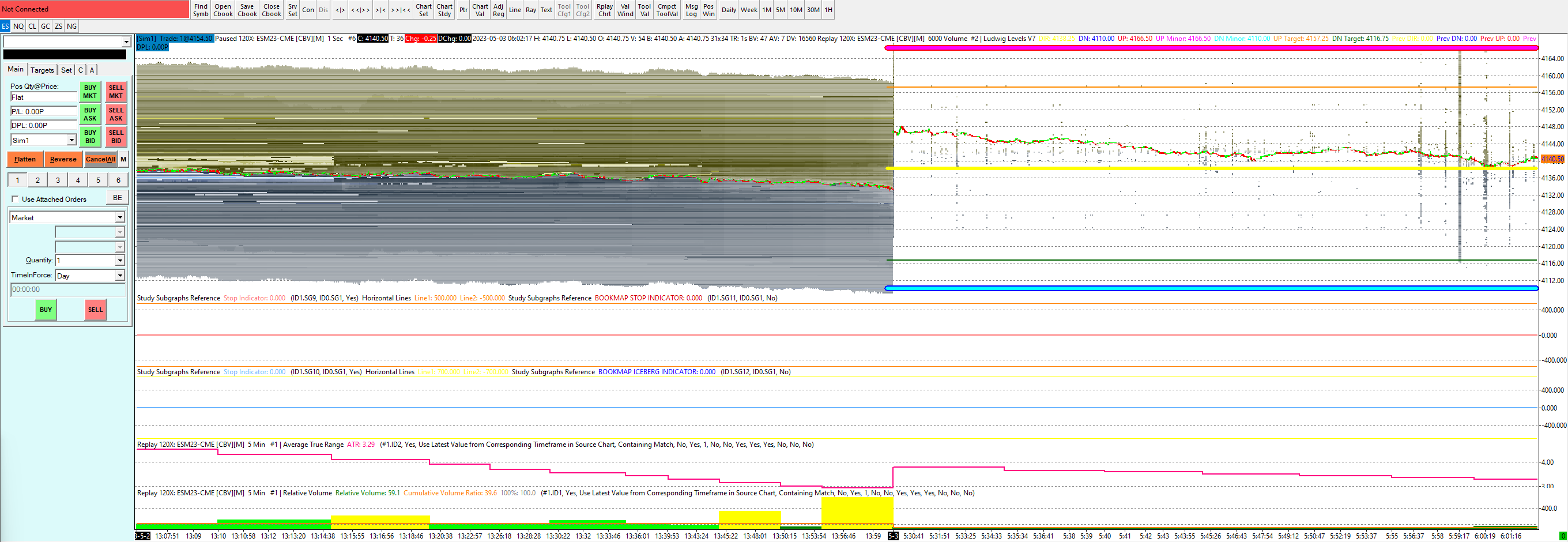

Depth data is loaded on my Sierra and Market Depth Historical Graph shows no issues with the data quality.
However, as soon as a replay is started, depth data becomes inconsistent which can be seen clearly from the attached chart (replay started from 5-3 05:30).
What is the reason for this behavior?

User785723 - Posts: 58
Attached is the screen-record of what happens to the depth data while replaying.
What I replay with speed 10, this does not happen. However, it happens with faster replays. Any clue about this?

Sierra_Chart Engineering - Posts: 25005
We did a replay at 480 times with market depth data, and the market depth data displayed by the Market Depth Historical Graph was 100% identical for replayed data, as compared to the market depth data loaded when using Chart >> Reload and Recalculate.
We do not know what is happening in your case. Maybe there is some out of memory condition occurring or an issue caused by a custom study. Run Sierra Chart in Safe Mode:
Sierra Chart - Software Login Instructions: Using Safe Mode
What is the Replay Mode set to:
Replaying Charts: Replay Mode
Date Time Of Last Edit: 2023-05-09 10:54:34
Did you replay with single or multi chart mode?
I found out that the issue happens only in multi chart replay and wonder if there is any known market depth data issue with this type of replay.

John - SC Support - Posts: 48062
We are not able to reproduce this even with All charts in Chartbook and Accurate Trading System Back Test Mode. Please try running in Safe Mode and see if the problem exists then.
