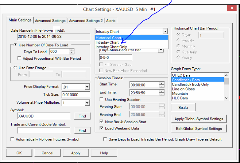

You have probably loaded a historical chart.
Try to open an Intraday Chart or change it in Chart Settings. Look at the screenshot.
imageintraday.PNG / V - Attached On 2014-06-23 12:20:19 UTC - Size: 175.6 KB - 508 views

Julian Nazza - Posts: 12
I've tried that before, and it didn't work. I also tried to load an intraday chart by using the "Find Symbol" menu, and it still did not work. No data and no value axes show in the chart. Daily timeframes and higher display fine. What shall I try next? Thanks.

[2014-06-24 16:48:14]
This is the reason for the problem:
Symbol Error - ES.20140900.CME_Eq is unknown, unavailable, or improperly formatted. CTS FIX: Received market data reject message: (3) Exchange is not allowed for User | 2014-06-24 04:14:41
Contact your broker/trading service and let them know you need to be allowed the exchange for the ES futures.
