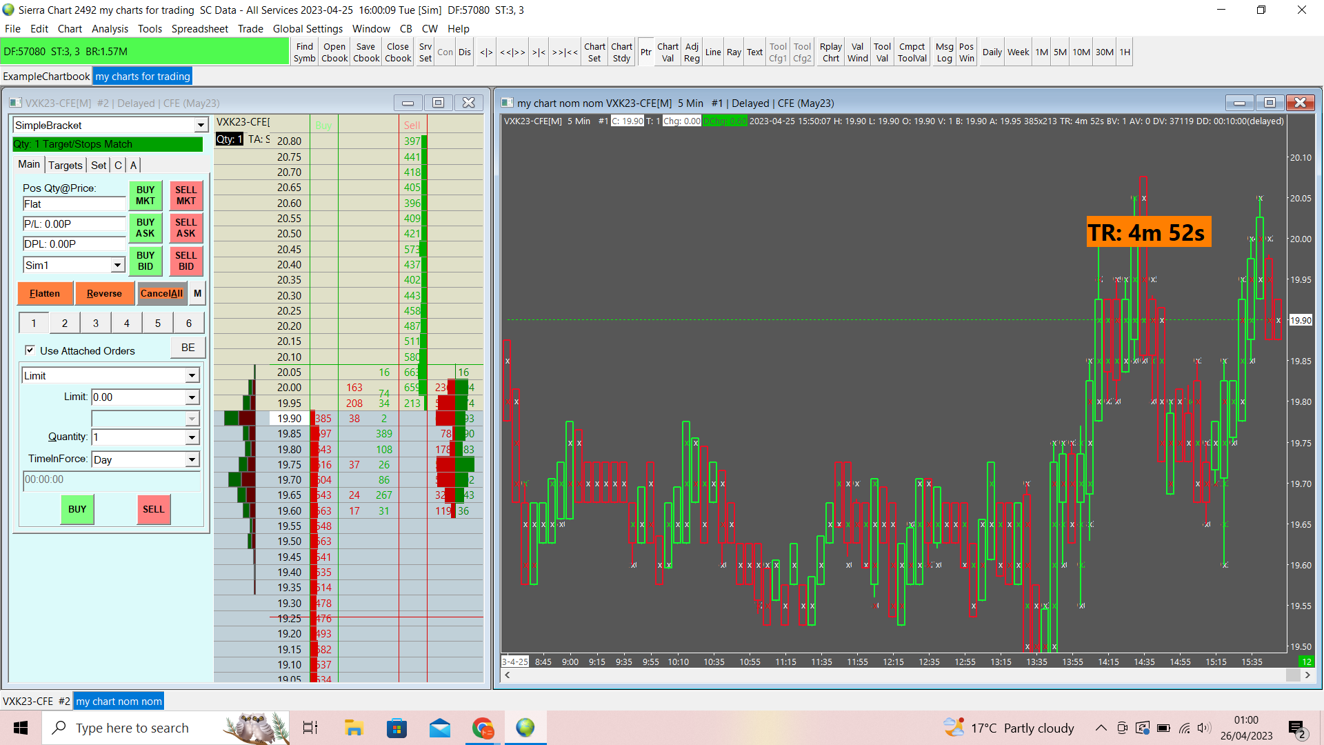

I have 12 package with sierra, my broker is amp futures and i am connected to the SC Data- all services. I am using number bars bid vol x ask vol. I've looked through every thread i can and maybe i'm missing something but im not sure what i need to do to get the number bars showing value. also i am not sure why my feed is delayed either and my 5 minute interval clock also only works once every 30seconds or so.
imageScreenshot (1).png / V - Attached On 2023-04-25 16:00:36 UTC - Size: 235.62 KB - 438 views

As to the Numbers Bars, you should not have an issue with this. Please give us an image of what you are seeing by following these instructions:

thank you, yeah i connected my account and that is no longer an issue and it stopped lagging the timer. as for the screen shot i hope this is better.
https://www.sierrachart.com/image.php?Image=1682450979610.png

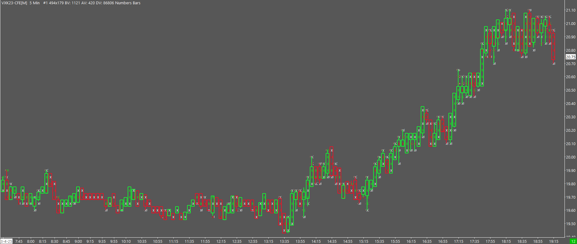

It is just a scaling issue. You need to expand your time scale so you can view the numbers. Use the "Page Up" key to do this.
