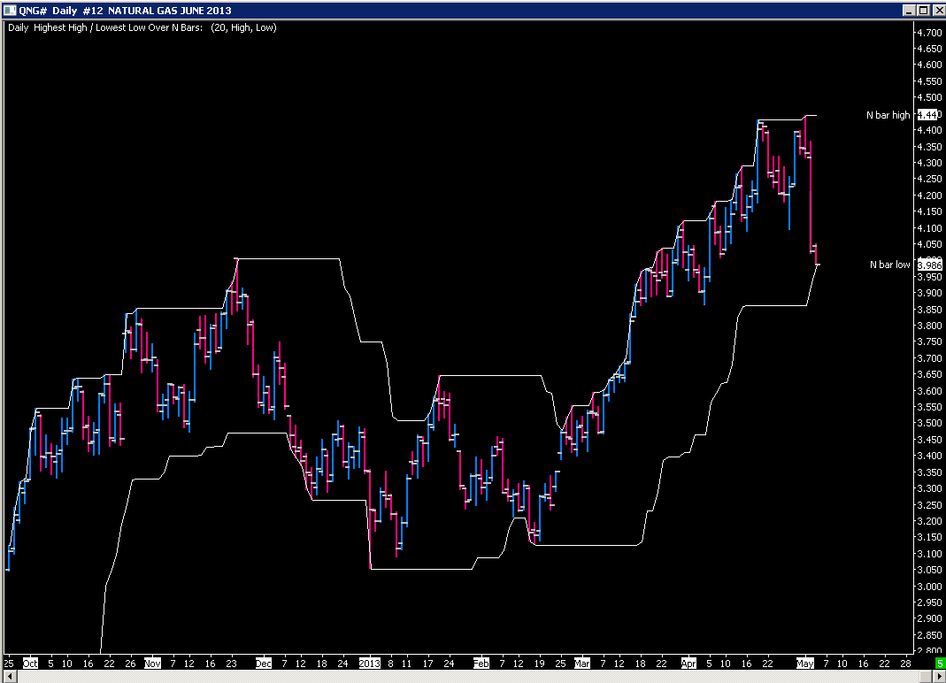

On the above study, I would expect it to plot a single horizontal line. Instead, it appears to calculate what the prior N bar high / low would have been for each bar on the chart.
I asked about this on another thread, Drawing line at all time high - performance issue and was told:
"This problem will be resolved in the next release."
I have installed the new release today, and the lines still plot multiple values. (ie a different value for each bar displayed on the chart, not a single value for the highest high (lowest low) of the prior N bars from current bar. Will this be fixed, or have I misunderstood how the study is meant to work? How can I achieve the desired effect of 1 line?

[2013-05-03 09:04:33]
T44 - Posts: 363
I'd have expected a single line at 4.44 and 3.986. I do not know why it is calculating on prior bars and would like a way to turn this off.
Thanks.
imageSC_nBarHighLow_example.png / V - Attached On 2013-05-03 09:04:29 UTC - Size: 33.07 KB - 973 views
[2013-05-03 13:16:25]
This study does not do what you want. You would have to custom program what you need. Please see:
