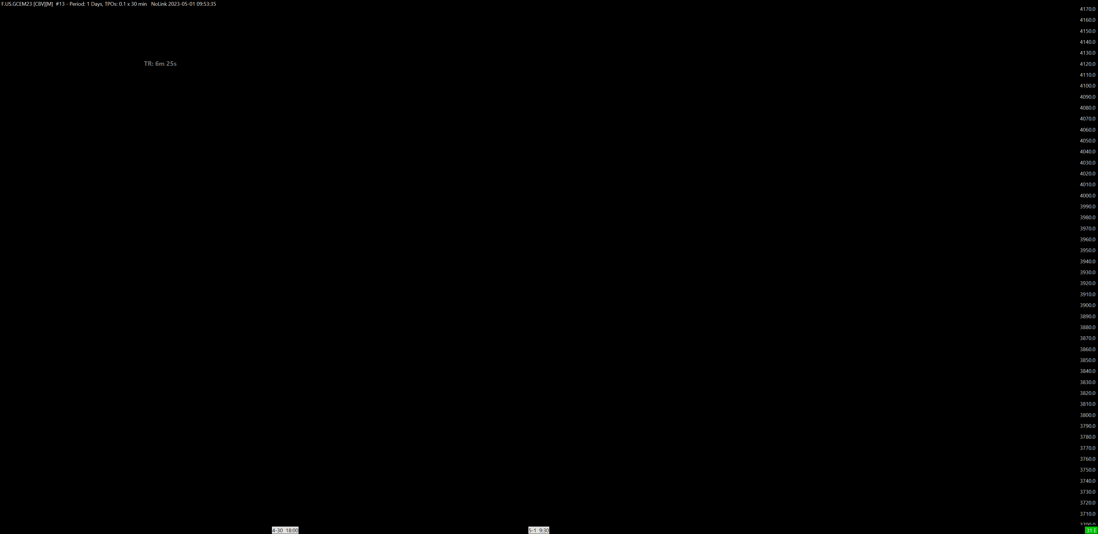

| [2023-05-01 13:54:30] |
| Mustang77 - Posts: 122 |
Can you please give us a screenshot of what you are seeing by following these instructions:
https://www.sierrachart.com/image.php?Image=168294921737.png |
| [2023-05-01 15:31:37] |
by the way, its not just TPO chart, even candles charts dont work when i copy them over to another chartbook and change the symbol
| [2023-05-01 16:25:24] |
Whats strange is that i have 4 chartbooks, in each chartbook i have some charts. There is only one chartbook, when i copy charts from it, and then change the symbol, it works fine. All the other chartbooks, if i copy charts from them, and change the symbol, it does not work. Problem for me is that the charts that i want are in the chartbooks that dont work when changing symbols... |
| [2023-05-01 21:05:14] |
| John - SC Support - Posts: 48527 |
GC trades at about 2000, but your chart is displaying around 40000. Set the Scale to "Automatic" if it is not already set this way and then reset the scales. Refer to the following for how to do these items: Chart Scale and Scale Adjusting: Opening the Scale Settings Window for the Main Price Graph Chart Scale and Scale Adjusting: Automatic (Scale Range) Chart Scale and Scale Adjusting: Resetting the Scale For the most reliable, advanced, and zero cost futures order routing, use the Teton service: Sierra Chart Teton Futures Order Routing |
| [2023-05-02 10:43:32] |
Not correct, prices shown on the screenshot you asked for are not 40000, this is not a problem with scale... the price shown is 4000, and thats ES prices, because i copied the ES chart and when i changed to GC symbol, it changes the symbol but it keeps the ES prices and it shows a blank chart as shown in my screenshot. i do not have problems with scales, all my other charts work fine, the problem is with copying the charts and changing the symbols on them which does not work. Stil lwaiting for a solution please |
| [2023-05-02 10:49:15] |
and that price of 4000 also shows when i change the sumbol from ES to NQ, so that price sows on GC and on NQ, meaning the chart does not update the price and does not show any candles ( blank chart ), and that happens when i change the symbol, and only on certain chartbooks, there is only one chartbook when i change the symbol on its charts it works.
| [2023-05-02 17:00:26] |
Even if we read it wrong (40000 v 4000) the point is that it is displaying at the wrong price. Please make sure the scales are set to "Automatic" and then reset the scales as we suggested above. Let us know if this resolves the main problem of not being able to see anything in the chart. For the most reliable, advanced, and zero cost futures order routing, use the Teton service: Sierra Chart Teton Futures Order Routing |
| [2023-05-03 17:20:43] |
Hi John This has fixed the problem, thank you very much |
