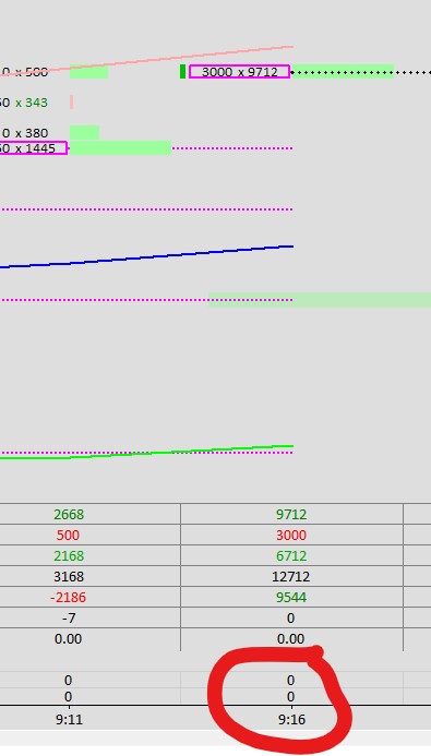

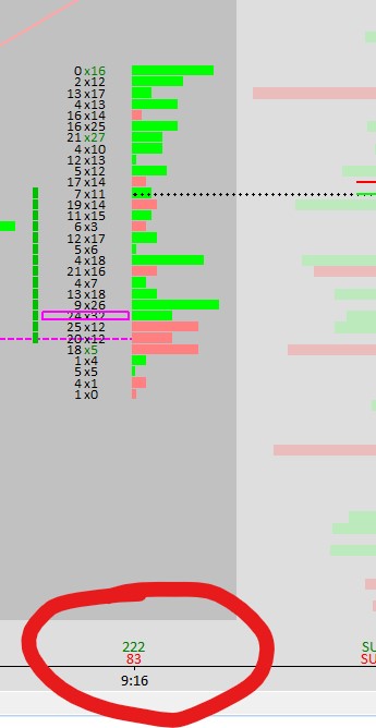

[2023-03-31 13:19:35]
fish4trout - Posts: 99
So I've followed the instructions but just getting 0 values. The data is visible on my futures chart (which is in a different chartbook so copied that chart to my equities chart book). But when I add the study it just shows 0 values.

[2023-03-31 14:02:36]
Zero values for what particular Subgraphs with that study?
[2023-04-03 15:59:07]
Its the bid pull/stack and ask pull/stack from my NQ chart that I'm trying to add to my equities chart. So different chartbook altogether so wondering if that's the issue?
[2023-04-03 17:33:19]
You can not reference the Numbers Bars study between Chartbooks. The two charts have to be in the same Chartbook.
