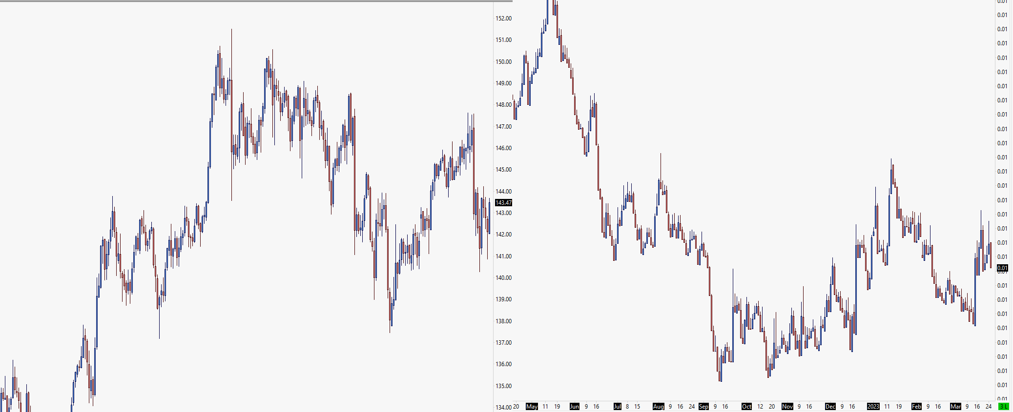

User34124 - Posts: 289
Hi, can this be solved soon? It's such a strange, counter-intuitive problem that just makes the whole platform seem buggy and illogical.
All the wicks on one side of the chart just disappear when you invert any historical chart lol, how has no one else seen this?
Date Time Of Last Edit: 2023-03-27 12:41:00
imagexsafiyax.png / V - Attached On 2023-03-27 12:40:52 UTC - Size: 88.84 KB - 277 views

[2023-03-27 15:25:30]
1) There should not be, of course, hence it is a bug.
2) I could deliver you a few candles' OHLC data from both charts, which is the same as just looking at the issue in the screenshot provided.
3) By your own admission in previous threads it was declared that using anything other than tick-data can cause this error. So you already admitted it's an error.
4) Point 3) granted, how can this be the case with historical charts? By its own nature there is no way to download from tick.

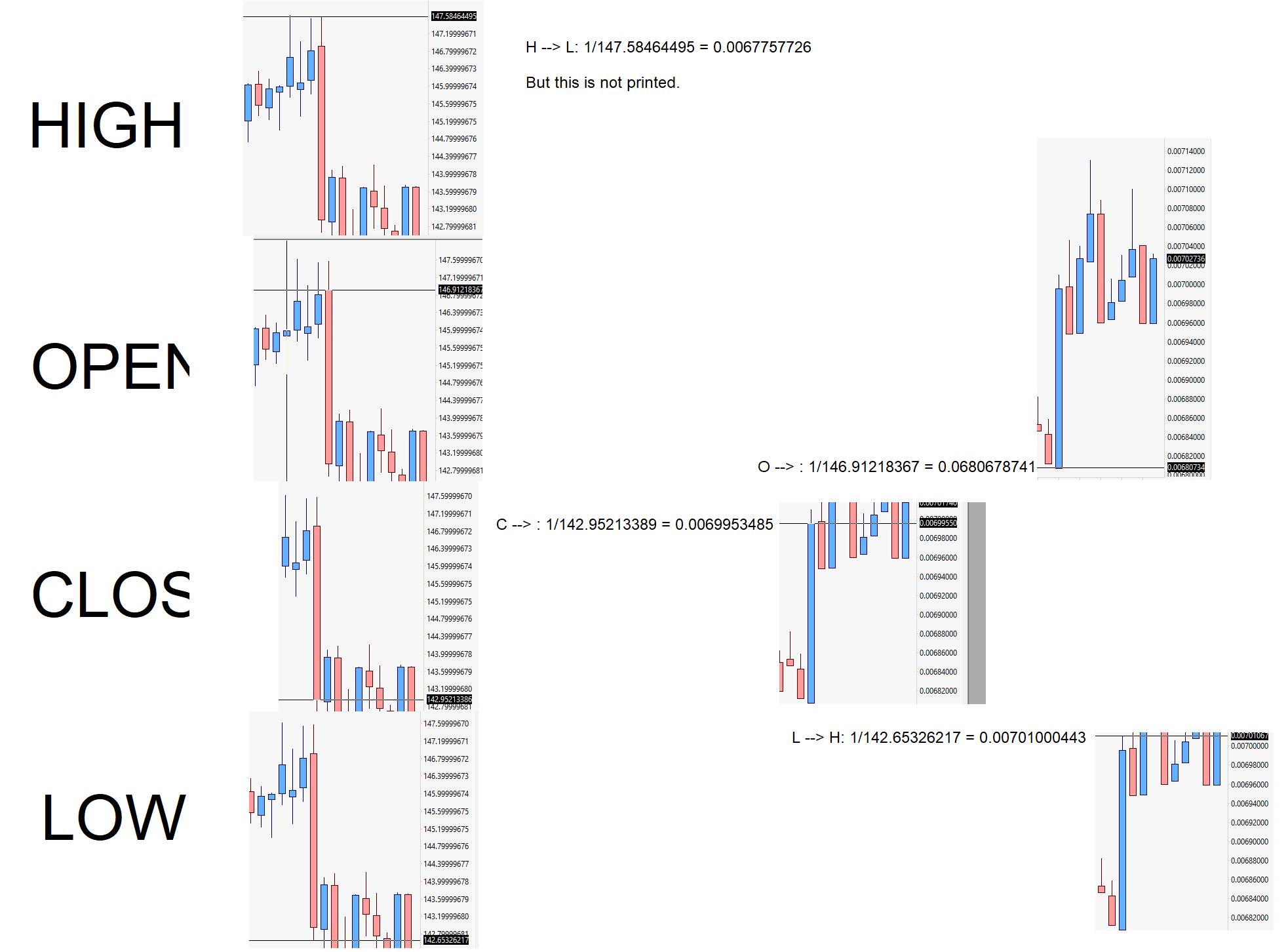

CHFJPY 15 March 2023 Historical D1 candle.
In the screenshot, the candle has been annotated the given 7 times it can be.
Left is the original candle, price values from top to bottom:
H 147.58464495
O 146.91218367
C 142.95213386
L 142.65326217
Corresponding 1.0/prices and display are on the right.
H --> L: 1/147.58464495 = 0.0067757726
^ The above line is completely missing. whereas the below 3 lines are not.
O --> : 1/146.91218367 = 0.0680678741
C --> : 1/142.95213389 = 0.0069953485
L --> H: 1/142.65326217 = 0.00701000443
This inverted high (new low) not printing, is akin to the wick is not printing, hence the obvious bug in my original screenshot.
Alternatively, (or additionally depending on your lust for thoroughness), just update normal chart functions to apply when using the Multiple Bars study.. all it needs to do is recognise a chart with a '-' at the start of the price.
imagesierra.png / V - Attached On 2023-03-28 13:39:31 UTC - Size: 101.6 KB - 285 views
