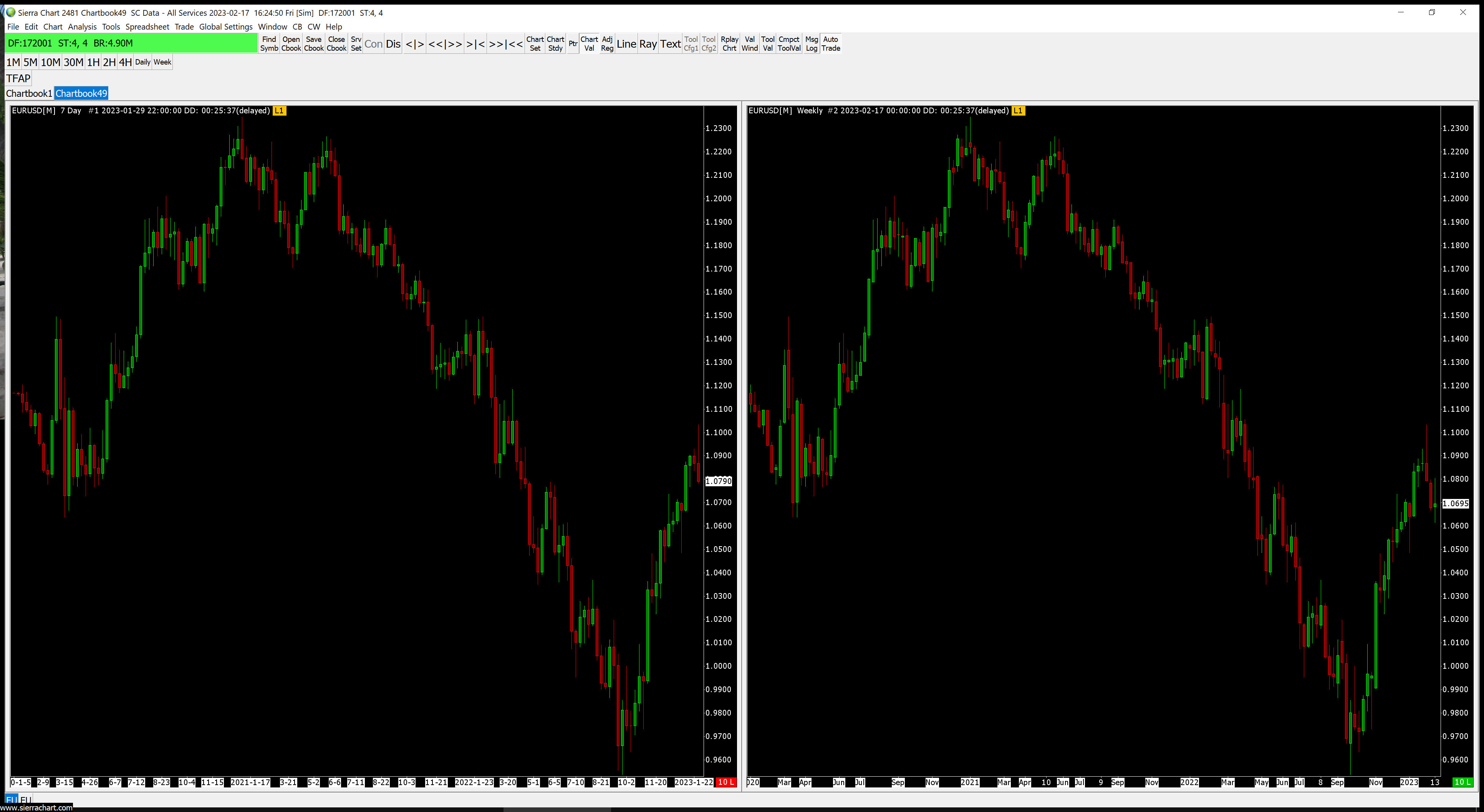

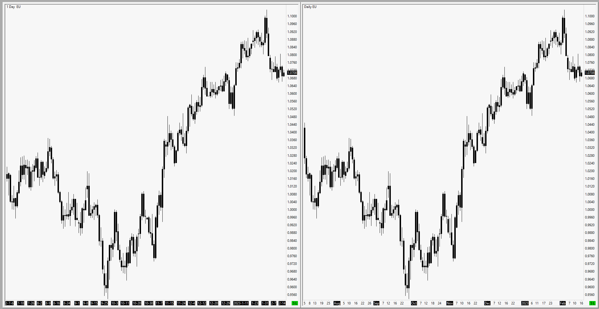

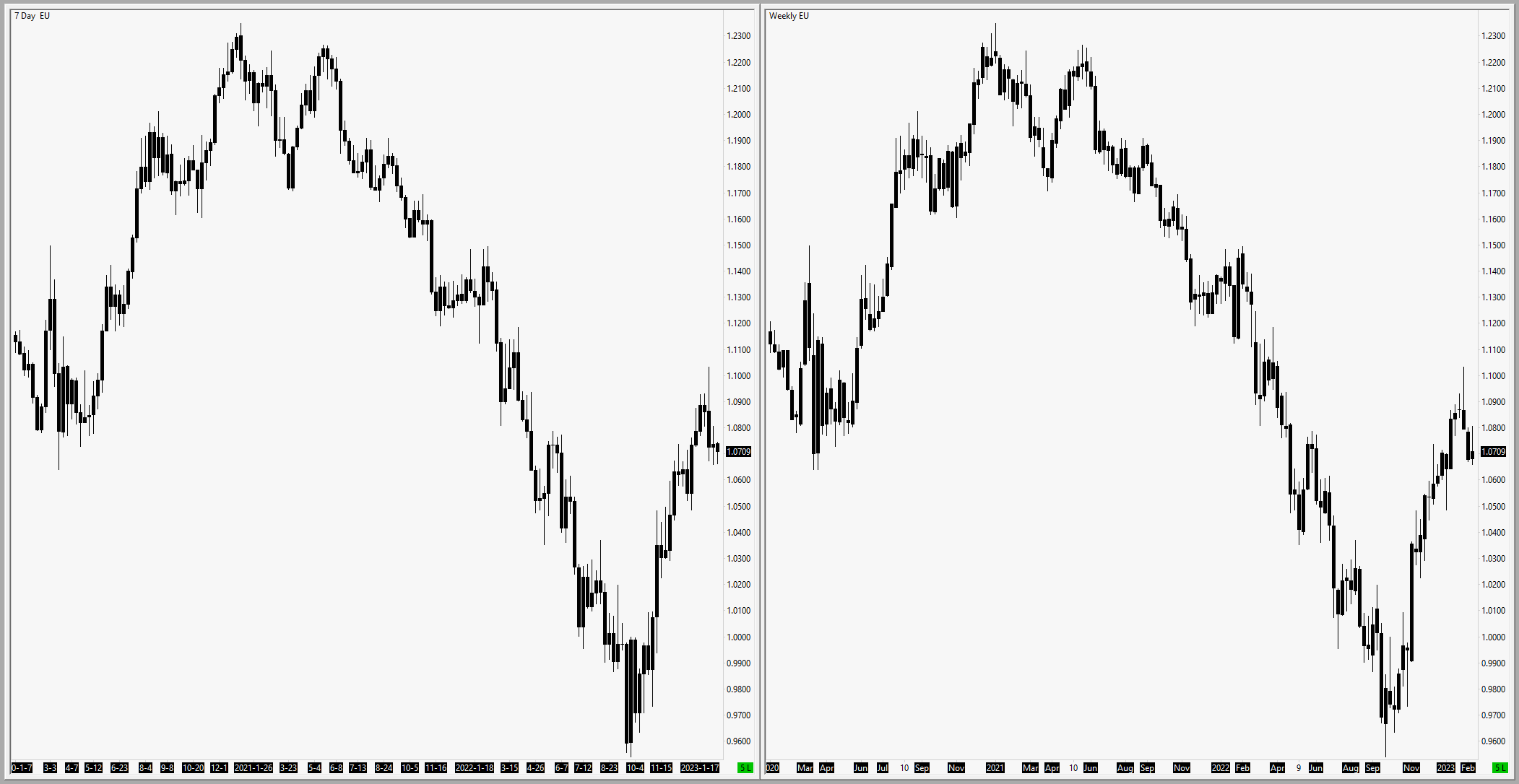

[2023-02-16 10:47:26]
User34124 - Posts: 289
Thanks John, I expounded as the above must not be clear enough. All data is spot-FX, so should not be a need for continous futures.
Intraday 1D vs Historical Daily is fine (fig 1)
Intraday 7D vs Historical Weekly is wrong (fig 2)
Intraday 5D is wrong also.
This doesn't pose a problem until one needs to invert a historical chart. Because historical charts do not invert due to the larger issue raised in this thread, of it not being constructed by tick data.

[2023-02-16 17:19:52]
We are not able to reproduce what you are seeing. Please get us that chartbook so we can take a look by following these instructions:
[2023-02-17 18:58:36]
Thanks, please check
Private File
[2023-02-17 22:25:09]
Your Intraday chart is not set to start on a Sunday. On the Intraday Chart you need to specify the Data Limiting by using the Date Range. and enter a Date Range From that is a Sunday. This way you will get the full weeks worth of trades to match up to the Historical data. The charts will not be exactly the same due to how the exchange report daily versus intraday information, but the general look will be close. The image at the following link is what we see when we get the dates corrected for your chartbook:
https://www.sierrachart.com/image.php?Image=167667269184.png
