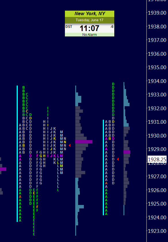

Market Profile does not change the 30 minute letters after the second 30 minute period. See attached file. A period is from 9:30 to 10:00 ET.

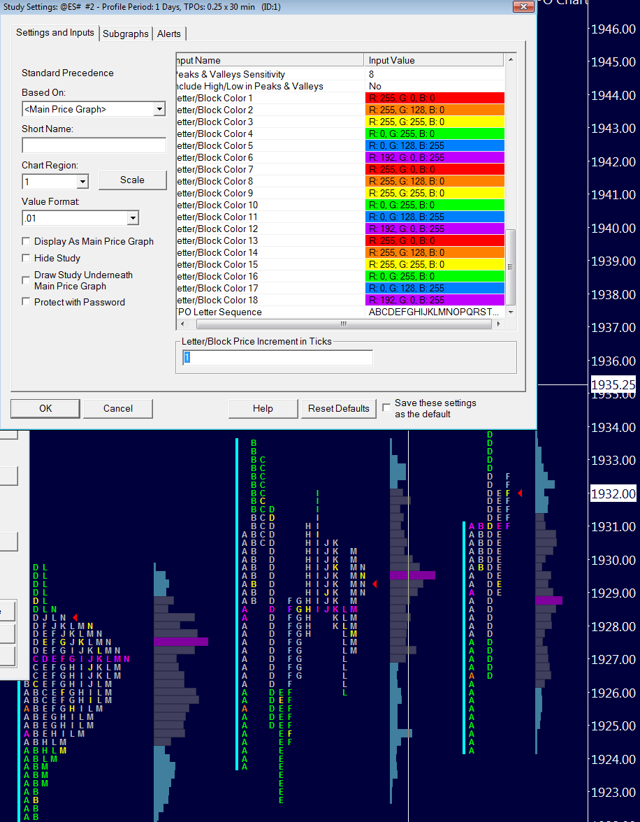

What do you have the TPO Letter Sequence input with the TPO Profile Chart study set to?

The sequence is:
ABCDEFGHIJKLMNOPQRSTUVWXYZabcdefghijklmnopqrstuvwxyz
What is also strange: this error only occurred in today's graph. Yesterday's is correct.

If prior TPO Profiles are not showing this problem, this would indicate a problem with the underlying data.
Right-click before the TPO profiles that do not look correct and select Delete and Download Data.
If that does not work, then open a new chart for the symbol and look at the bars and see if there any repeating or out of order times at the bottom.
